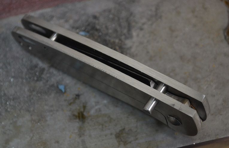

:D Here's the dowel pin in for alignment

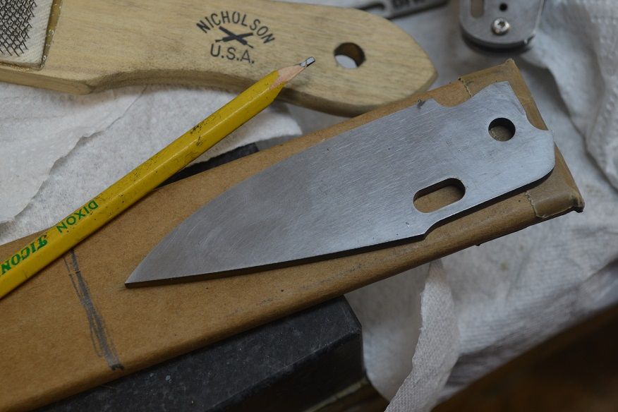

I also put in the pressed stop pin and drilled/tapped the holes for the clip. That's a temporary blade for now... I do that because before heat treat I only ream my pivot hole to .249" and the blades do not fit on the pivot for fitting, etc... the pivot holes get lapped with 600 grit Clover Compound on a brass lap post heat treat for the tightest and smoothest fit.
I've been practicing my milling for the blade and backspacer work... glad I did because I realize I need a new round end mill!

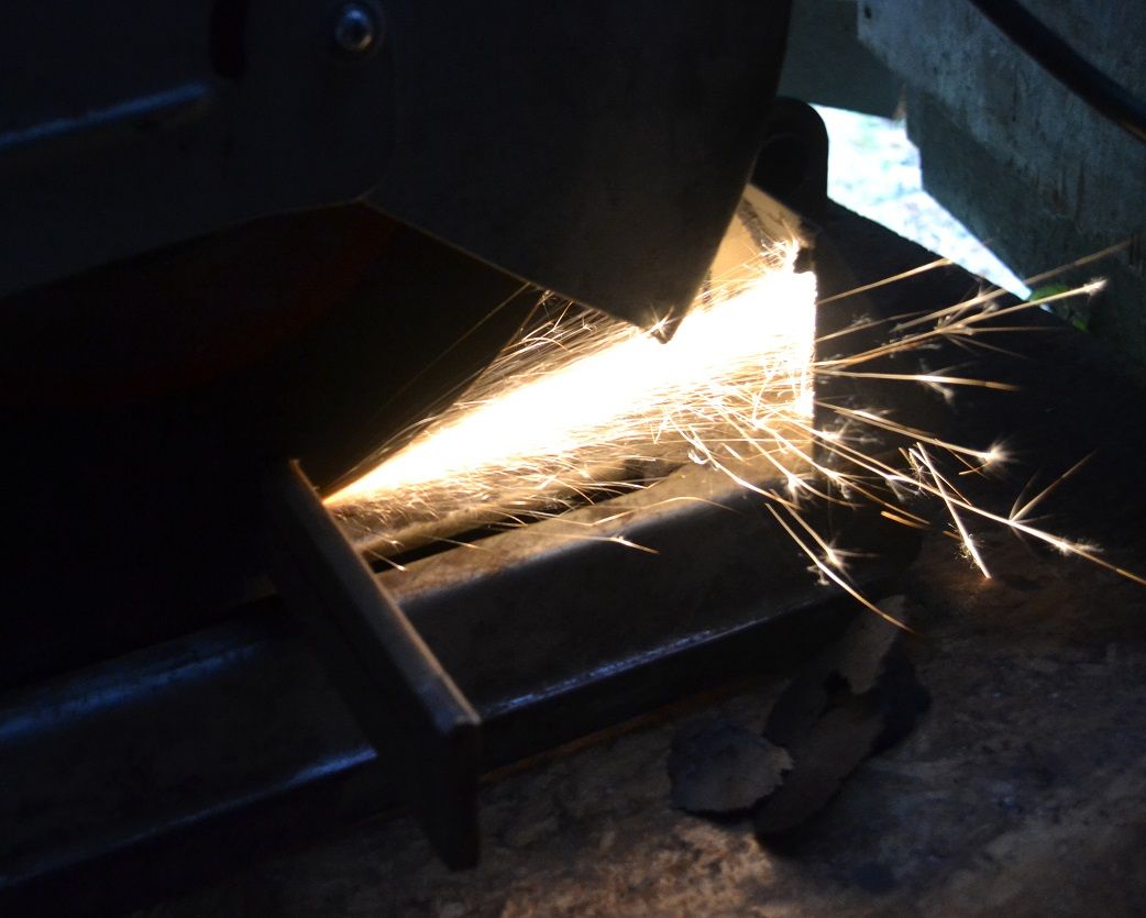

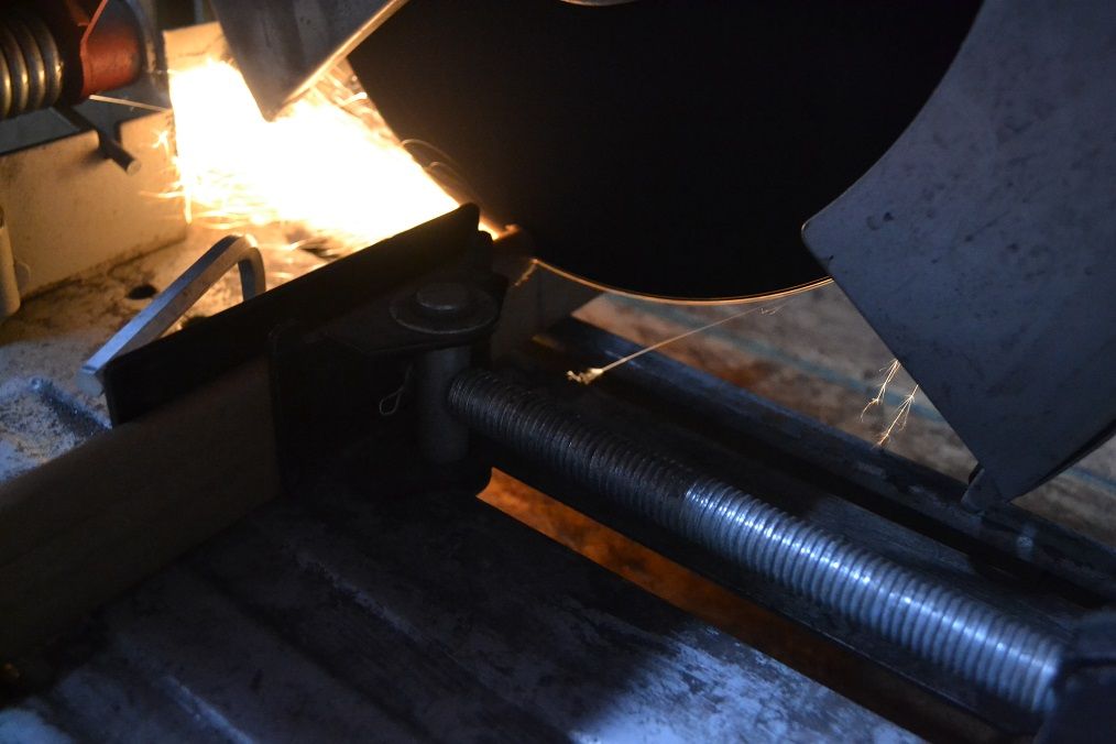

I marked off a generous portion.
Chop time!
