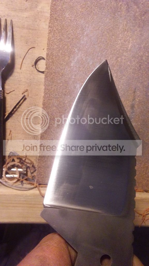

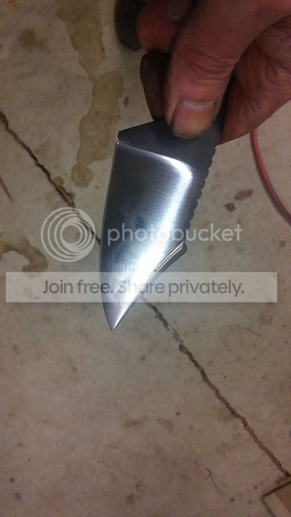

I get this effect on 1075 a decent amount, which is why I quit using 1075. I've never had it happen to w2 before. It looks like a real bad hand sanding job or smears thru the hamon. Is it alloy banding? Is there a way to avoid it? Really sucks after all the work and it's a custom order.
It's Aldo's .20" w2 and was stock removal and thermal cycled four times starting at 1,600°F. It does kinda look like bad hand sanding, but I have yet to hand sand it and you can see it is a belt finish. A30 gator, actually. And it can't be decarb, I ground from .10" down to .01" Plus you can see this kind of stuff in the steel while grinding before heat treat especially on 1075 or 5160.
Who knows what it is and how to fix/avoid it? Thanks for your wisdom!

I brought it up to temp then soaked for 10 minutes at 1460°. I'm hoping it turns out, but I've seen this before and am not optimistic.

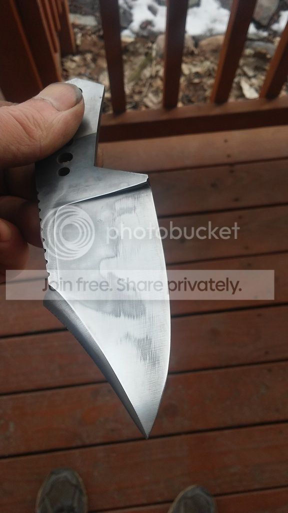

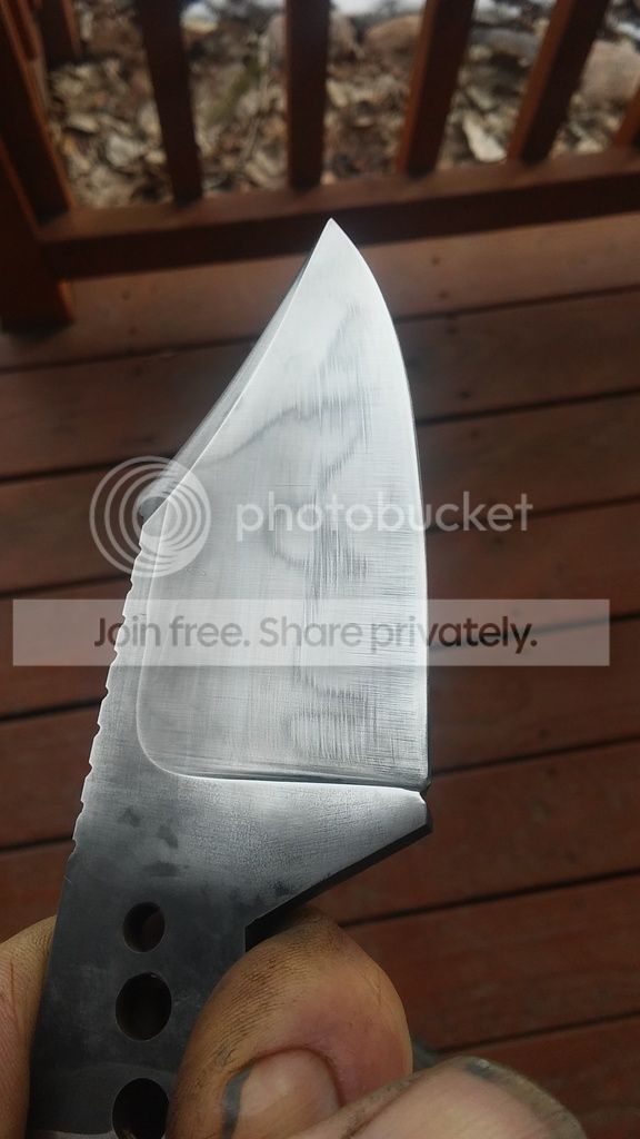

Here are a couple pics after a ferric etch, pretty ugly!
I don't think any amount of sanding/etching will help this. I've gotten this on 1075 before and spent a billion hours trying to clean it up. I've even tried unsuccessfully to grind it out.....Probably a wasted blade....might do a stone wash and sell at massive discount as it performs well!
I would like to know what I'm doing wrong and how to avoid this. All the other blades from the same bar turned out great!

That's not alloy banding, that is caused by not getting all the black oxide off after each etch.
Basically you are etching that pattern onto the blade.

Mr. Hanson, it's in there fresh off the grinder before any etches.

If you are thermal cycling, excess time at low temps or too many low temp cycles (below normalizing temps) will cause this. I spoke with Kevin Cashen a few years ago about something similar that seemed to follow sanding or grinding marks, and he commented that deformation of the grain structure during grinding can show up during etching, based on the carbide and alloy precipitation during heat treat. (I hope I got that correct.) you would have to grind past the original grind marks and deformations to get away from that. I now leave 0.020" extra on each side when I heat treat, to grind clean to fresh steel and I haven't had that problem since.
