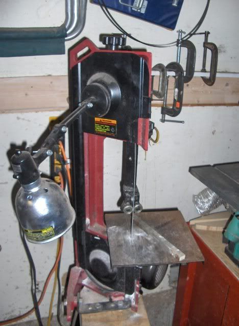

Just to explain the numbers on a horizontal/vertical band saw for those who don't know:
The two numbers are actually the clearances measurements. If you look at the photo of Patrick's saw ( to help you visualize) and draw an imaginary line straight back from the blade ( the cut line) it will pass the frame by 4 inches. If you now draw a line perpendicular to the blade's cut line at the front of the blade, you will measure back to the frame and find it is 6 inches. Thus the clearances are 4X6 inches....the saw is referred to as a 4X6. This means that the widest strip you can cut off is 4", and the widest bar you can cut into lengths is 6". You can feed any size sheet ,or cut any length bar, but the 4" strip and 6" depth of cut limits will control the size of the pieces you cut off.
For cutting out profile shapes, you often have these 4X6 limitations show up by the sheet shock running into the frame, and preventing a cut from going any farther. If you mark the profile on your sheet from a template ( a highly recommended practice), you can mark both sides of the sheet. When you bump into the frame, flip the sheet over and cut from the other side. this usually allows the clearance needed. It takes some planning when cutting multiple blades out of a wider sheet, but most obstacles can be gotten around.
For knife making purposes, the horizontal use of the saw is mostly for cutting slices to stack up into damascus billets, or for cutting large round stock into forgable pieces.The vertical use is when we use the saw 99% of the time. Most makers permanently mount the arm of the saw and discard the base and clamps. By doing this you can make a sturdier table than the piece of tin they shipped with the saw, and mount the assembly on the workbench where the table is at a better height for cutting out blades. If you find you need to make a lot of horizontal cuts in your shop, perhaps two saws is the best way to go.
Whatever type of saw you use, be it a high tension hand saw ( hack saw) or a hydraulic dampered 7X12 with oil cooling and 15 speeds....the blade is what cuts, not the saw assembly. Get a really good Bi-metal blade. The Lenox blades sold by the knife supply companies fit the HF saws and most other 4X6 units. They will last longer and cut better. The approx $30 cost is much more than the cheap HF blades and Sears blades, but a good Bi-metal blade will out last them by many times. If you are working in stainless, the Bi-metal blades are a must.

Not to throw cold water on the argument, but I thought it was 4" long by 6" high? Meaning you could rip a 6" high board 4" deep. I can assure you that you can't cut a 4" wide piece past the housing.
Here's a picture explaining it. As you can see, 4" deep 4.5" high, roughly 2" wide. Most knives are less than 2" wide, so not a problem for ripping stock. Some cuts need to be double ended though when doing curves. However, the wheel is 6.5" diameter, maybe that's it.
I have a double light switch wired to an outlet for my grinder, so I will just hook it up to the other outlet and have the second switch as the switch when I mount it. I am in the Halifax area, I have some relatives in New Glasgow and stellerton but thats as close as they get.
edit: hehe just flashed up the portaband.. cuts pretty slick. Light pressure on 1/8 O1 and it was just gliding right through it. I think once this is set up as an upright (after I check out the portaband threads on how to rig it up) I can cut out some more blades!! efficiency, what a wonder.:D

The clearance for cutting stock on the HF saw is 4", not 2".
