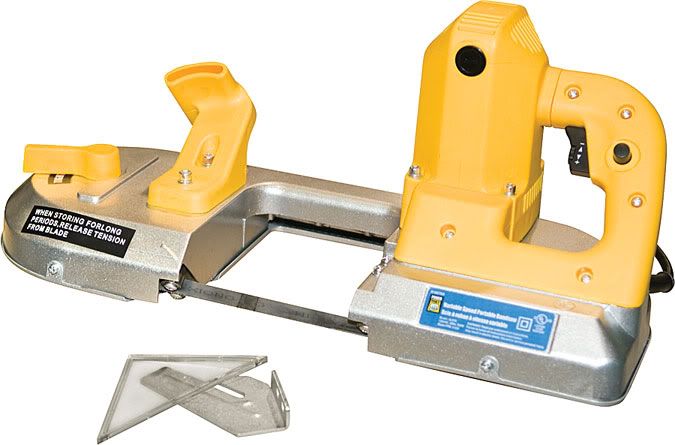

This is the one that I got
It is a hand held with no base so there is no locking it in an upright position:(
In time better tools will come but for the volume I do this will keep me covered and save some wear and tear on my arms
You make the cutting table and base out of wood and/or metal, and bolt/clamp the porta-band in it. There are several shown in the threads on mounting a porta-band saw..
I have some scrap mild steel laying around that I will be making the mount out of. I was wondering what to use the cutting table out of, I was thinking a piece of aluminum but the wood idea is cheaper and I can always glue a piece of counter top laminate to it to give me a smooth cleanable surface.
Unky, if you look at mine, it's similar to your plan. Consider putting a post at the handle, also, I used the bolt through the handle right behind the trigger. Just a little added stability since you will be putting a fair bit of torque on the saw. I used a piece of 10"x10"x1" steel plate. Most steel supply shops have a fair number of square plates laying around and can be had pretty cheaply. For a more solid mounting, keep the three point base and drill 3-4 holes in the base at the corners. Drill matching holes on your bench and bolt it down with wing nuts. Then, you can easily remove it if you want to take it somewhere.
Don't forget the hearing protection, these things are horribly loud.
Now, if you figure out a more solid work surface, let us know. The dewalts have nice aftermarket ones, but I haven't found one for the HF.
The Princess Auto one that I have is fairly quiet, but it isn't as power full as the HF one so that could be the noise difference. I got the idea for my stand from yours, I just don't want to modify the saw in any way so that if it craps out I can return it for a new one. We do have a metal supremarket here in Winnipeg I will have to go see if they have any thing I could use as a table for the saw that is sturdy enough.
Not sure about the PA model, but on the HF you can easily remove the bolt behind the trigger without modifying it. You will need to use a longer bolt, though.
Wish mine was quieter. Everyone on the street knows when I'm cutting!
The only difference I can find between the two is that the Harbor Freight model is 700 watts and the Princess Auto model is 500 watts. That is a picture of the PA one that I posted and the HF one looks identical to it so that power rating could just be a difference in how Canada and the USA measure things
If it turns out that the US and Canada measure wattage differently, I'm moving to Europe.
I don't think they do, I was making a joke but the HF unit runs with just shy of 1HP 700w=.94 hp electric while the PA unit is .67 hp electric I would say the that is the cause of the noise difference, just over 1/4 horse power should make some noise. there may be material and construction differences too that make a difference.
