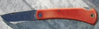

Ok. After thinking on it some more, I went out and took a picture of it. On second look it isn't as faded as I said in my OP but it is well on it's way.
The day it went on the roof - 15 Nov 2015: Nice and bright and really, really, red.
Today - 23 Nov 2015: Fading fast and dull, dull, dull. NOTE: - 24 Nov 2015 - Edited picture to turn it to a horizontal position and to magnify it to more clearly show the affects (or is it effects) of the weathering.
Rust is forming nicely on the lock back release lever and there are a few specks on the blade. Coming along nicely.
So - you bought a brand new knife just to leave it out in the weather for a month to see what would happen to it?
Wow, that's pretty faded for such a short time! I would guess that the material is dyed before it is made into micarta, but I really don't know. Question, is it as faded on the pile side as the mark side? Wondering if it's an effect of UV or weather, maybe a combo of both.
Seconded, UV rays and sun can do quite a bit to natural materials in washing them out.

Ive always thought micarta to be a bit like fibreglass.
material eg a layer of natural canvas or say blue denim for instance is what gives it the colour. The resin is clear.
remember a while back there was talk of a fire hose micarta handled #73? the idea kind of died sadly. One of the members made some .It was the the old hose that gave the micarta its colour. It wasn't dyed.
So as a control experiment leave a piece of whatever material the micarta is laid up from on the wood shed and see what happens.
I'm certain that if I left an old pair of blue jeans on the roof of my shed they would be faded almost white within a month. Not only that the denim would be all crackly and broken down.
I could be totally off the mark .

The most common resins to use for Micarta are epoxy or phenolic. It is possible to dye plastics based on epoxy and phenolic. But it is more likely that colorants were added to the resin prior to processing it into Micarta.
Re: fading.
Neither epoxy nor phenolic has good resistance to UV. UV attacks the surface and causes the resin to break down.
Whether they added color before or after making the micarta, most red colorants are not very resistant to UV either.
