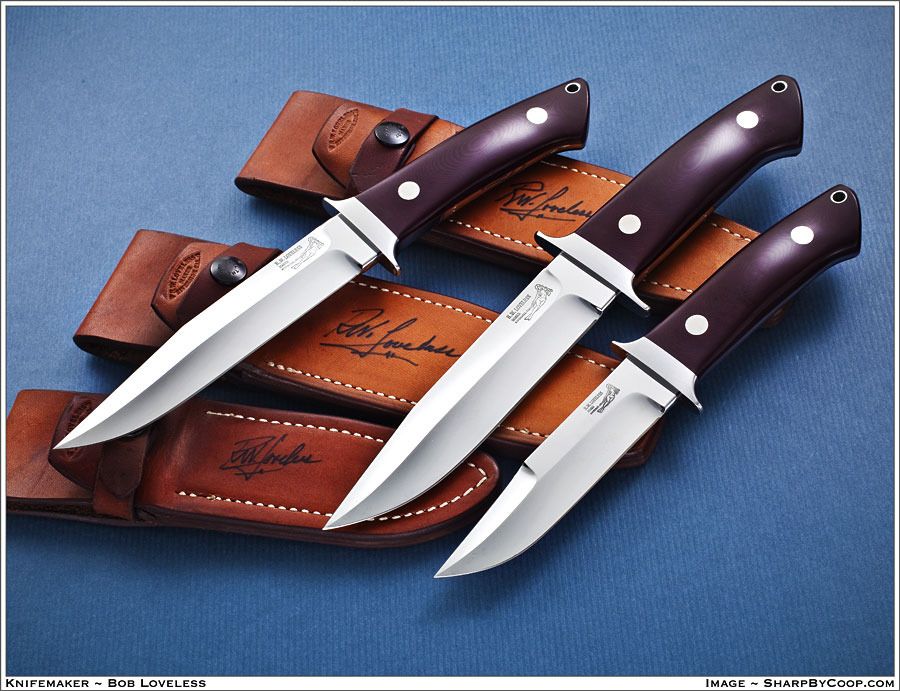

In the unusual circumstance where I seek out other than natural materials, I've always preferred to stick to vintage micarta. If I'm not going to use such a knife, then I sure as hell want it to look it's best, which micarta does, IMHO, way more than G-10. Some recent examples of Carothers/Arnold field knives in vintage micarta:
you're amassing quite the Carothers collection there, Bob! Looking forward to adding another piece or two to it :)
I think that G-10 finishes more cleanly than Micarta does, meaning that with the knives I've seen and held, the G-10 cuts cleaner than Micarta. If you polish them out more, then the texture seems similar, but I agree with the above comment about the Micarta being more warm and having more of a soul. I think that , at least with linen Micarta, if you looked under a higher magnification you'd find many small "hairs" that give it that softer feel, as opposed to G-10.Canvas Micarta not so much.
Those top two are awesome. Really like the butterscotch.
