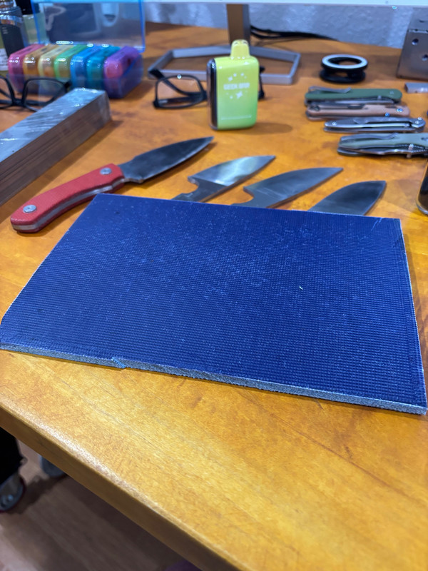

Thank you! I have a soft spot for micarta handles and scales, and I never would have thought these were sand blasted. But it makes sense for large productions. So, for my first knife, I order up a variety of "micarta" and they all are slicker than owl.... well, you know the rest. I sanded over the edges to round them over with 220, and that is still really smooth to the touch. Maybe need to go lower.

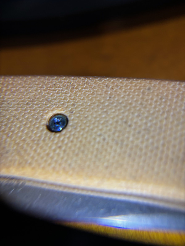

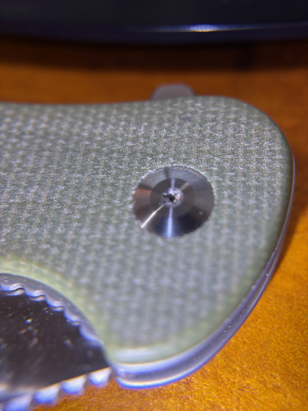

So I broke out the magnifying glass, and took a snapshot of a couple of the micarta knives I have. Custom scales on a bugout and a Civivi. the Civivi is smoother. The Bugout scales look like some sort of machined process, but not a blasting.
Anyways, sorry for being so anal about this. Just very curious.
I heard back from the custom scales maker and they said it is sand blasting. That's pretty impressive.
It seems a little more apparent that they were blasted when you zoom in above the pivot on the bottom picture.
