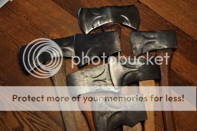

I was just reading through some old threads from 2014 about phantom bevels and was admiring this photo posted by double ott of his Kelly Perfect axes.. In looking at the Jersey pattern shape vs. the Michigan pattern it got me thinking what is the major difference in the results the heads produce? I understand the Jersey has those lugs which hold the head onto the haft more securely and a longer bit so what tasks can this head preform better at than the Michigan? And vise versa there must be a job it is less suited for than the Michigan is?
Just some things I am thinking about as I have never seen/used both side by side.
I am wondering if I am getting confused here are the 2 single bits facing the left hand side Dayton's and the one single bit looking right is a Michigan? I only say that because their 2 poles look well squared off compared to the other one?
Also the rounded pole over the squared off pole? Is this purely stylistic or serves to support its overall intended purpose of use?
S Square_peg replied that in my thread, about the same subject:
Jerseys and Connecticuts have wide bits that make it easier to to overlap your strikes in bucking work. But the wide bit may not penetrate as deeply into a hardwood. It's a give and take.
The rounded poll of the Michigan is more forgiving when you strike a felling wedge with the corner of the poll. The sharper cornered Dayton pattern will indent the wedge more. And I'm talking about wooden or modern plastic wedges. Metal wedges should never be struck with an axe unless the axe is designed for that work and has a hardened poll and a heavy eye.

I can tell you right now that most michigans I see are fairly heavy with very round cheeks so they'd be pretty good with splitting, other than that idk, never swung an old Michigan. I do have one I need to get to
Pound for pound a Michigan will be a little better splitter. But watch out for the newer ones with flat cheeks. While Mann owned Collins they made a ton of these and most American made Collins you find these days fall into this group - those Collins Homesteads with the blue sticker with the big 'C'.
The Jersey will generally be a better bucker, wider, thinner but still convex enough to pop the chip.
And these are all subtle differences. It's really more about what pleases your eye.
When doing any job with sufficient frequency, intensity, or duration, small differences add up to make big differences. You won't find much difference between the two in most cases if doing a single small job, but if using it often, intensely, or for extended periods of continuous work you'll find you prefer one preferable to the other.

I may be wrong, but I thought the Michigan pattern was made for cutting frozen hardwoods. The rounded corners of the toe and heel are much stronger than pointed ones and less likely to snap off.
Having damaged a few axes in hardwoods I would think a frozen sugar maple would be a heck of a challenge. I have looked for historic footage of them being axe felled but have not found one yet. The amount of salvaged maple logs being pulled up from the great lakes says they harvested plenty of them though.
