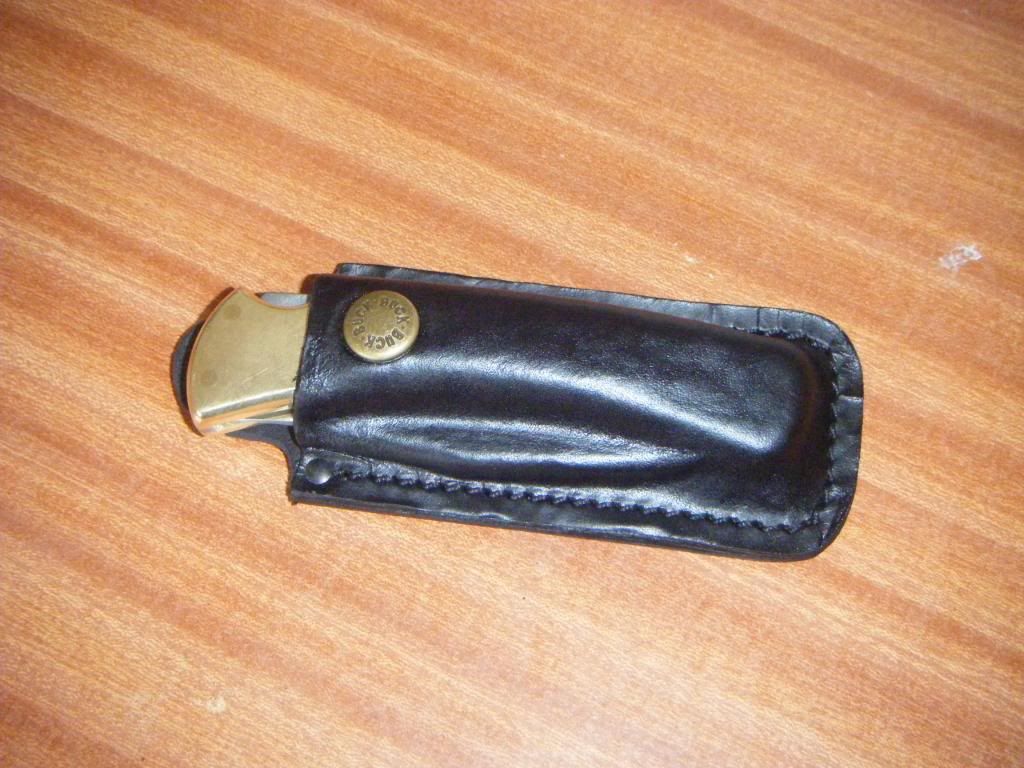

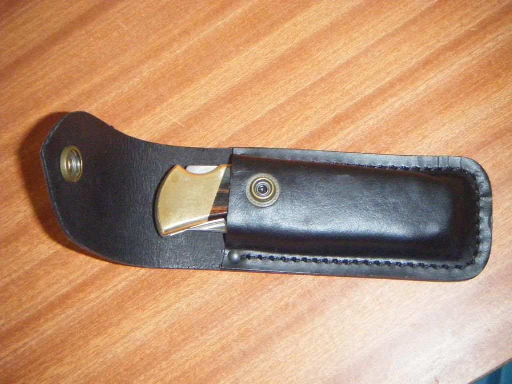

What I did with mine when I was really into them and wanted to carry them everywhere was to modify a Buck 110 sheath. It statred like this,
and ended like this..
my Svord fit good into this but I fought with it after disposing of my faulty 110's and decided to cut a hole in the bottom of the sheath for the tang to fit through, leaving the body of the knife almost identically in the wet forming of the 110 model knife.
With simple cuts, snips and modifications, even a lengthy tanged friction folder can be modestly carried on the belt!
