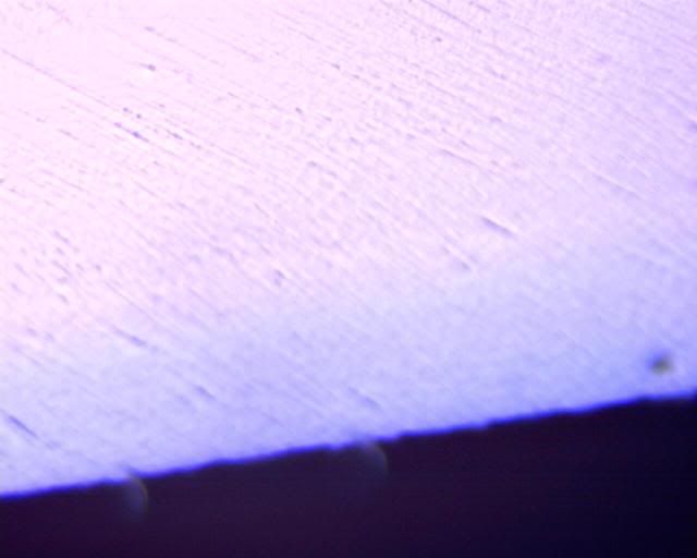

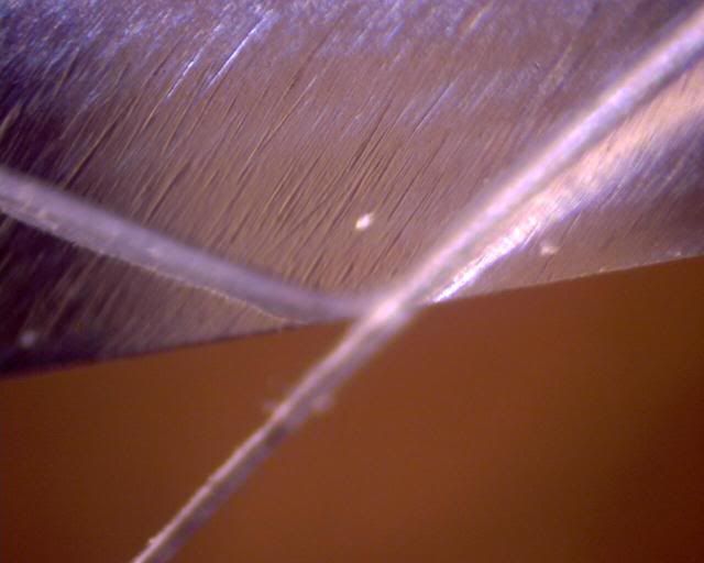

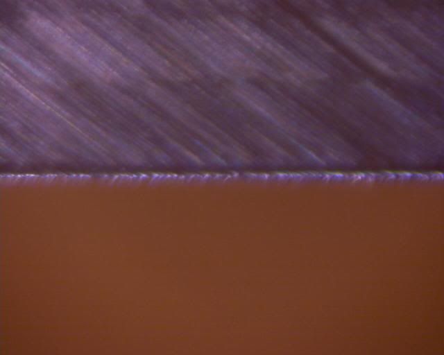

Here are some pictures of un-stropped edges.
(This will probably be in mobile version so if anyone would like to convert them for me I would be grateful)
This first photo is ZDP-189 finished on a DMT EEF 8000 mesh diamond stone.

This next photo is a Richmond addict CPM-154 finished on a 6k Arashiyama waterstone.
http://m284.photobucket.com/albumview/albums/knifenut1013/macro pics/PIC044.jpg.html?o=52
And lastly, this is a edge with a burr.
http://m284.photobucket.com/albumview/albums/knifenut1013/macro pics/PIC086.jpg.html?o=10
