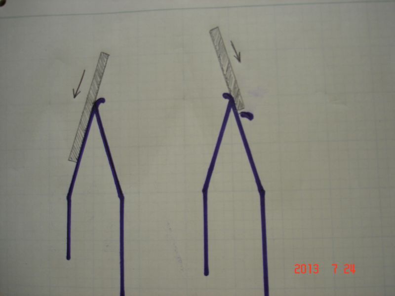

The problem with this discussion is that we talk as though we’re flipping the burr back and forth. Actually, we’re cutting off the old burr while creating a new burr on the other side (right side diagram). It seems as though the burr is being flipped, but it’s actually a new burr. And it’s a new burr whether we increase the angle (to create a microbevel) or keep the sharpening angle the same.
Anytime a stone is scraped across the apex of a steel edge, a burr will form on the opposite side of the edge (left side diagram). The size of the burr depends on the coarseness of the stone and the pressure we put on that stone (and the type and hardness of the steel).
A microbevel creates its own new burr. The way to remove the burr is to decrease pressure on the stone and progress to finer and finer grits. A final stropping with 0.5 micron paste will remove any meaningful portion of the burr that is left .

A burr is debris from the side being ground, it does flip or break off as sometimes described but is re-created by new grinding which crosses the apex. The only way to "remove" the burr is to not create one.

It is entirely possible to "flip" a burr, it can be done on hardwood or on any other sufficiently hard surface. Much of the time we forget that our stones aren't just abrasive, they are quite hard by most standards, more than hard enough to manipulate a very thin piece of unsupported steel. I have no doubt the burr can be recreated on the opposite side an instant after its been eliminated. But IMHO, in most cases when a burr seems to "flip" side to side its because that's exactly what's happening.
A burr can be flipped on a hard strop, lapping board, edge of a cutting board, surface a smooth granite countertop, piece of glass - in short, on all manner of surfaces that lack abrasive potential to create one in the first place. The burr isn't created on one side of the bevel, its created at the apex even if it starts out leaning to one side. Once there, there is nothing keeping it from flopping about on its attachment point.
Of course all the usual disclaimers re burr formation on high RC steels and other factors still apply.
The burr has to be worked off with enough pressure to allow the abrasive to do its job, but less than it takes to flip it - if there is some factor more proven than this I cannot imagine what it is.
Coming at it from a steeper angle such as when microbevelling, whether for a finishing technique or to reduce a larger burr in the course of creating a single bevel cutting edge, will cause more of it to be caught by the abrasive. One can also backdrag the edge along hardwood or similar and this will in turn, stand the burr up. Essentially changing the angle of the burr on the abrasive surface, rather than changing the angle of the apex to the abrasive surface. All these approaches do is allow increased pressure to be used so the burr gets dragged under the apex and ground off easier - they reduce the likelihood of the burr being pushed over the apex. Removal can still be done at the base formation angle as long as light pressure is used with an appropriate abrasive - takes a small increase in observation and grind time.

Even with light pressure, if one continuously works one side of a bevel on a stone, a burr will form. The way to remove it is to treat it as a separate part of the cutting edge and grind it off in detail. This is why I'm a big proponent of sharpening the blade in sections if necessary - there may or may not be a burr along the entire length.

Again, this is an oversimplification. There are two forces at work, abrasive and pressure. Pressure alone isn't going to remove a burr, and neither is abrasive potential, the two forces have to balance. Yes one could grind away indefinitely, and steel will continue to be removed, and some steel will fall away. Depending on the steel, that burr could get huge without letting loose. The entire thing just doesn't just fall off at the first indication of abrasive pressure, the attachment point is flexible. The burr has to be removed with intent. Imagine a large burr being ground from the opposite side. At what point in a stroke did the entire burr fall off to be replaced with a new, fresh one, of the same approximate dimensions? If you timed it perfectly you could cultivate a wire edge - that's not the same as tearing one off and replacing it. How exactly do you think an abrasive particle removes metal?
And not all burrs are extremely weak, only very small ones or ones that have been flipped repeatedly. Some burrs survive all manner of abuse. Furniture finishers use burnishing cards that have a deliberately formed burr, that thing isn't falling off on cork or felt.
In my Wicked Edge, I can raise a burr on both sides of the blade using the coarse stone. After I've developed a burr on the right side of the blade, I can switch my coarse stone to that side and with a few strokes, the burr will show up on the other side.
But instead of using the coarse stone, I can switch to a fine-grit stone and use very light pressure, with the same number of strokes. The burr is gone.
So if the burr is just being flipped from one side to the other, how come I can completely cut the burr off with a fine stone, using light pressure, but it doesn't get cut off with the coarse stone using normal pressure?
The answer is that the burr gets cut off both times, but with very light pressure and a fine stone, it doesn't get recreated on the other side of the edge, as it does with the coarse stone.

What's happening is that you're applying enough pressure to let the abrasive do its job, but not enough pressure to flip the burr. You could do the same thing with a coarse stone but likewise takes lighter pressure, also takes more frequent observation to avoid raising a new one and to eliminate it at different points along the edge. Try your example again, only use "normal" pressure with the fine stone. With a few passes the burr would flip, yet how could a fine hone possibly eliminate a coarse burr and create another largish one with only a couple of passes. I'm not disputing what you're seeing here, the burr can be ground off in place - that's the most reliable way to remove them, and that's exactly what I've been saying all along. But it doesn't happen haphazardly, or as an automatic response to pressure and abrasive action. If that were the case, you could use your coarse stone to raise a burr, switch to the other side, and using the same "normal" pressure that reliable eliminates and recreates it with a few strokes on the other side (or even more pressure), stop at half or quarter the number of strokes and the burr would be gone. Heck, why not bear down and only move the edge an inch or so on the stone?
Instead I think you'll find it stands up, aligns with the midpoint, and gets pushed over. Some of it will go, much will remain. Until you reduce pressure to the point where it stays put, but within the range needed for the abrasive to work efficiently, that burr will simply heave over.
