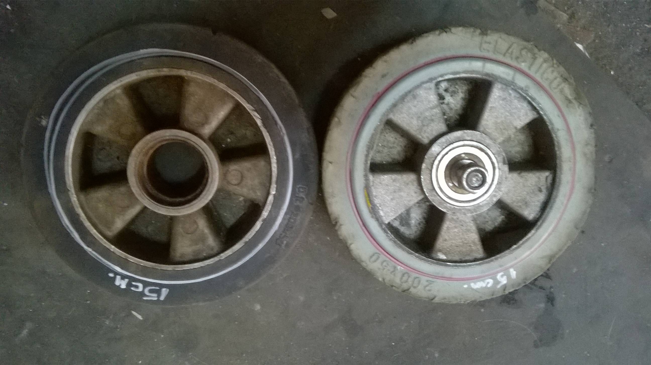

Ok I tried to do a search and did not get an answer so here is the question. There are some really nice looking CASTER WHEELS , all kind of sizes, hubs aluminum or composite, different types of coatings. Why are they not good for a contact wheel ? Even if not perfectly round , if they were trued up with a lathe and high speed bearing installed would they be as good as whats out there ? A lot less money. I know I am just digging too deep into some of these things. Thank you for your response and input.
Well if you are dead set on wasting time and effort to make a Sketchy Wheel a better wheel the only question remaining is would you rather do that or make knives?
My take on it is...I want to make knives...With what I have spent on equipment and materials over the years I could have purchased a HUGE collection of Beautiful Customs. I chose to buy GOOD WHEELS no truing , no balancing, bolt 'em on good to go.
All the casters I've seen are rock hard urethane. Even if you got it trued up and balanced, it would still be a poor contact wheel.
Proper vulcanized rubber contact wheels (Bader, CRC, ect) are well worth the cost in my opinion.

Biggest problem would likely be balance/smoothness at higher speeds, followed by hardness and durability of the coating. There's a chance it COULD be around a 60-70 durometer urethane coating, but then there's also the issue of width, and then mounting it to some bearings that would take the RPMs of a grinder for more than 5 minutes. For the time and effort it'd take to balance one, install proper bearings, and still maybe not have a decent covering, the wheels from china, or even sunray start looking a lot more reasonable in price.

For the wheels you show, put them in freezer overnight, then chuck up in your lathe and true up the surface so it's nice 'n round, and even along the edges. Then true up the holds for your bearings, press bearings in. Check for balance by hand turning on the axle to check if there are any heavy spots (always stopping on bottom). If so, drill a small dimple at that point until the wheel always stops at a random place.
Those wheels could work nicely. If they do, GREAT!!! if for some reason they don't work so well, no big deal, only thing you've lost is some time. "IF" you're making knives full time, then time is money and it might be less expensive to just buy a decent wheel, but hobby knife making (like me), time is pretty cheap {g}

At least from the picture, those look like lawnmower or barbecue wheels to me. If so I'd personally be rather reluctant to run them at the speed of a contact wheel. If you do try it, at least stand to the side when you turn it on, and let it run a good 10-15 minutes at full speed before you try grinding.

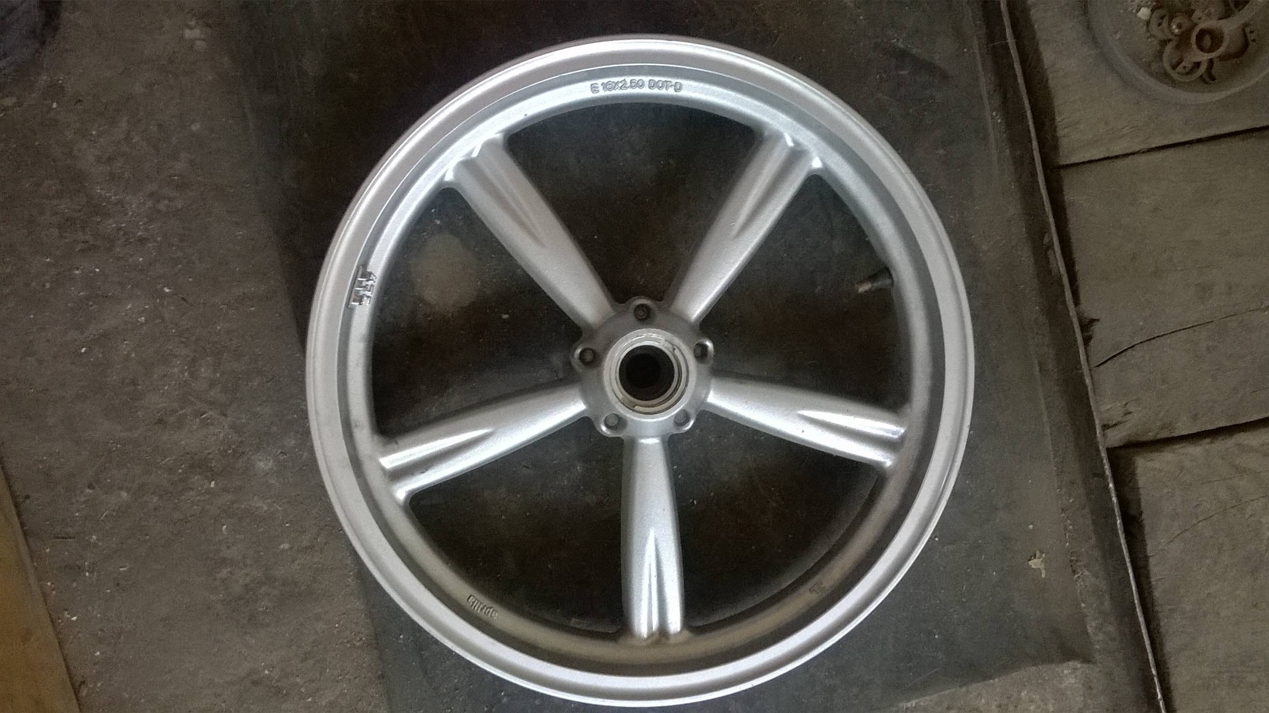

Exactly that I intend to do . If rubber/urethane is not good I will send them to be vulcanized with rubber . Only problem is that I have no idea what is soft to much , what is hard to much.... first contact for me with this kind of tool . Balancing big bike wheel is part of my job :)Look , if you know what are you doing and how part you make should work , it s easy to do . This is 16 inch front bike wheel , next week I hope I will turn on lathe and send in specialized shop to be vulcanized with rubber ...I need this big contact wheel because I m half a way in finishing first ever made CNC /4 axis/ jig for grinding knive on belt grinder ;)
