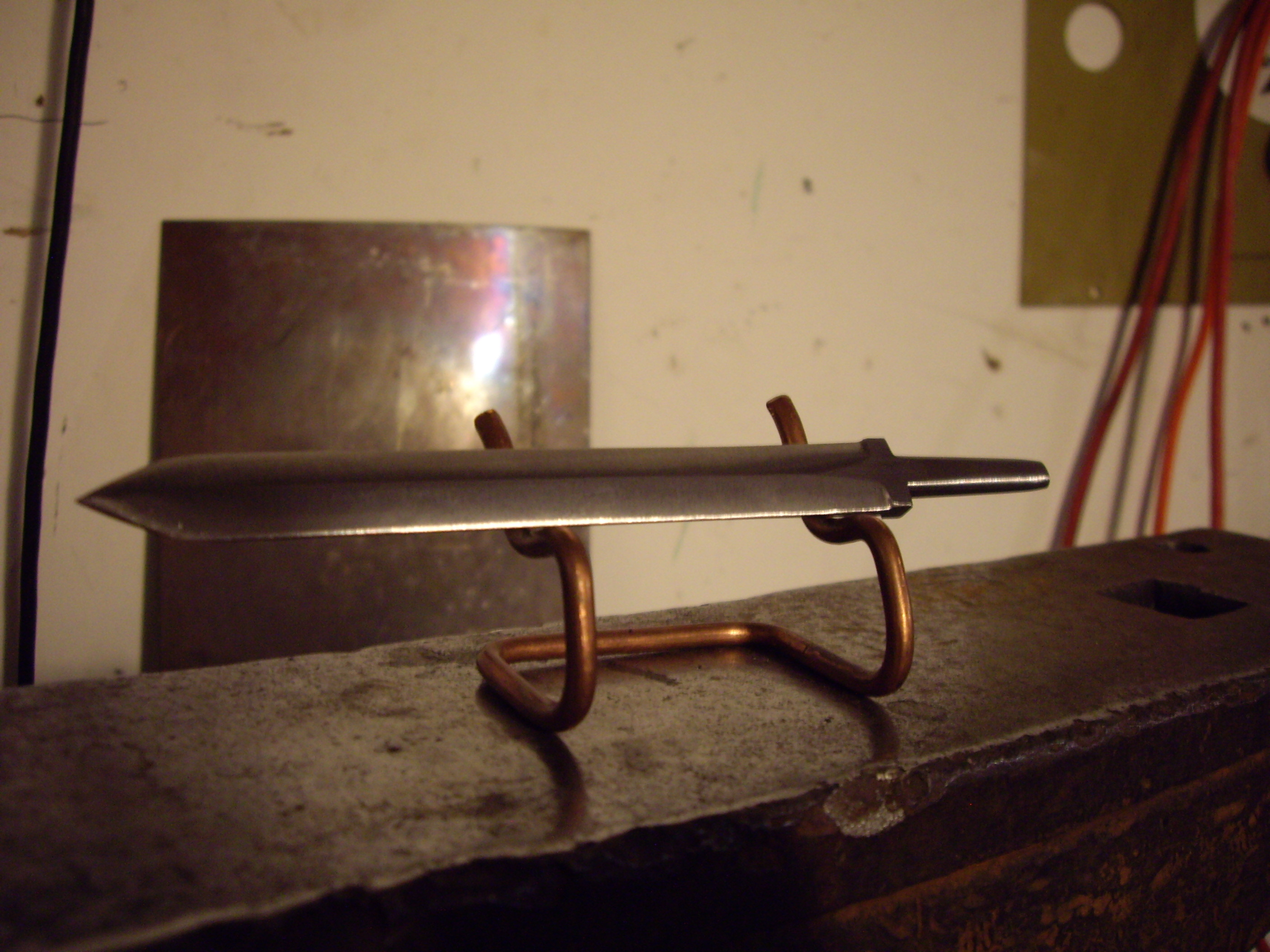

Presented for your viewing enjoyment is a special sword for one of our esteemed forum members, mystery metallurgist M., who desires a 1/4 scale, battle-ready Roman gladius forged of beta titanium. This sword is to be the real thing, small but with all the features of an enormous, cumbersome normal-sized sword.

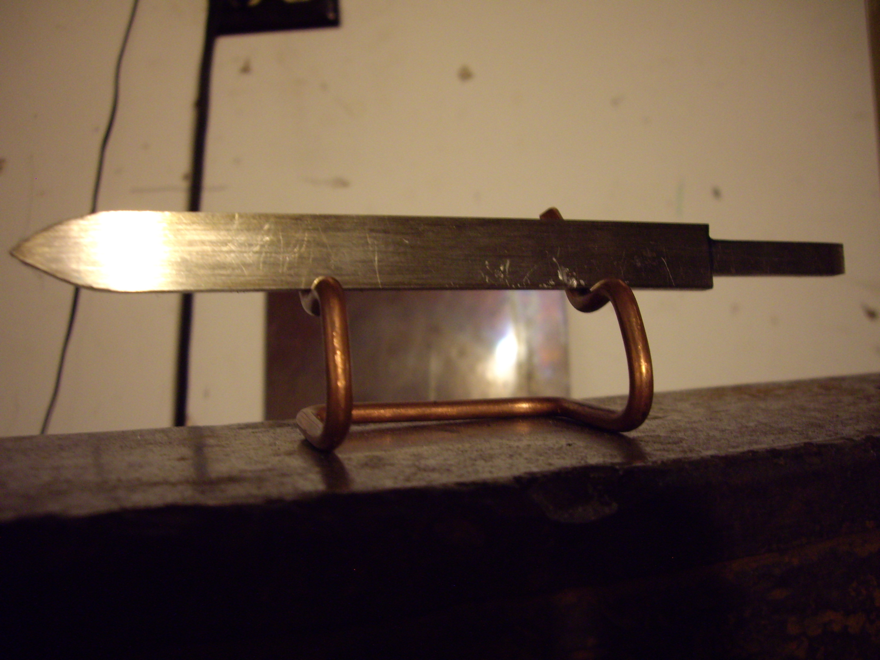

First comes the tiny billet, an exotic alloy composed of 89.5Ti 10Nb 0.5Fe, beaten out by hammer and human arm, squared on a grinder.
Working on a tiny sword is difficult when one's grinders are set up to work long forged billets. You'll be leaning in within inches, staring at minute edges as they are torn away on a giant belt, an iron fingertip grip pinching a rapidly-heating blade almost small enough to be considered jewelry.

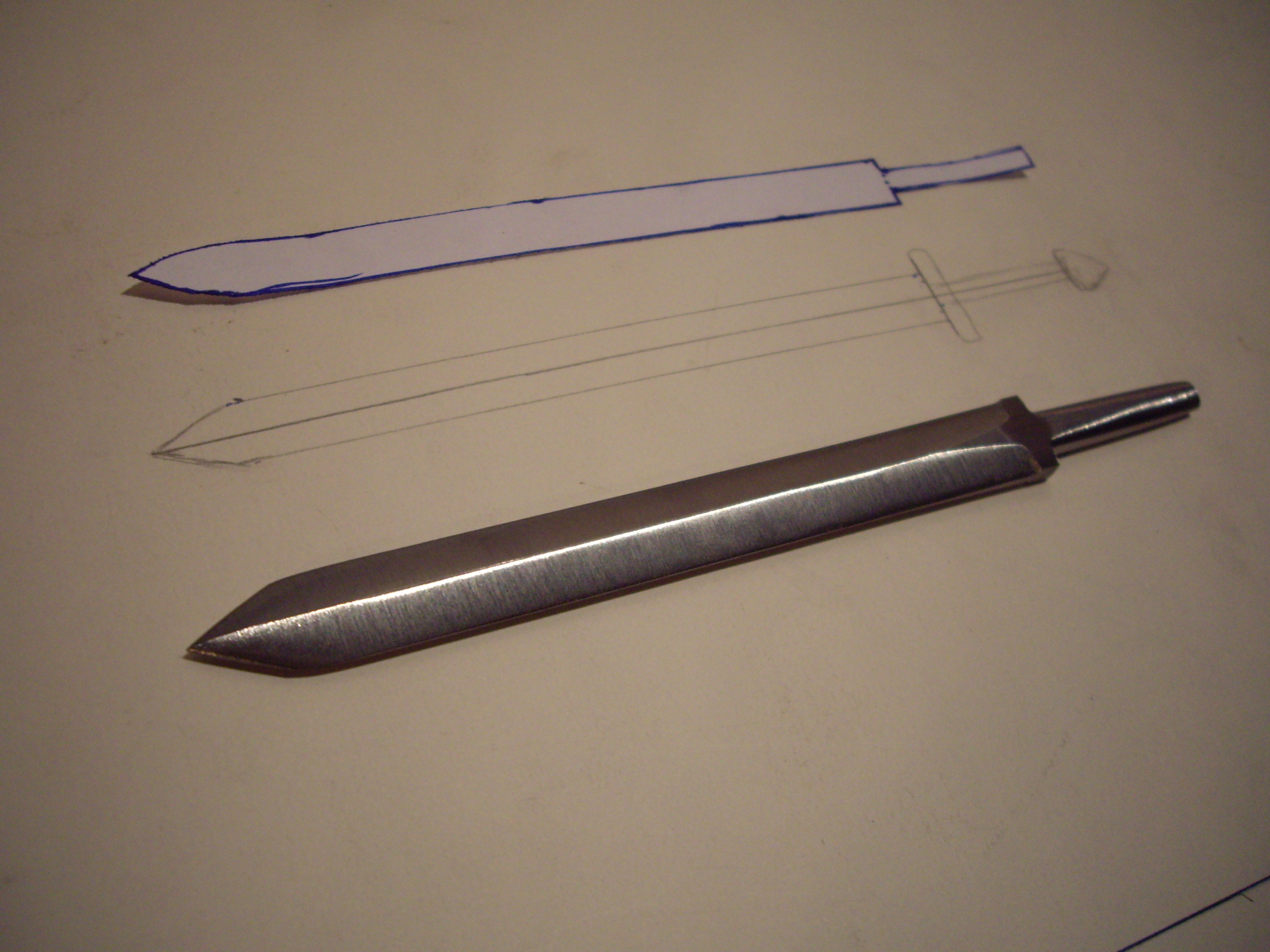

Profiled:

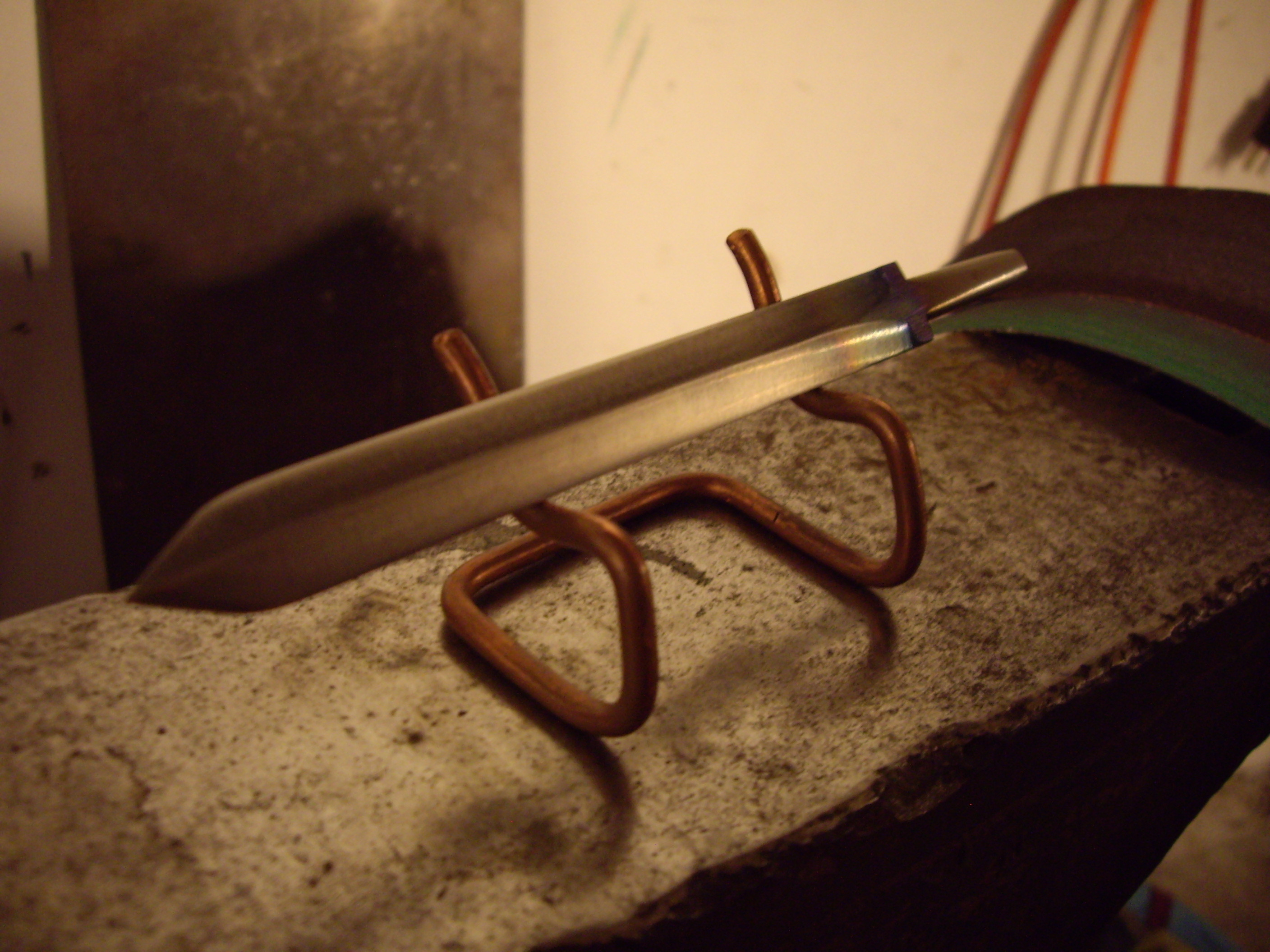

Now comes a delicate operation: the rough grinding of the blade. Using a sharp belt was a necessity when grinding these long tiny bevels. Here is the sword, ground at 60 grit, ready for marking and an abbreviated heat-treatment. Its tiny mass won't require much time at beta transus temperature before a frigid quench in ice water to harden it up.

Very neat. Notably Vince Evans started out building miniature swords before he started doing the real thing. I should note however that the hilt and pommel in your sketch are not suitable for a gladius.
A gladius:
That's just a sketch with final details left for mecha and I to decide on.It will be bronze .
Yes mystery metallurgist M. will have the final say in how the sword is hilted.

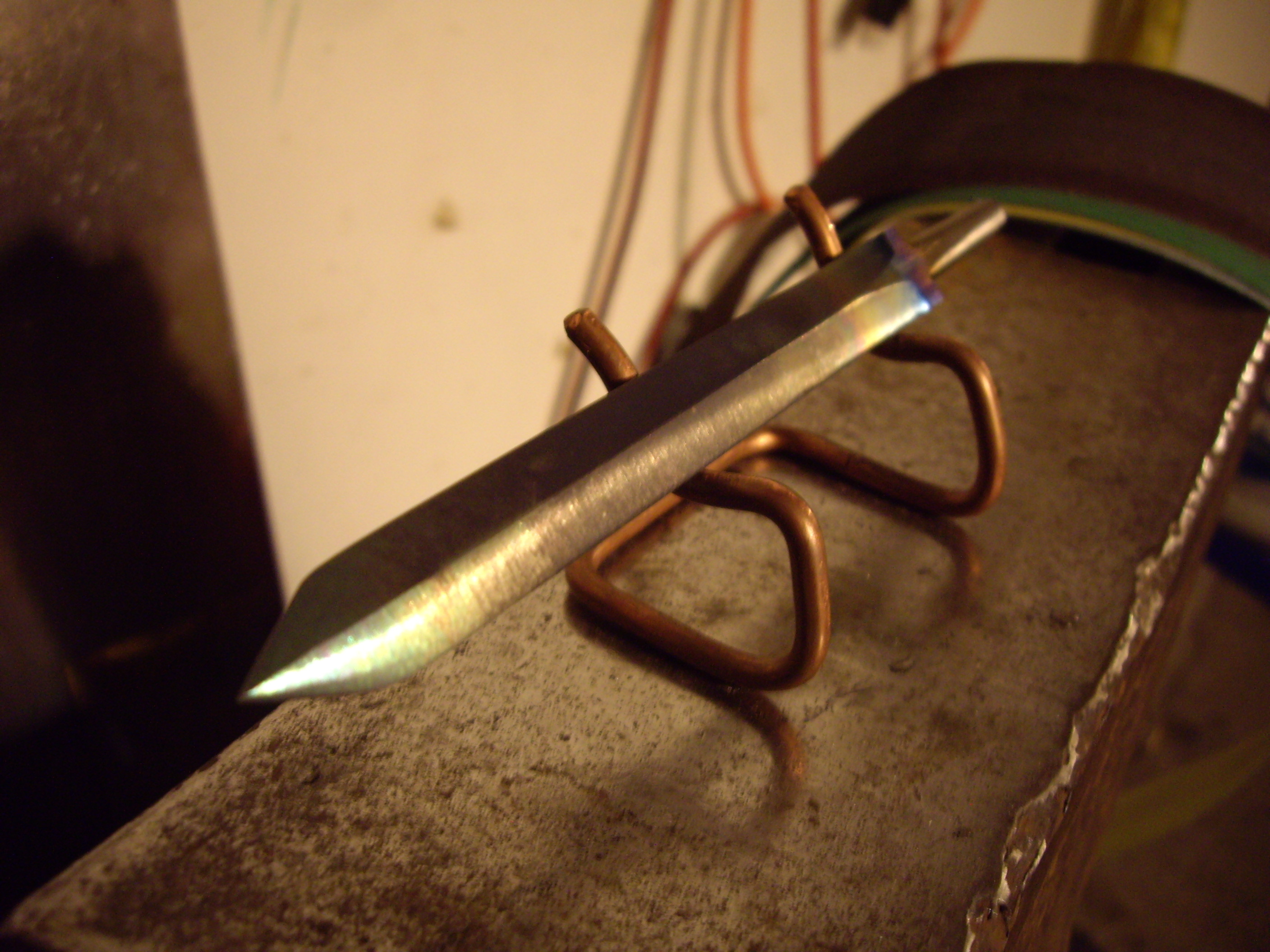

Quenched:
A bit of refinement for the blade. It's retaining some of the nice colors of hot-worked titanium alloy!

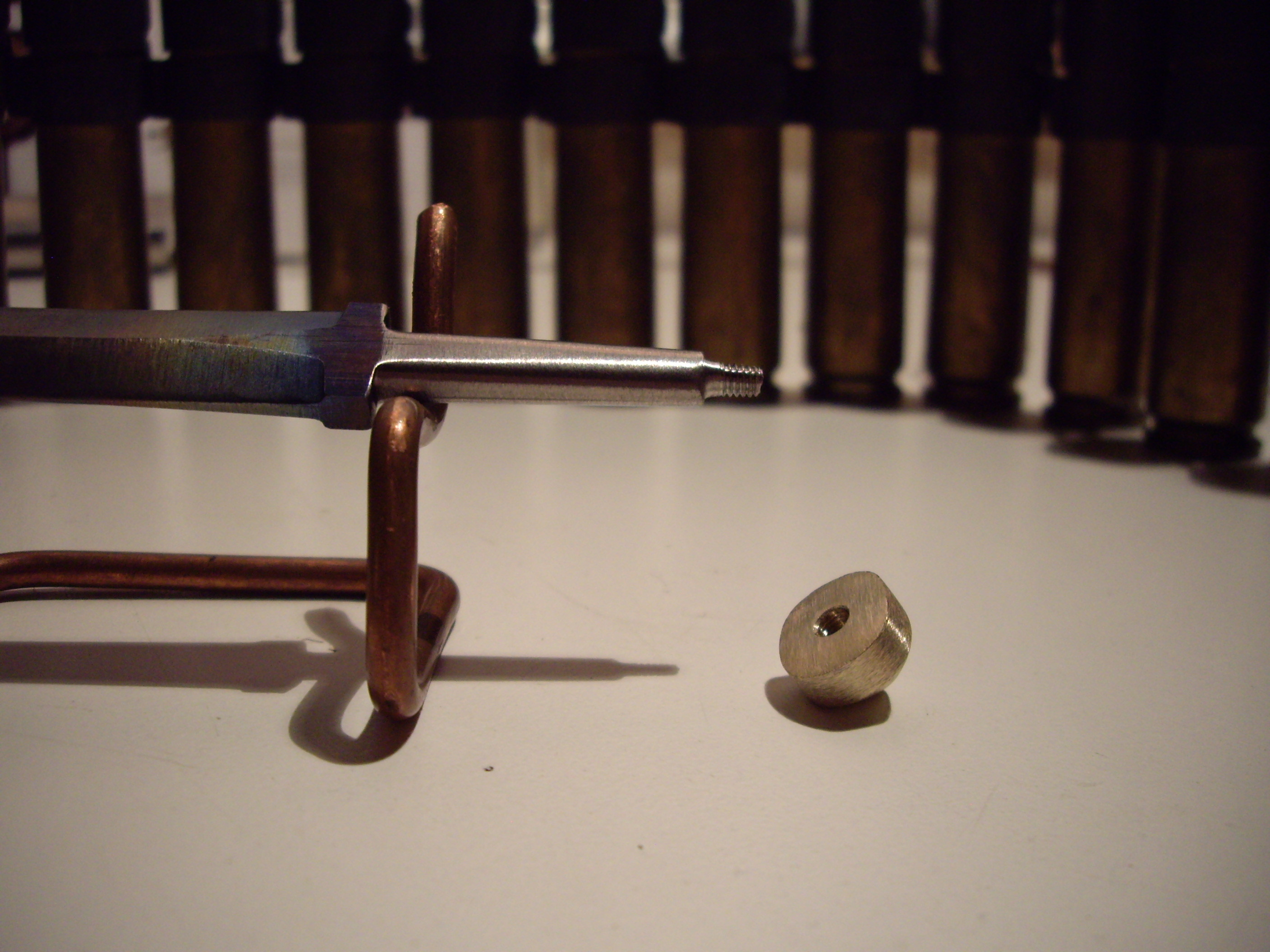

The silicon bronze hilt parts are being shaped; another exercise in fingertip grip dexterity and strength. The construction method has been finalized: a tapped pommel and threaded tang, so that the sword may be disassembled.

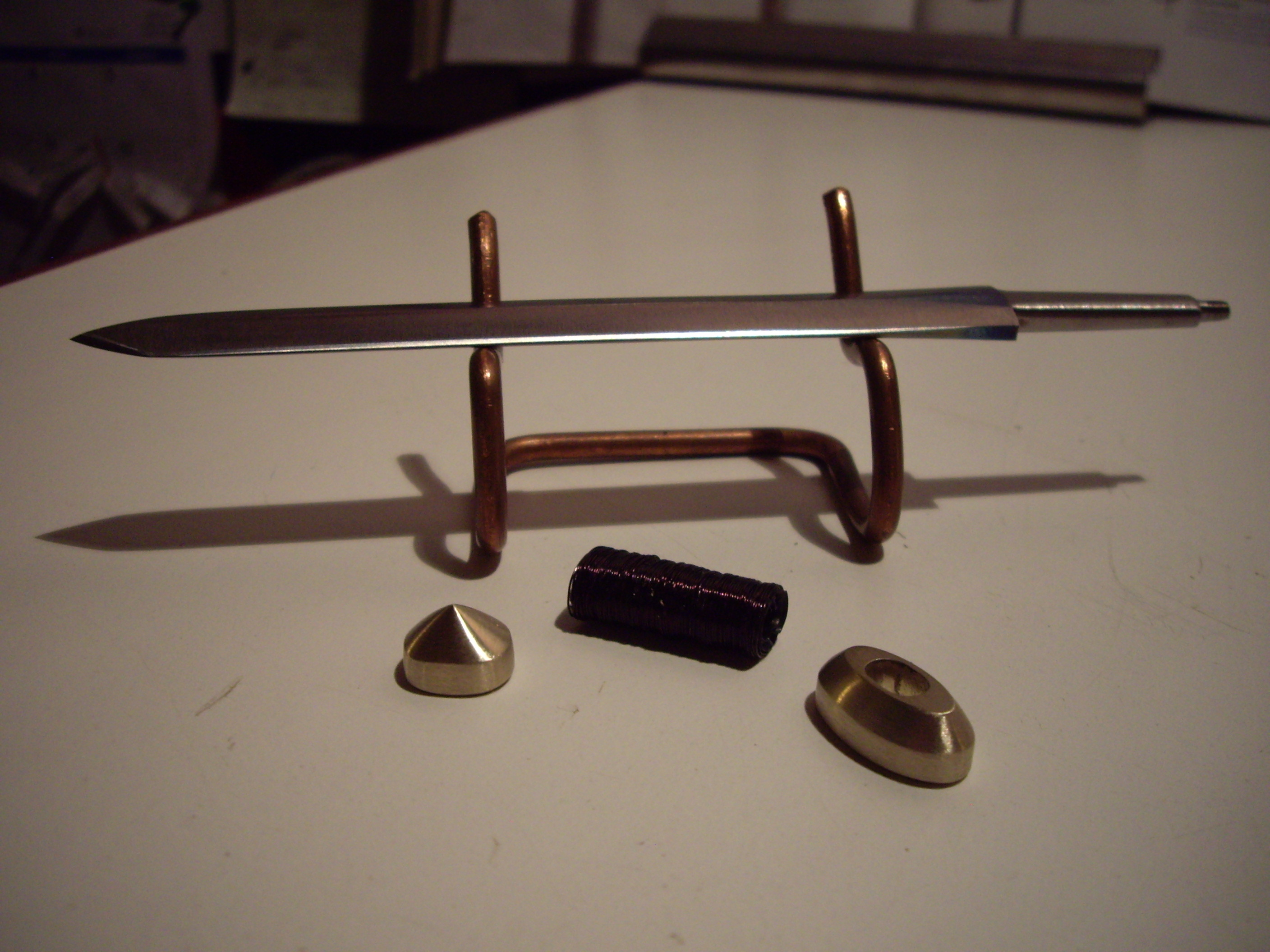

This sword was a real challenge, in spite of (or due to) it's dimensions. It's reached that point where I seem to make it worse as I go.

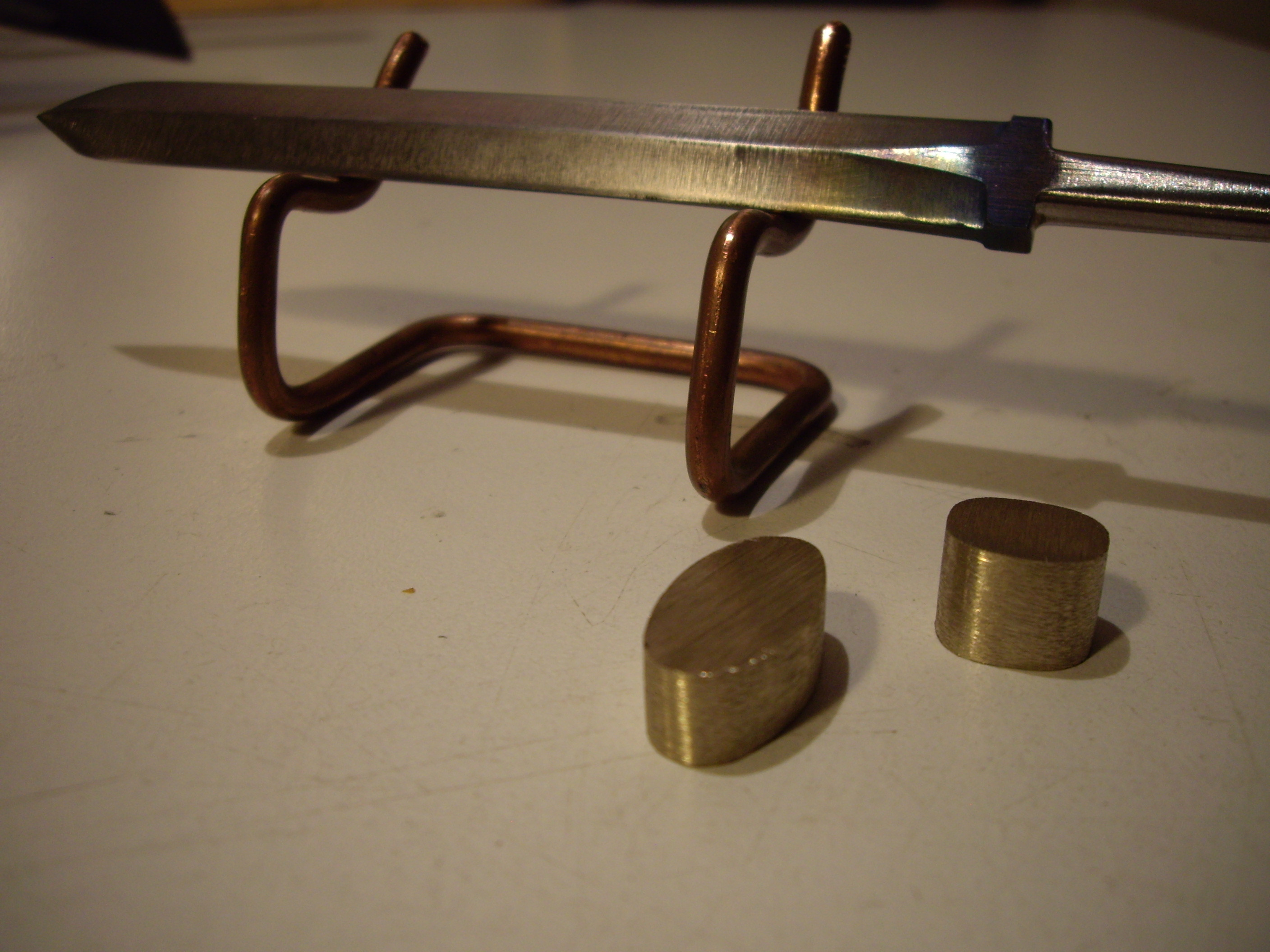

Here are the hilt parts, but the "tsuka" will simply not do...I've hatched a plan to whip up a much better one!

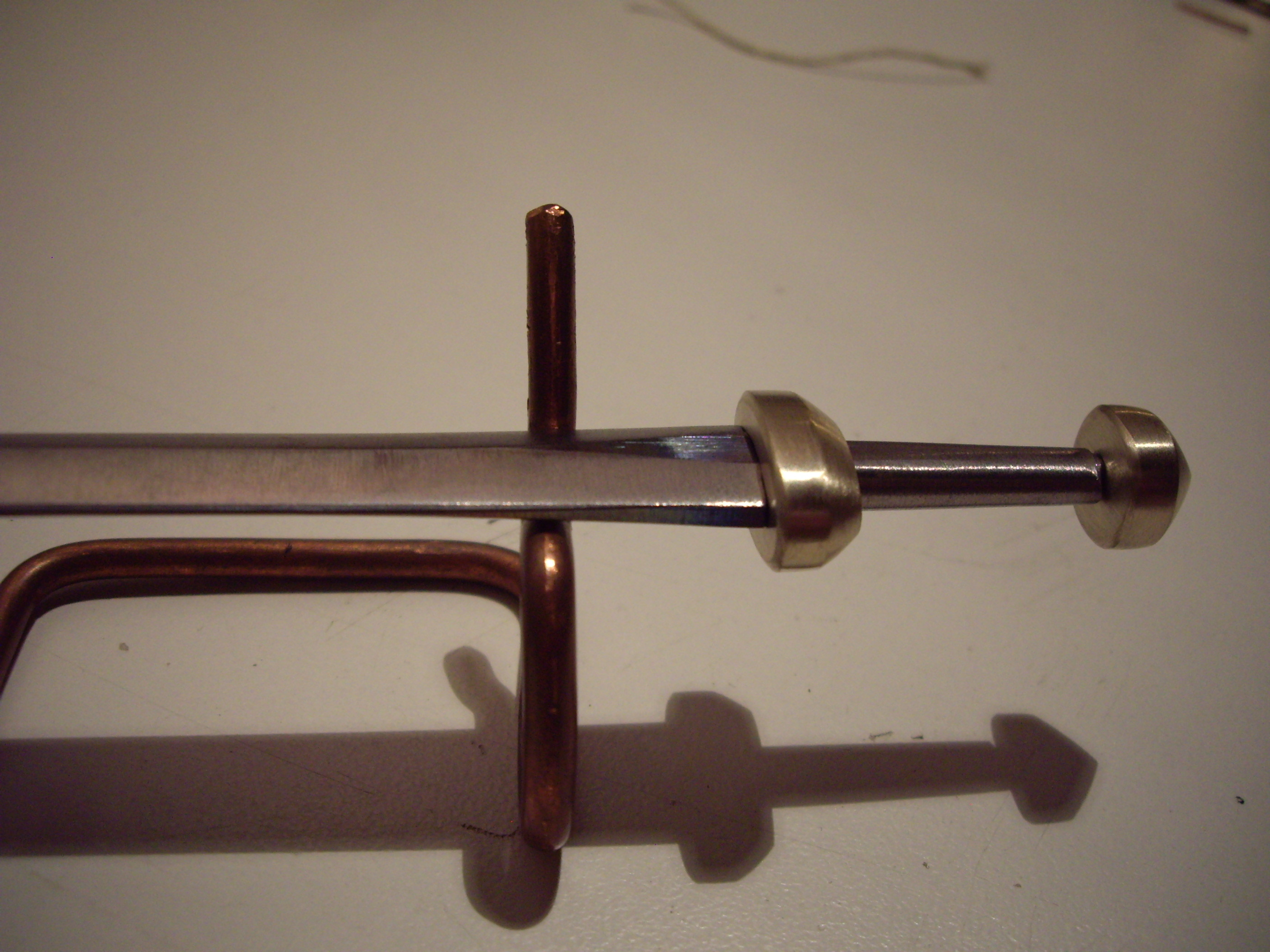

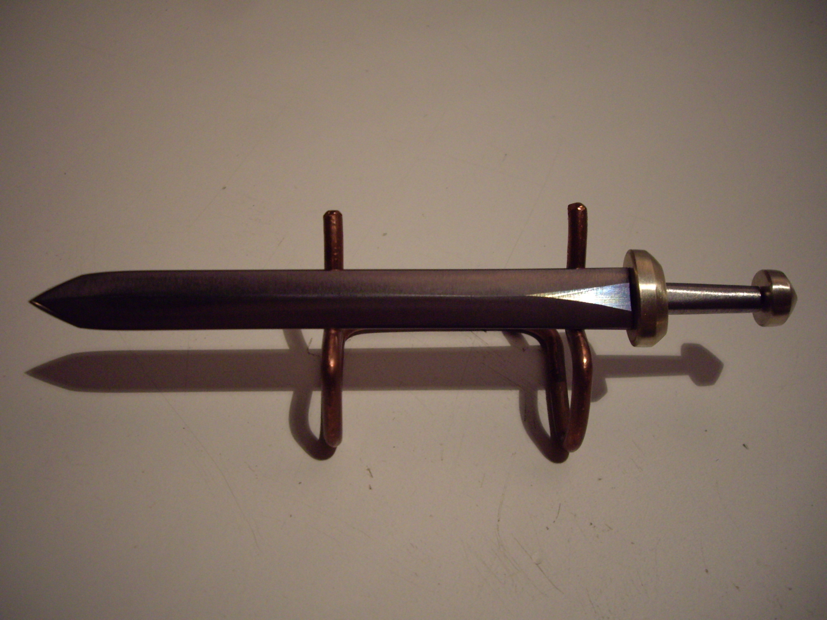

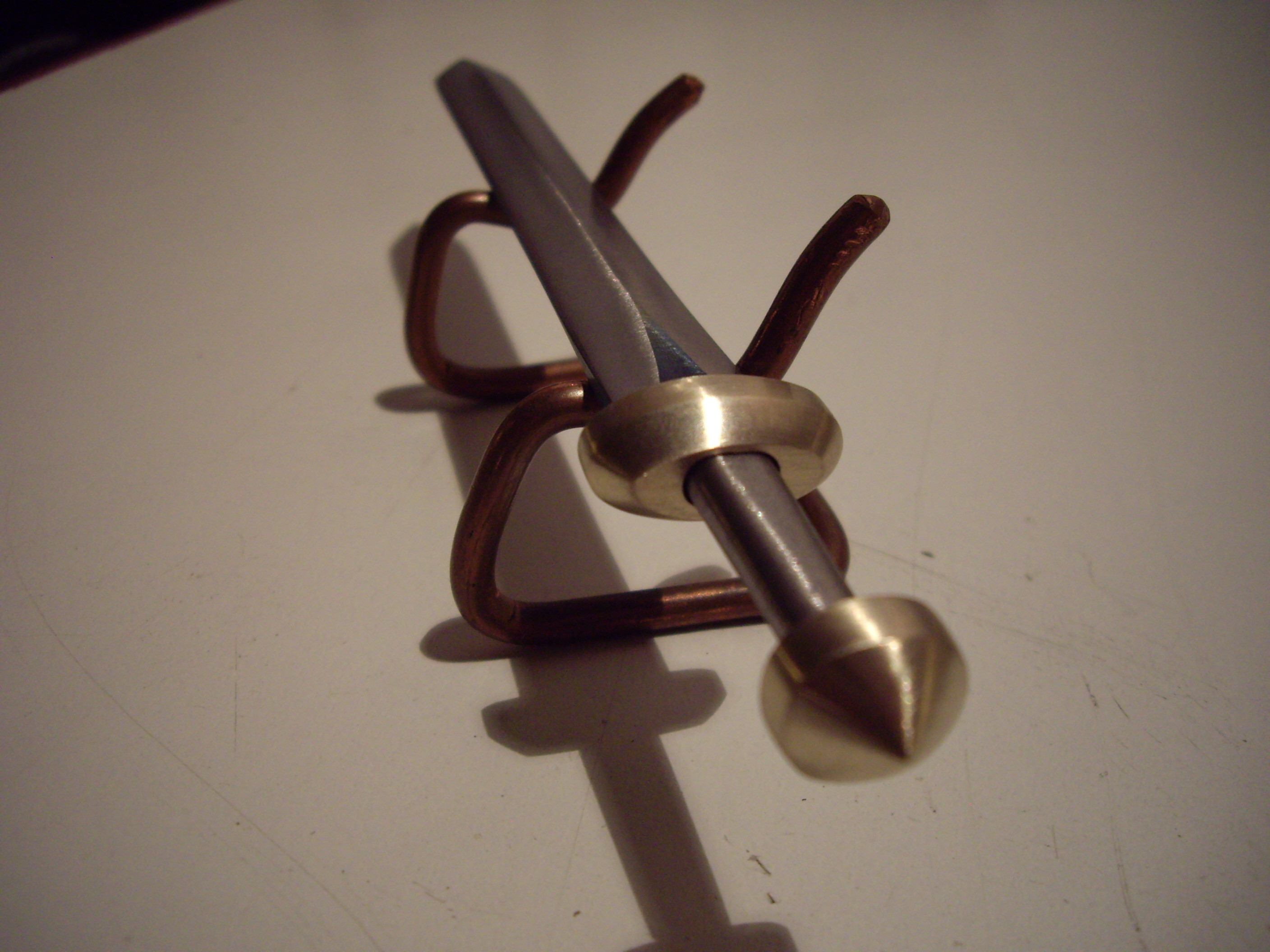

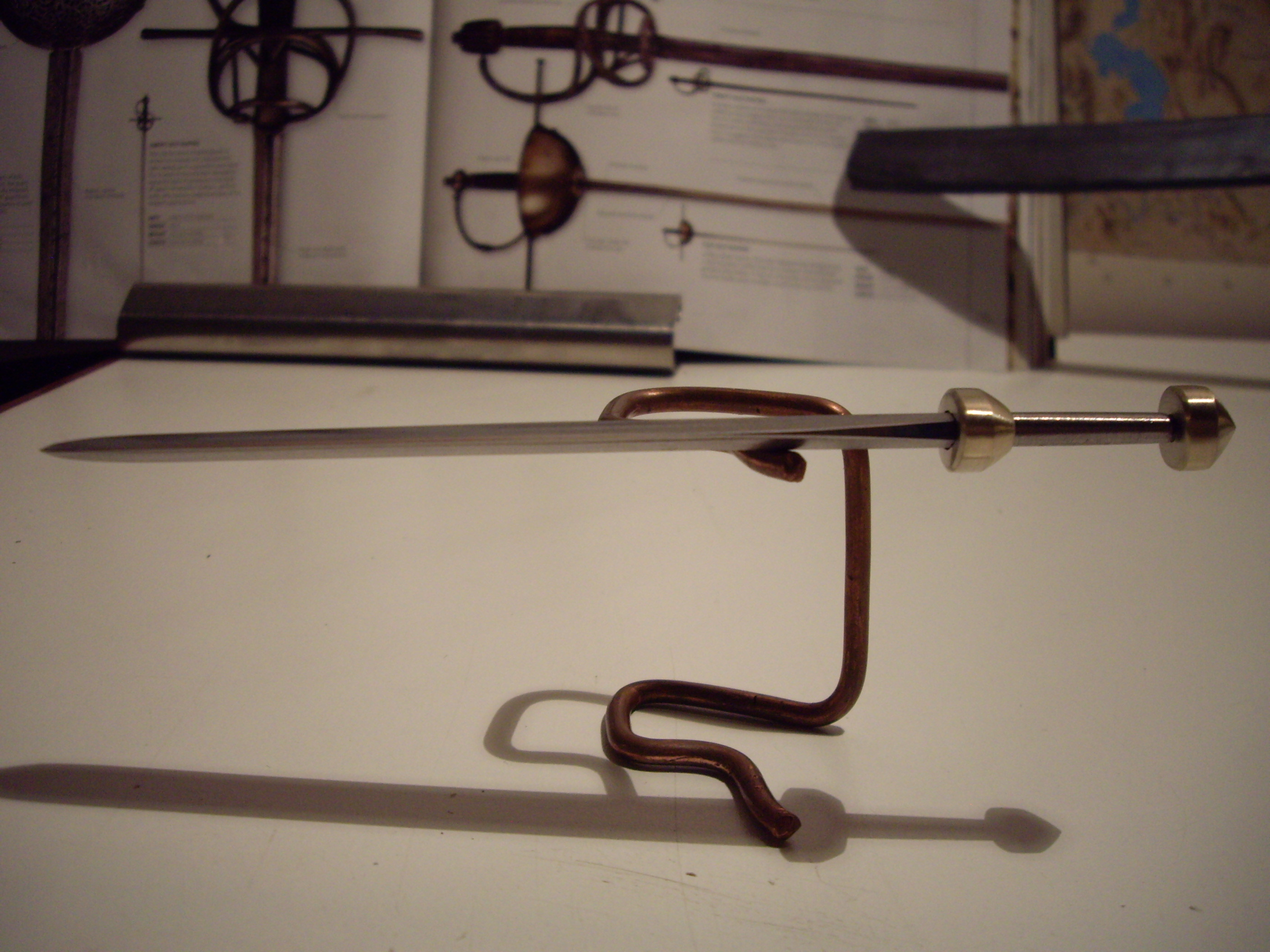

Here is the assembled sword, sans grip:

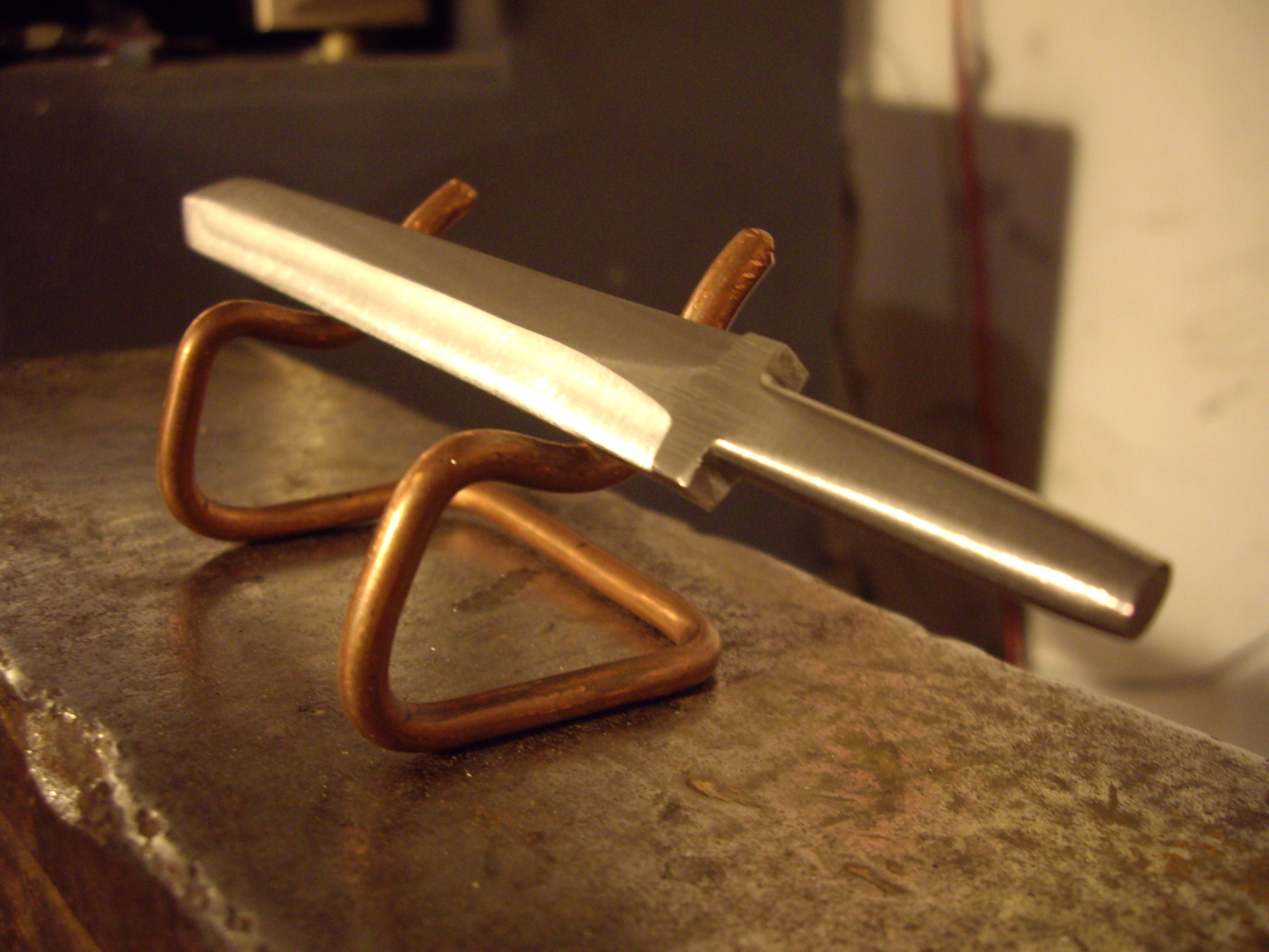

The ricasso looked bulky and silly against the guard, so the blade was carefully ground back, leaving four heat-colored triangle flats:
Here is the sword's balance point, ready for a fight!
