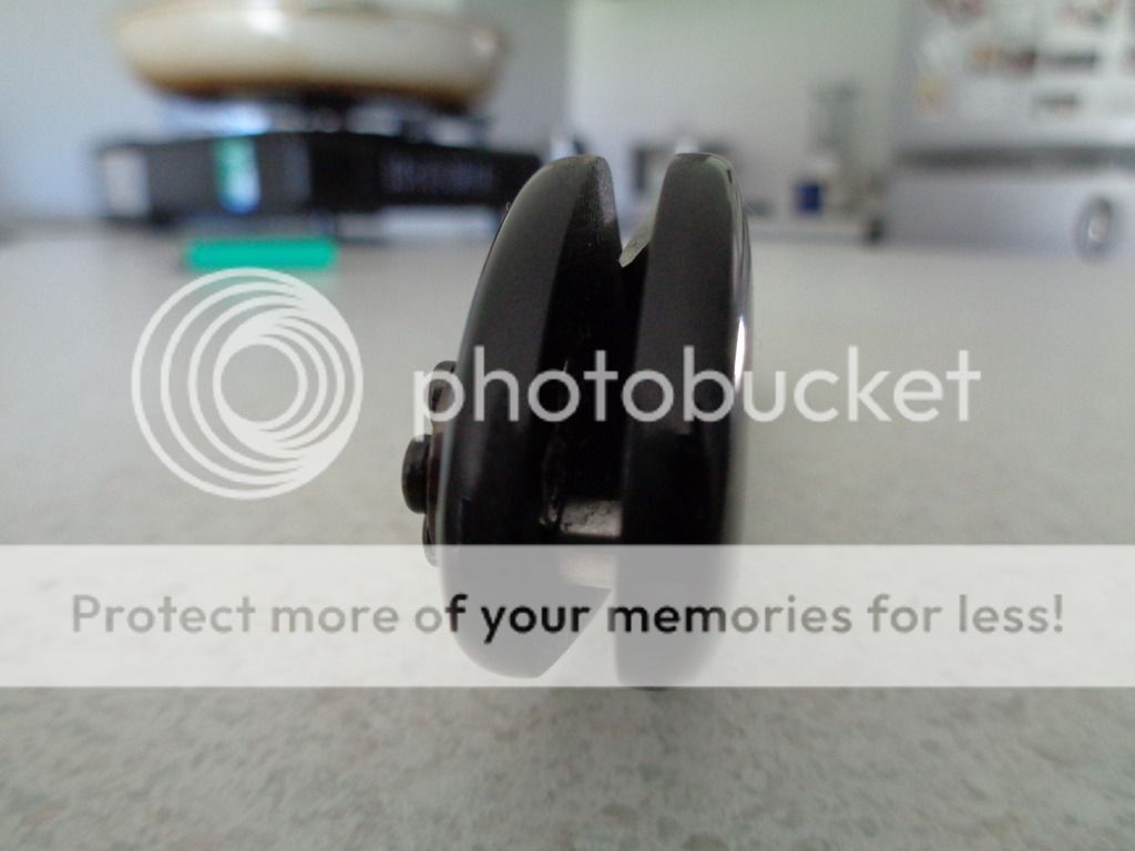

For along time I avoided Millies because they are Tip down carry ONLY.
Now that a user Millie found me. Time to make it Tip up carry.
There is another member here who did the same thing
without using threaded inserts and has not had the screws pull out.
All you need are
-Standard Spydie clip to use as a template.-
-5/64th drill bit.-
-Drill, a steady hand and a calibrated eyeball to drill straight down.-
Remove factory clip. Save Clip screws as you will be using them again.
I had manix screws on hand and used those till I was done.
Move the clip to your desired location.
Check drill location because it may drill into blade if closed. If you have to open the blade while drilling.
Put tape over the edge so you will not draw blood.
Drill one hole at a time. I used the Clip screws from the Millie to chase the holes through the G10.
Don't gorilla them on. It is G10 and will strip the threads on the G10 and you will have to use a threaded insert.
Mount the clip with one screw to hold it in place
and then drilled next hole. Chased and second screw installed for secure drilling of third hole.
Watch out for the G10 dust being generated
No I do not use a pull through sharpener on my good knives. The plastic handle was my test material to check hole size to see if it
will have enough threads.
When I was done I installed a Casey Long clip :D because it looks better than the short
and used the Millie Clip screws with blue loctite.
IMHO, it rides in my pocket better than when it was tip down.
BUT now it draws as smooth as any TIP UP knife I Carry.
After all...Tip up just feels natural for me regardless of knife size.
And now I love Millies.
Did you tap?
No tap... My local hardware store did not have a tap. So I Bubba'ed it.
Fresh holes were simply chased with clip screws. They cut "good enough" threads.
Im happy with the results.

Didn't do the job myself, but here's an attempt to take pics of my tip up Millie with 2 nuts sunk into the inside of the G10, the 3rd clip screw going into a barrel spacer.
I find it carries and deploys great the from tip up position.
Looks like a good mod if you are set on tip up carry. It definitely needs something to secure those threads to.
