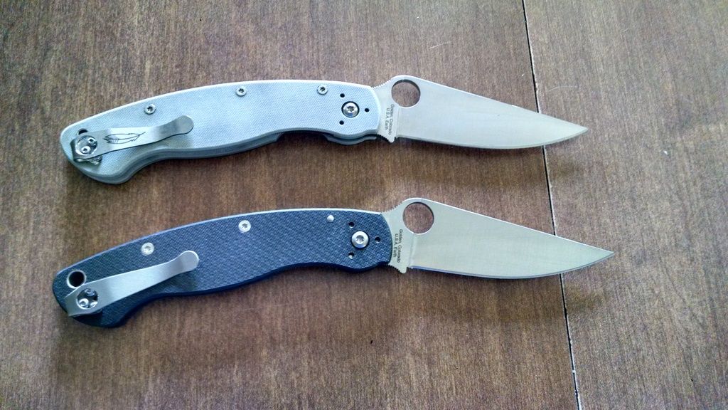

Well,
I went ahead and finished the conversion using the BM inserts.
They were too long and I filed them to half the length they were.
Found a close enough drill bit (9/64th) and I Finger drilled a larger hole on the back of the scale for the insert.
A hand drill would of been to fast and I would of drilled all the way through.
Insert set in with MXBOX 105 glue.
A stock clip and long screws were used to help seat them in while the glue dried.
They are FLUSH on the inside of the scale
Caseys Long clip re-installed..
Right hand.. Tip up... Lanyard hole
Life is GREAT.
If someone else is on the bench or Interested about doing a tip up conversion but your lacking the inserts.
I will send you 3.
Only stipulation is.
You actually do the Tip up Conversion in a timely manner
and you post pics here.
Send me a IM or email with you address.
Who knows... maybe Spyderco will start offering
Millie that way.
