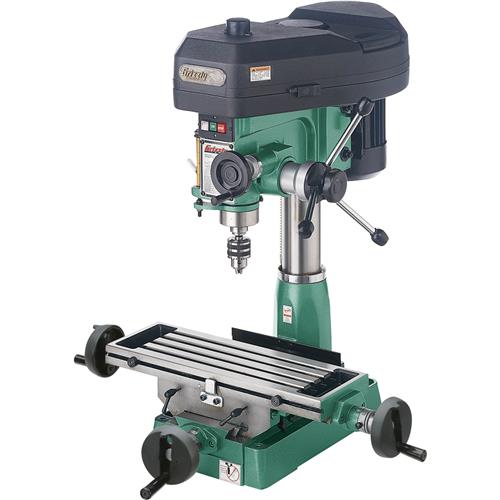

For the most part the only debate in this thread is due to the fact that most round column mills will lose their center when they swivel if you have to loosen the head to raise or lower it, where a square column mill can be raised and lowered and not lose it's alignment with the workpiece. That's been the only discussion here on round vs. square so far as I can tell.
Now, I could be wrong also, but looking at the round column mills you posted, the head doesn't raise or lower, but the table does, so the debate that's been going here does not apply to the mills you posted. That's why I don't think it belongs in this discussion, especially when it's done in a "look how much smarter I am than you" kind of way;)
Just so we're all on the same page
In order to account for the different length of tools and work piece sizes mills can be adjusted.
Mills can be adjusted
On the round column mills, like this one:
Those 2 black screws just in front of the motor are the only thing keeping the entire head in the same position.
It's a clamping force, not too rigid if you consider the vibration in cutting.
In knifemaking operations you will want to perform different operations on the same center
ie a short center drill, longer drill, then longer reamer all on the same center position.
Once you move that head, the center point is lost.
You can reduce that effect if you cut down the longer tools to stub shanks- make short reamers etc.
In the past several years, the mini mills have started to use square columns so that is less of an issue.
but you see, an overall smaller size of machine.

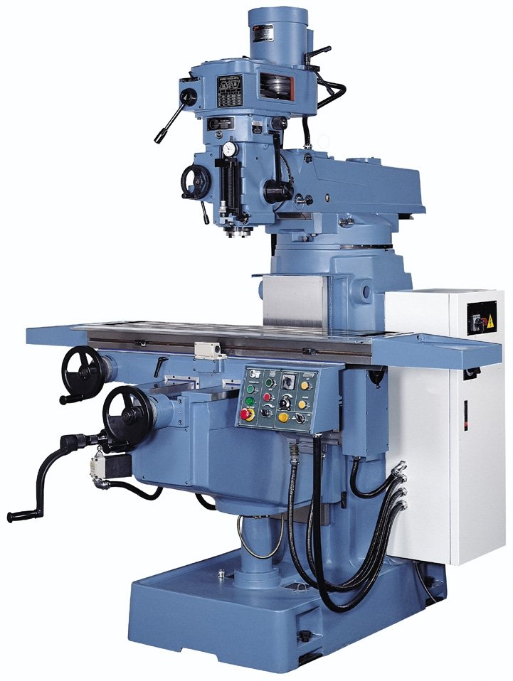

This is what I call a Knee mill - the knee (below the head).
The table moves up and down on dovetails with a cranked adjustment.
No moving the head.
This idea is used all the way up to the biggies that Monkey posted above.

Buy the biggest badest mill you can afford and make room for it. honestly you will find so many things to do with it after you get it that you will want a bigger one. get something with a knee!!! I just went through this and picked up a very nice 1985 bridgeport with cnc controls for $4000.
I wish I would have bought something bigger:) but for knife making I would never go smaller. i can face a piece of 2" cpm154 from .220 to .150 in 15 min or so with a 2" carbide insert face mill. if you are gonna keep doing folder work you will want to be able to do that sort of thing every now and then. Pluss I have made countless jigs for the mill out of alum, and being able to take .060-.070 passes with a 2" facemill is sweet!

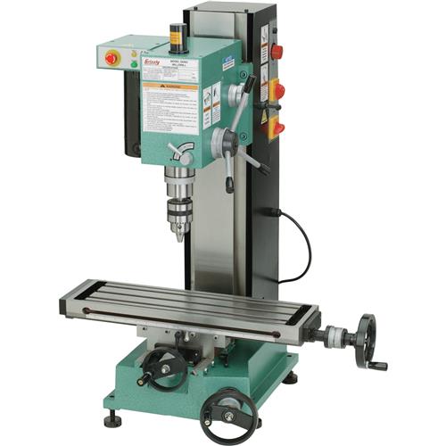

Hey... it's my machine (minus the DRO's). I wasn't going to chime-in on this thread, because my experience is limited to ONLY this machine. I bought it (and the 3-axis DRO package) at the end of May last year. I was looking for a machine that would do the following:
  1. Be able to machine guards, folder parts/pivots, and small parts.
  2. Have repeatable accuracy. This is why I invested in the DROs.
  3. Fit into my tiny basement shop. At 353lbs, it was tricky to get this sucker down the stairs by myself - not to mention lifting it to the bench - but it was doable.
This machine DEFINITELY has its limitations though. It does NOT have the mass or power to drive any reasonably large end mills cleanly. Facing or large surfacing processes are painful. Half-inch is about as big as I like to go with an end mill in steel.
The minute I build a real shop - or move to a place where I have a real shop - I will upgrade to a larger knee mill... and this one will become a dedicated drill or tapping machine.

This is the model I have, even with the head clamping bolts tightened so the head does not swivel, the column/head/quill (especially the column and the quill) flex so much that I will get 1/16 inch deflection in the direction the cutter is pulling on a 1/4 inch plunge cut with a 1/4 inch end mill on mild steel, makes precision work challenging at best
-Page
