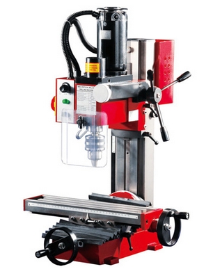

Absolute CHEAPEST mill that with the right feeds/speeds/tooling/bits will be able to handle light work with Ti and carbon fiber and a little bit of steel?
Just curious and might be looking for a mill one of these days.
Thanks in advance,
Alex.

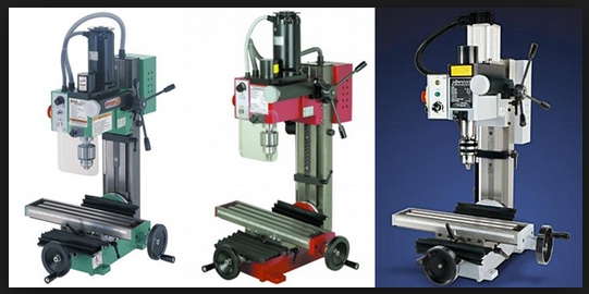

There are many variations of the 2 range variable speed, Sieg SX2 Mini Mill from different companies (various brands sold in the U.S. include Grizzly (green one-pictured on the left in the picture above), Central Machinery (red one-Harbor Freight pictured in the middle in the picture above), Microlux (Micro-Mark) and LittleMachineShop (the high-end price spread version of the X2, white one-pictured on the right in the picture above)), with Harbor Freight’s
likely being the cheapest you’ll find ( especially if you apply one of their supercoupons or hit a parking lot sale at a store). You might go even cheaper by finding one of these on CraigsList. Note here that I’m in not suggesting that the HF version is ideal or even, ultimately. a good deal. You will also need tooling, plan on spending about the same amount of cash (as you spent on the base machine that is) on things like a vice/clamp set, R8 collet sets, a keyless chuck, cutters, an indicol and dial indicator etc.
You will see these pups in the internet shop tour photos of many knifemaker’s shops and they can be set up to do a decent job on “light work with Ti and carbon fiber and a little bit of steel.” There are also many internet articles on modding these types of machines to make them more rigid and ease tramming them. Getting one of these suckers straight, square and plumb in all 3 axes is an adventure the first time you try it (ask me how I know this)
You can find a lot more information @:
http://www.mini-lathe.com/mini_mill/reviews/sieg_sx2/sx2.htm
http://www.mini-lathe.com/Mini_mill/Introduction/Introduction.htm
http://makezine.com/2011/11/23/the-sieg-mini-mill-one-manufacturer-many-brands/
http://littlemachineshop.com/Info/minimill_compare.php
My last comments are these: Your personal mileage may vary and buy once cry once
Corey "synthesist" Gimbel
When it comes to milling machines, "cheap" and usable may not go together very well. The smaller import mills often need to be disassembled, deburred, cleaned up, and otherwise modified to make them a decent machine.
Plan on spending as much (if not more) on tooling and work holding as you do on the mill.
Bigger is usually better. You can do small work on a big machine, but not big work on a small machine.
Often the best option is finding a used mill that was taken care of and comes with a fair amount of tooling and whatnot. That said, let the buyer always beware. There may be a good reason that the mill is being sold.
