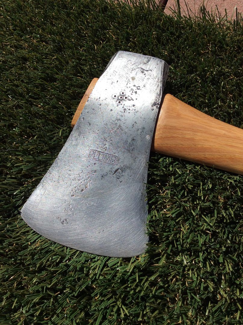

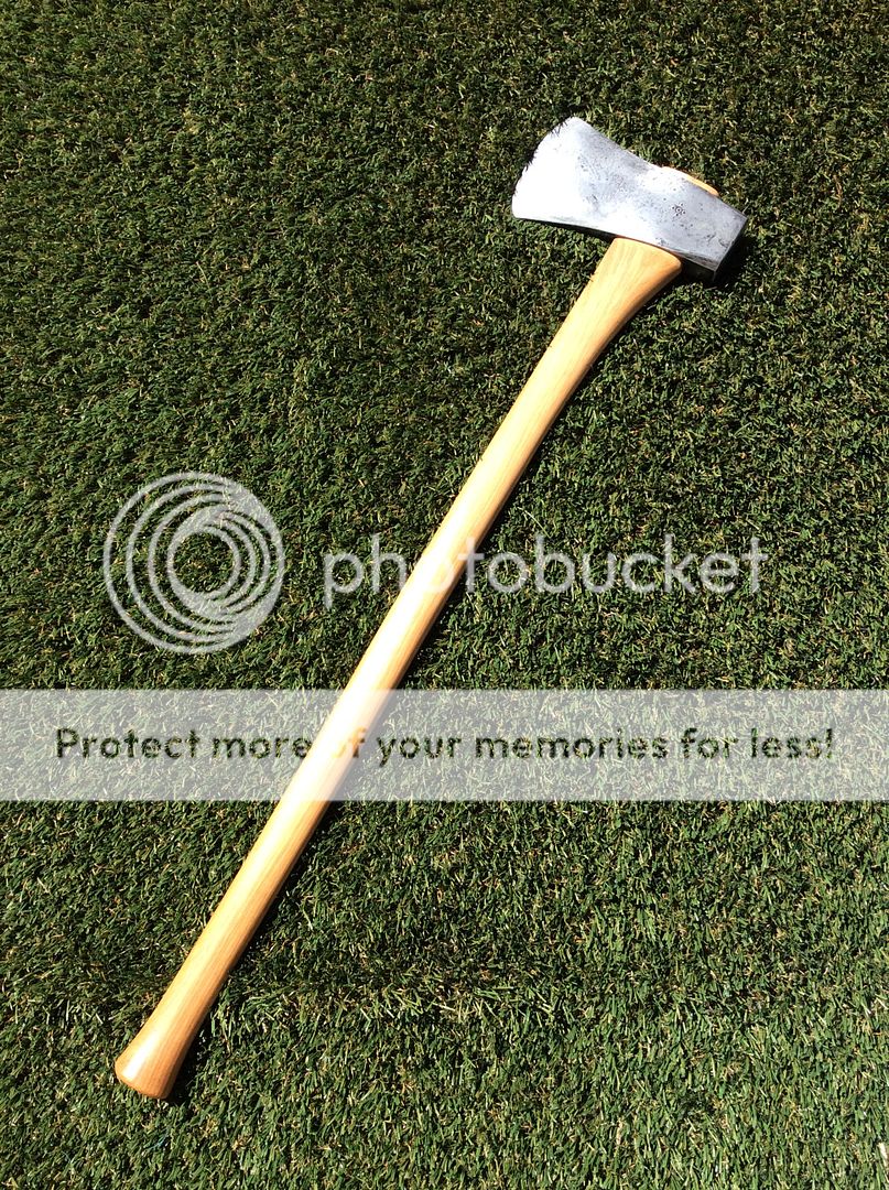

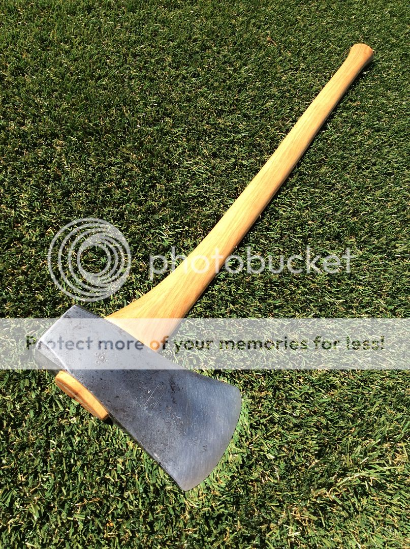

Beautiful hang!
And good choice going with a straight haft.
Agreed. I have two premium 3.5lb Plumb National heads with matching 28" straight handles in my project queue.
Although Nationals have a high and generous poll that part hasn't been hardened, far as I can tell. I agree fully that this pattern lends itself to straight handles as long as end users understand not to strike metal (spikes, rebar, splitting wedges) with them. If someone with smithing skills offered to service these types of heads to toughen-up the polls I'd be the first in line to have one done.

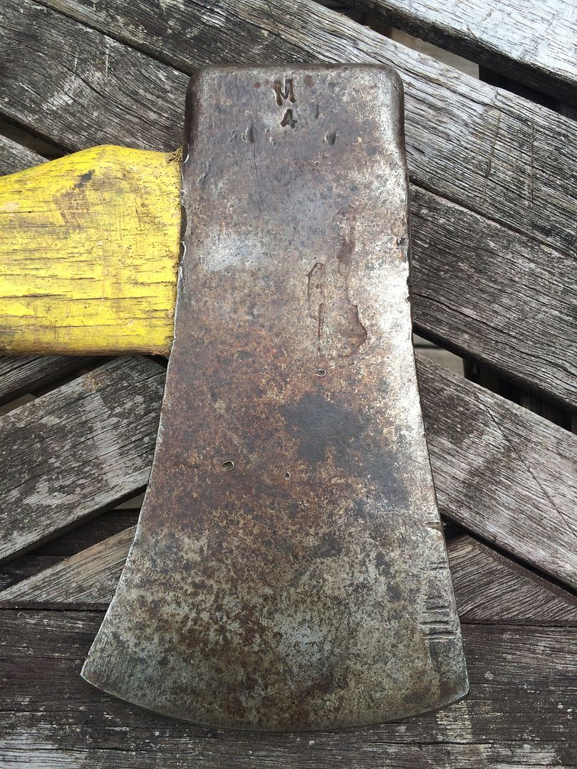

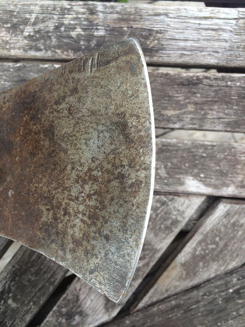

From the general geometry I'd guess that's a Mann era Collins. Just a WAG.

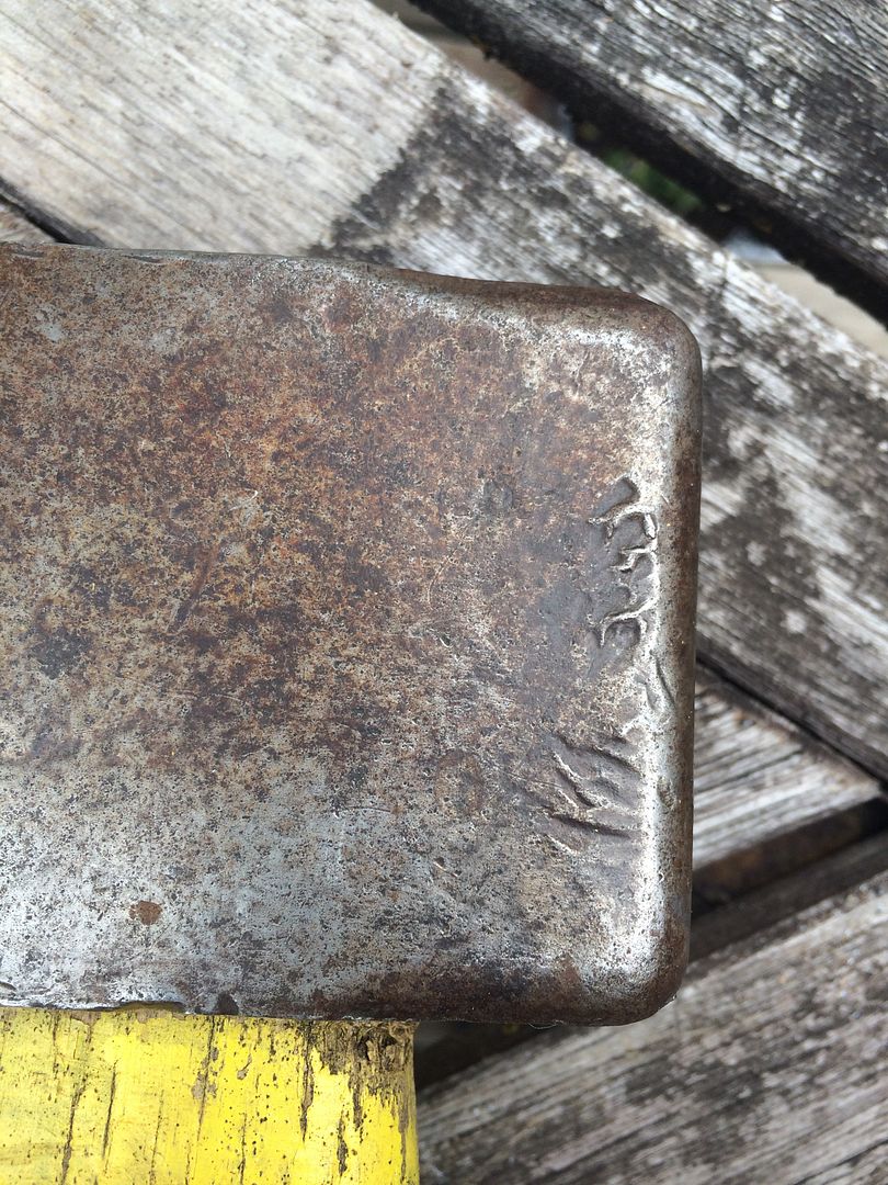

Square_peg I forget, is your Dayton marked with anything besides the True Temper? I wonder if the A and B plus numerals stamped on them might indicate something poll related?Yep, that's a Walters and it does show some sign of mushrooming. Sorry that other one fell through for you. I was glad to hear that JB fixed you up.
Here's another of my hardened poll axes. This one is a True Temper Dayton pattern. Surprised the heck out of me when I took a file to it. It's quite hard.
