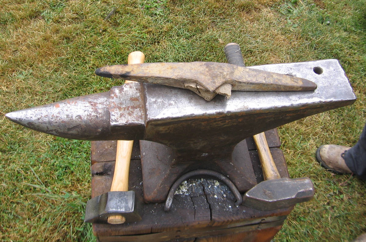

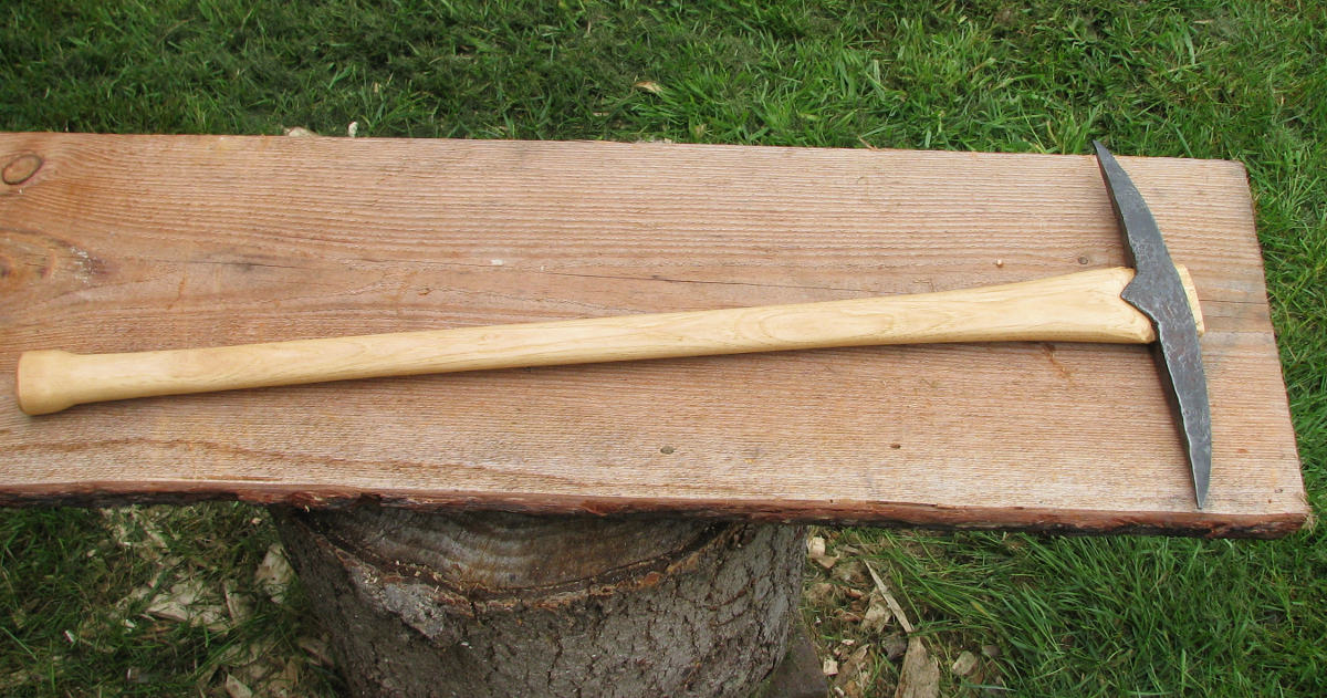

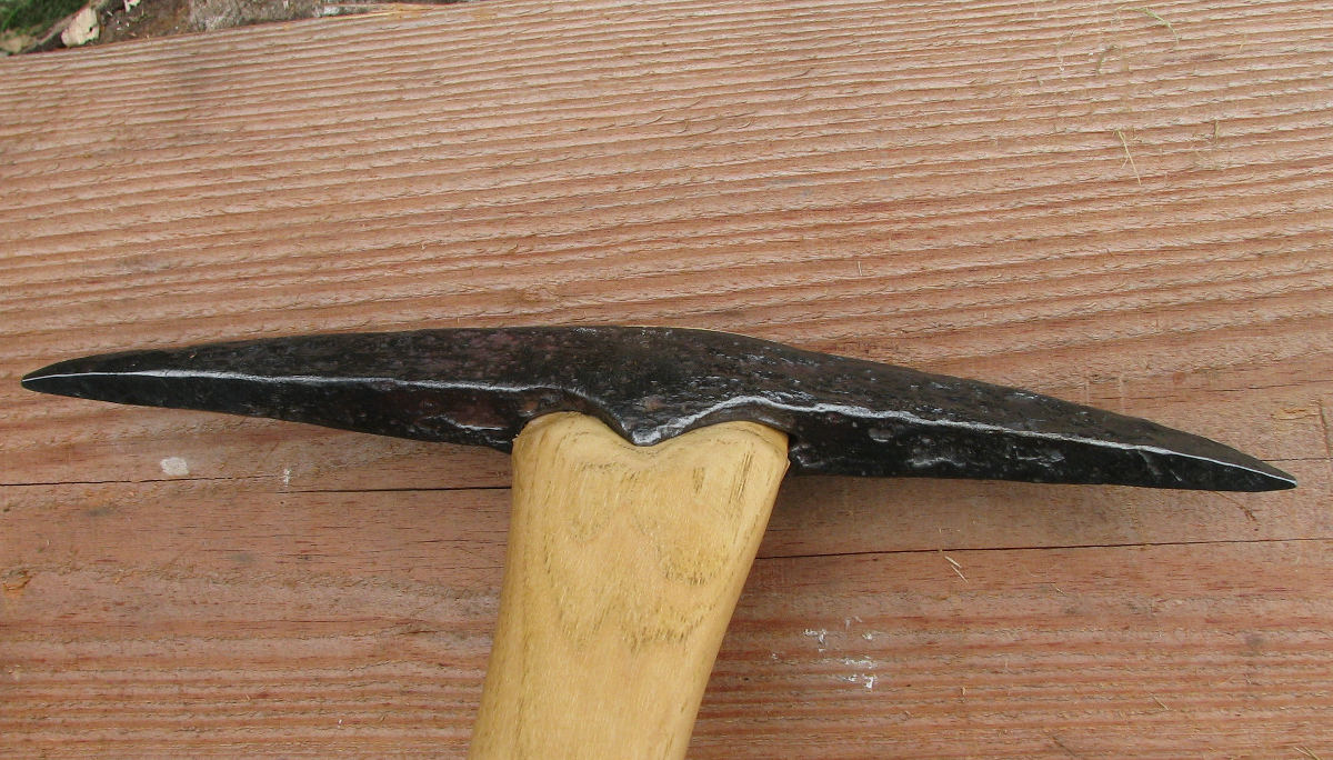

Here's something a little different. I found this miners drift pick at a local estate sale last year. Restoring it has been a work in progress for some time. I finally hung it today.

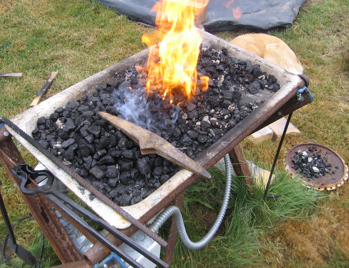

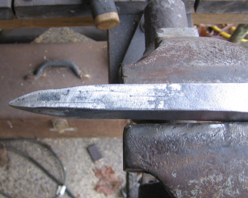

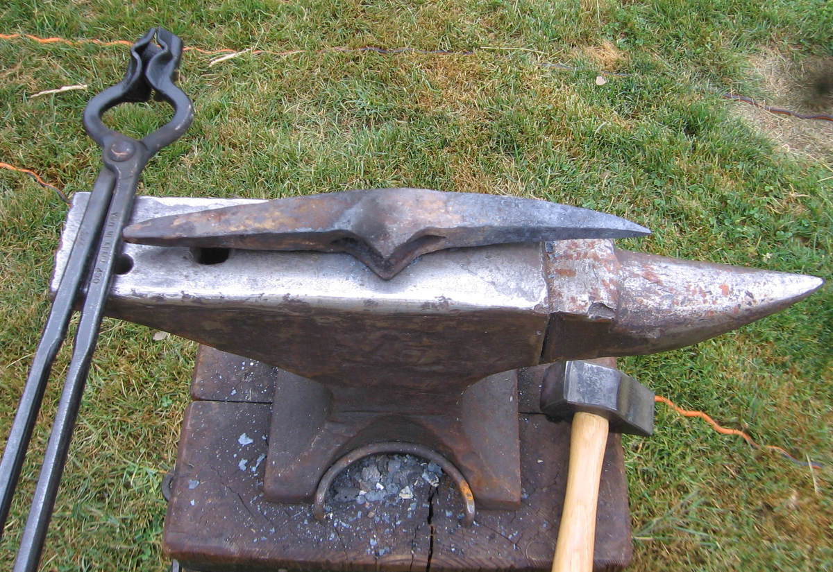

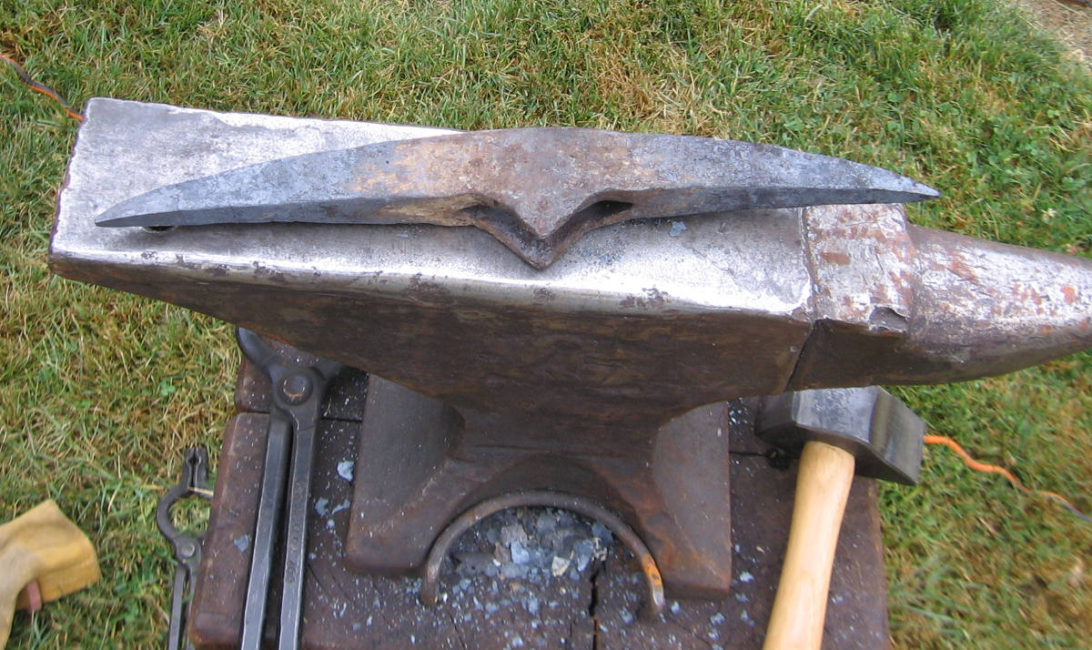

Here it is as it came to me last year. Rather than grind away metal to re-point this pick I decided to draw out the points on the anvil.

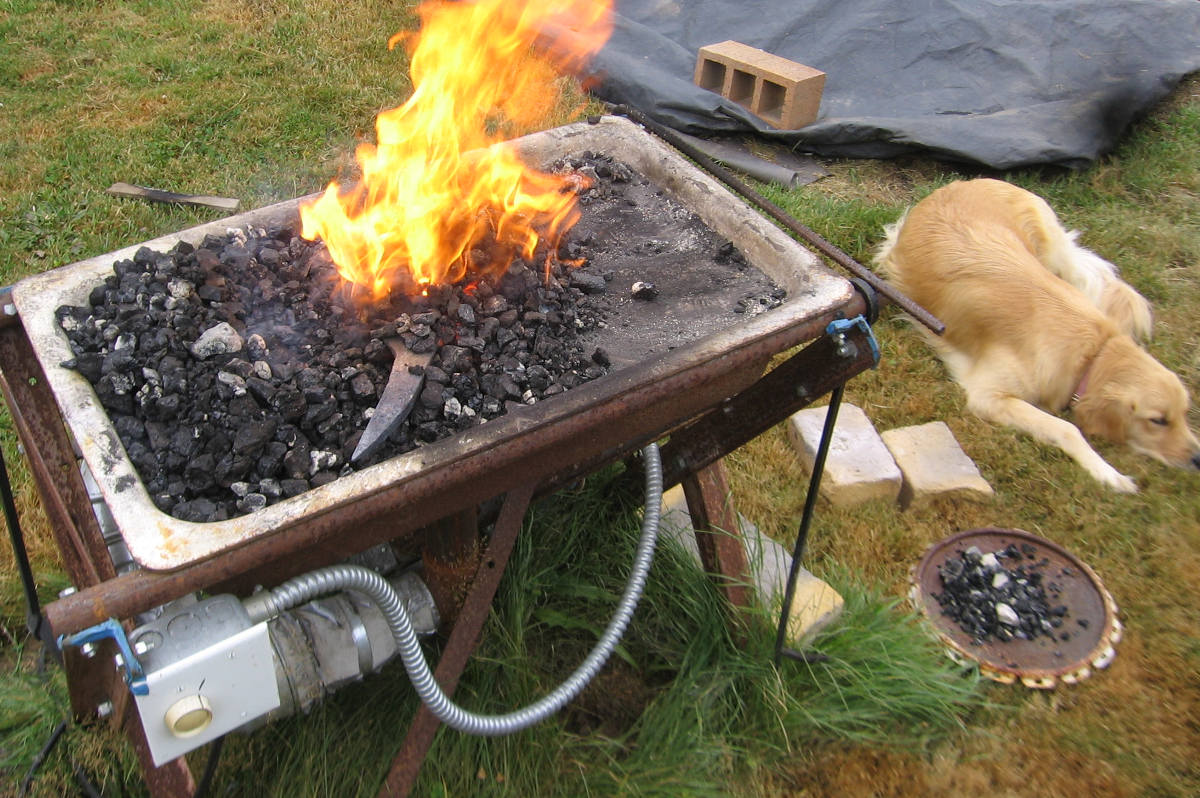

Heat up the forge.
One point done.
Back in for the other side. The neighbor's dog loves to watch me work.
Re-pointed pick.

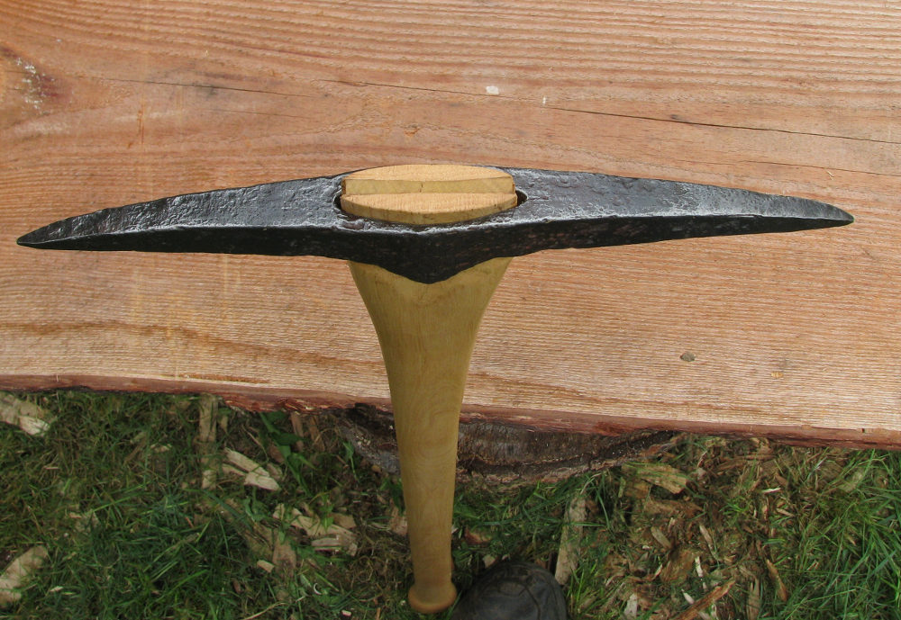

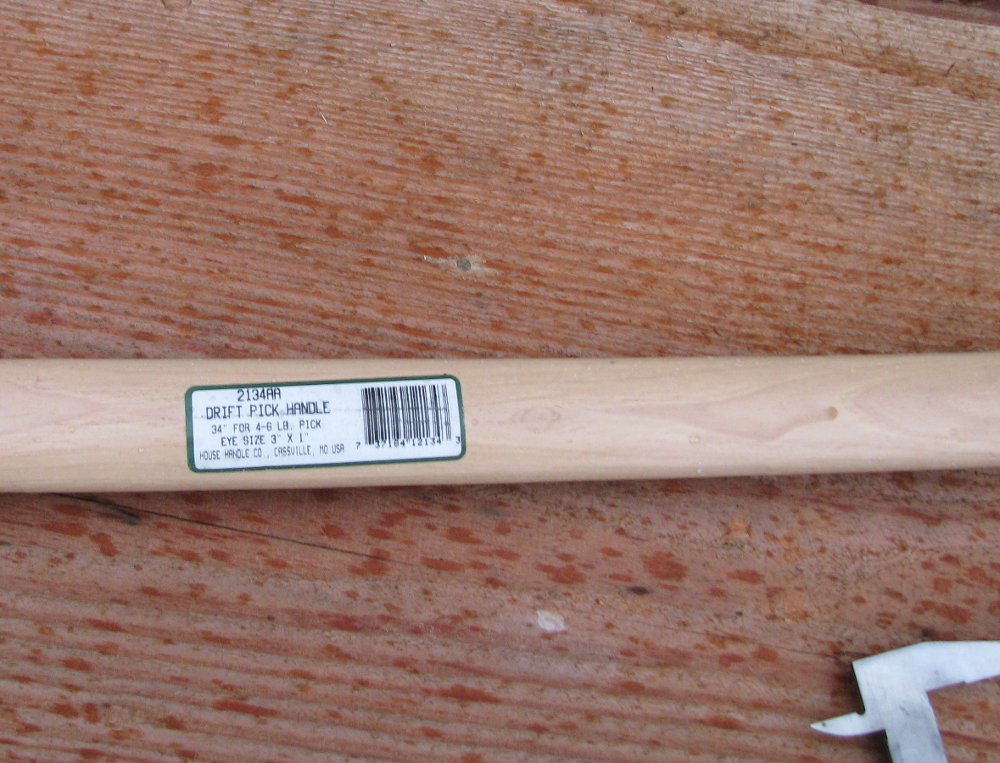

Time to hang it. I ordered a new drift pick handle from House Handle.
One of House Handle's drift pick handles could be made to fit a double bit axe. Nice thing about them is that they come with no kerf. Like many of House's axe handles this handles eye is rotated out of line with the rest of the handle. I had to straighten it out to hang my pick true.
Here it is hung.

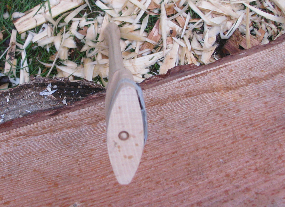

I did a little knob on the swell.
I fit the haft to the eye like I would a Jersey pattern axe.
Kinda weird, because of the shallow eye I had to cut the kerf deeper than the eye. I've never had to do that with an axe - not even a Hudson Bay.
I guess I should have used a wider wedge.
Hope you enjoy the photos.
Holy cow! You are talented, and patient. That's become a thing of beauty! I presume you would have had to re-temper the picks.
I posed that question on a blacksmithing forum a few years ago. Consensus was no, don't harden or temper picks. They're an impact tool and will crack or chip if hardened. Air hardening is good enough. I think you'd be fine hardening and then tempering back strongly - like 600°F.

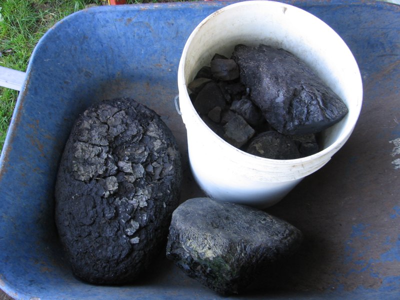

The coal ran out around here 50 years ago. These old coal picks aren't that common anymore. They're probably all over West Virginia. But I found this at a local yard sale and wanted it for posterity.
Funny thing, there are still a few lenses of coal at the surface in this area. They're not big enough for commercial mining but I'll sometimes collect the coal for my forge. If you're a fellow who spends a lot of time tromping around in the wilds then you notice these things. Sometimes I find big chunks in the river.

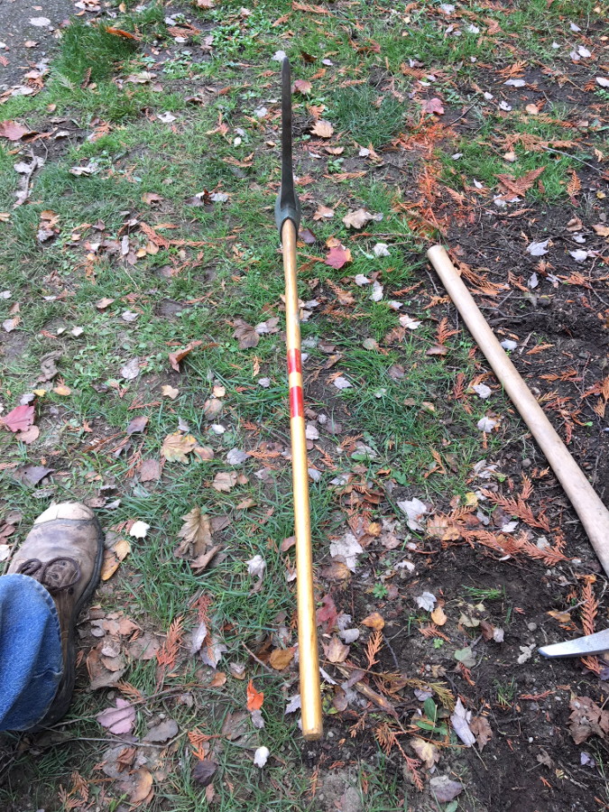

I took this pick out to a volunteer trail work party last Saturday. Because of the freezing weather we had a couple inches of frozen soil at the top. I let a young women use this pick and she absolutely fell in love with it. Nice light weight and slender haft. It's a pleasure to use. I used a heavier vintage pick that has also seen blacksmith repairs in its past.
Sorry - no 'at work' photos. But here's an 'at lunch' photo. The ground was thawed out at this sunny location.

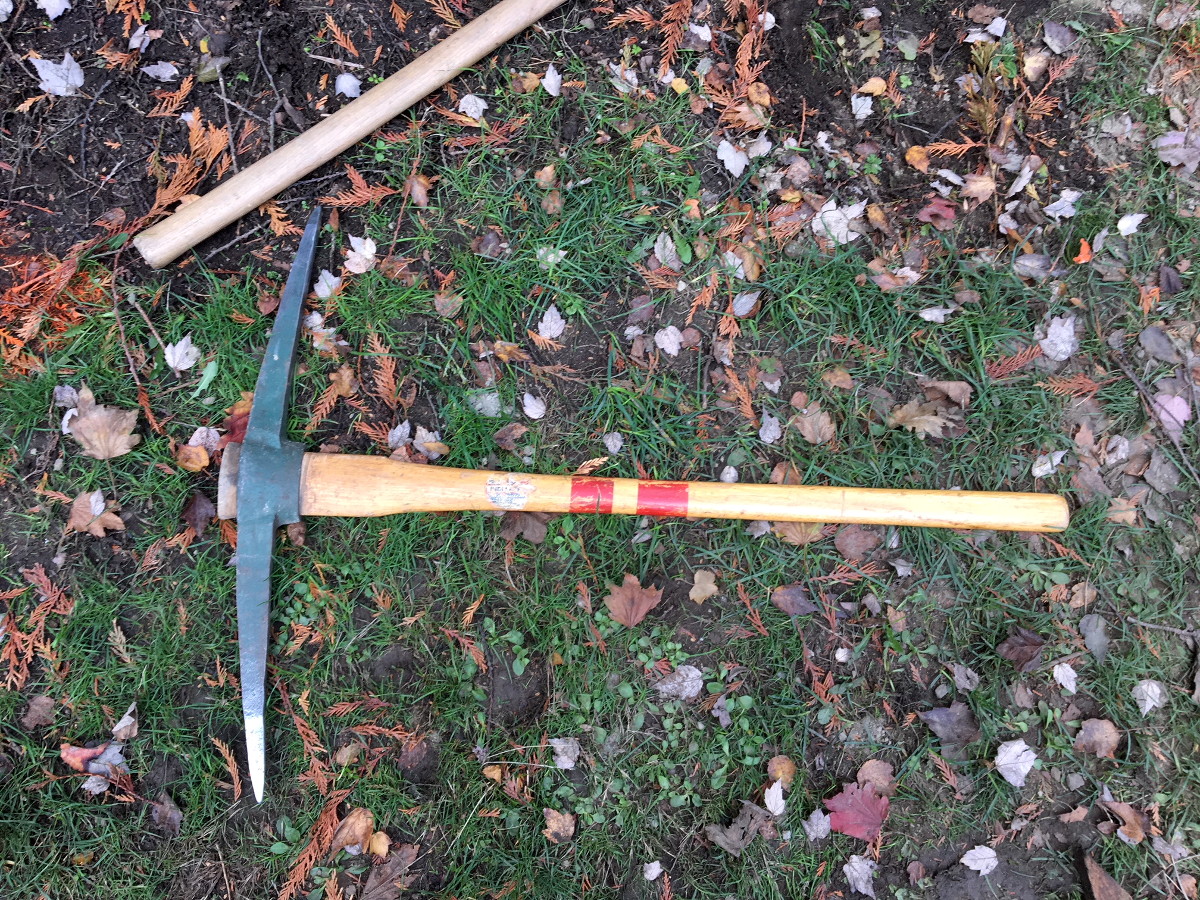

Here's the pick I used. You can see that a blacksmith added a new tip to this pick at some time in the past. This pick was made by Klein-Logan.

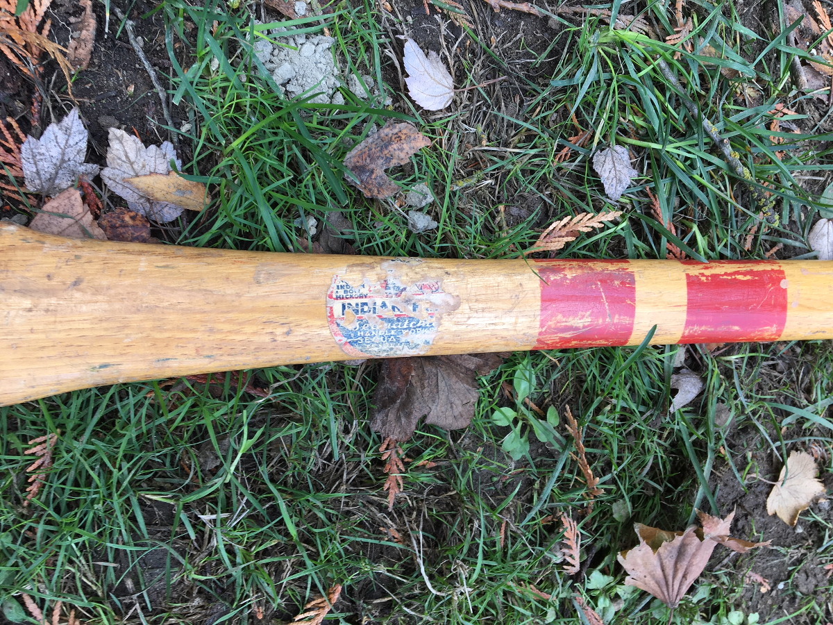

Classic narrow drift pick eye.
Indian Chief handle from the Sequatchie plant, Sequatchie, Tennessee, now owned by Seymour Manufacturing and still in operation as evidenced by this Google map.

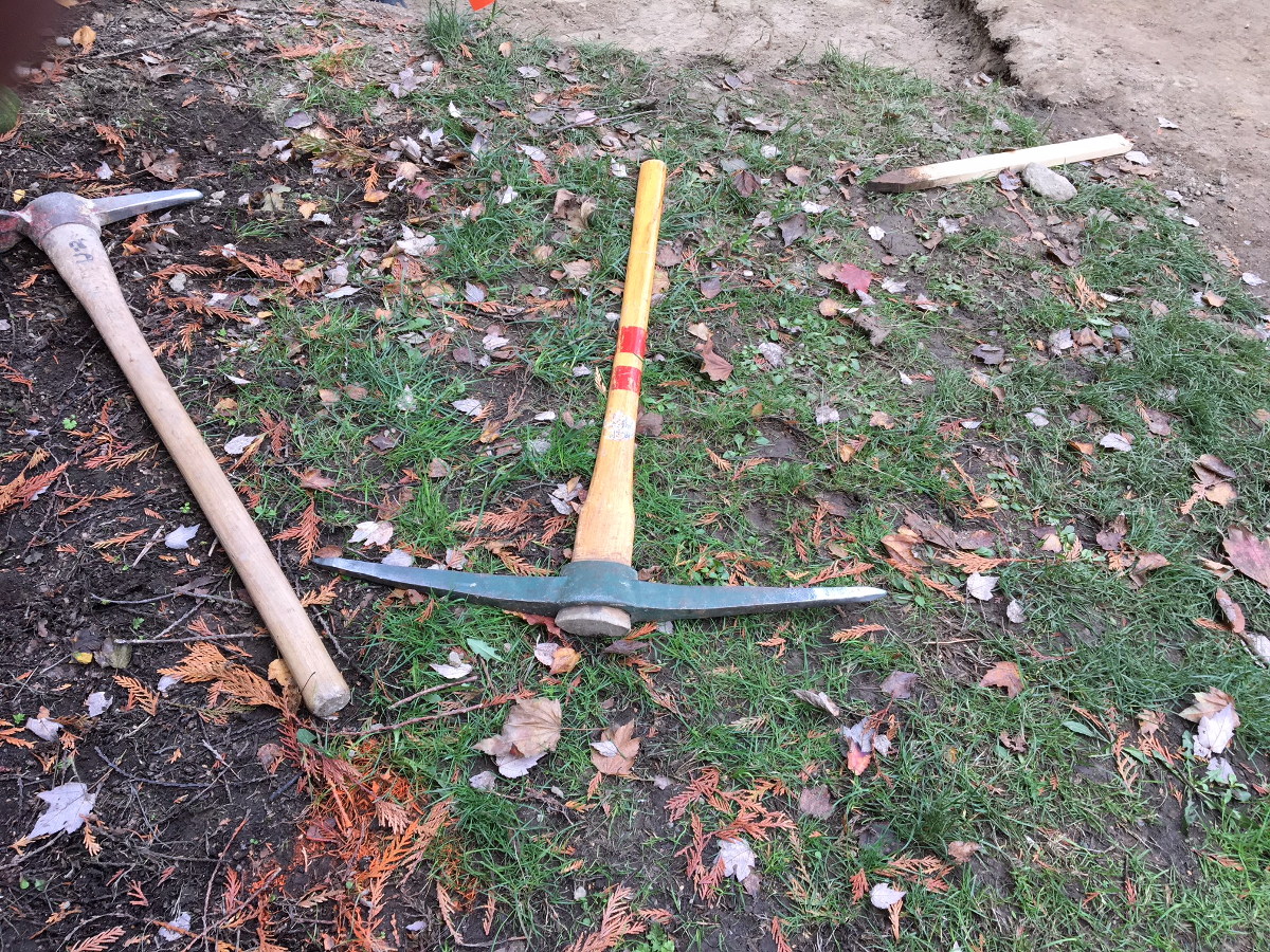

I'm classified as a carpenter and I'm not supposed to do pick diggin' work. But our laborers (classified utility workers) came out ill-prepared for the hard pan glacial till soil they found in this hole. They had come with only a badly worn pick mattock, worse than the one shown in that 2nd photo. The soil had a 4-6 inch duff layer that was dense with cedar roots. Their mattock was almost worthless in those roots. And below the duff was our famous 'natural concrete' glacial clay hard pan. Those boys got real down in the mouth about the work they had to do so I broke the rules and helped them do a little pick diggin'. But first I ran to the local hardware store and bought a railroad pick with nice long sharp points. What they had in stock was Vaughan striking tools which are now made in India. But the pick proved to be a decent tool.
They next day I brought a Hubbard cutter mattock from home and the boys had found this beautiful NOS Warren. I sent one of the laborers away that day, a big strong fella who would cry like a baby when he had to do any real work. Pity.

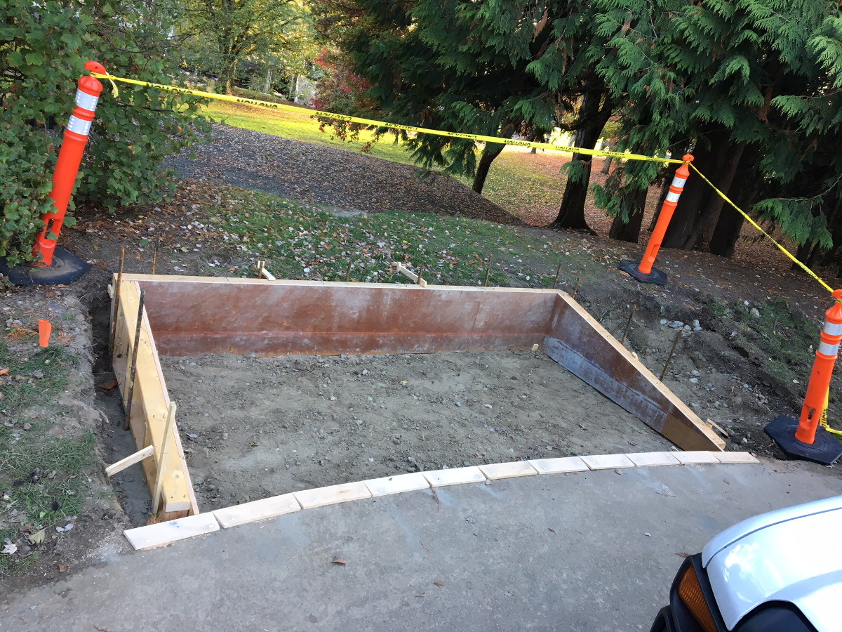

Anyway, we dug out this hole so I could set this form for the new concrete pad. I'll only pour up the the red line on the first pour and after that I'll set up an an inner wall to form a curb to hold back the soil. It saves time to form the outer wall for the slab and curb at once. And working for the county now I'm always conscious about spending taxpayer dollars, after all I'm a tax payer, too.
