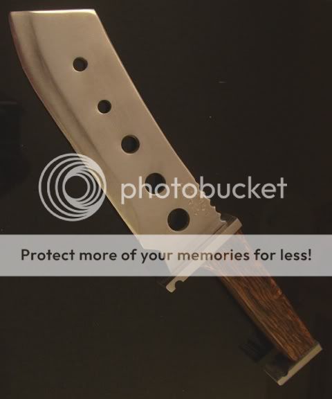

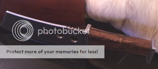

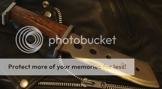

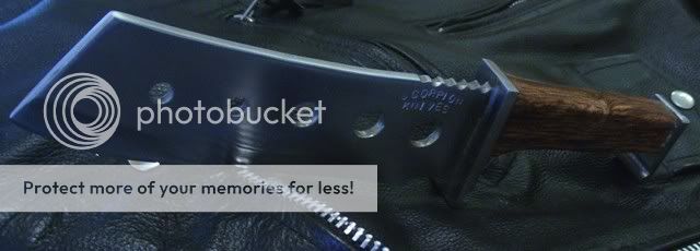

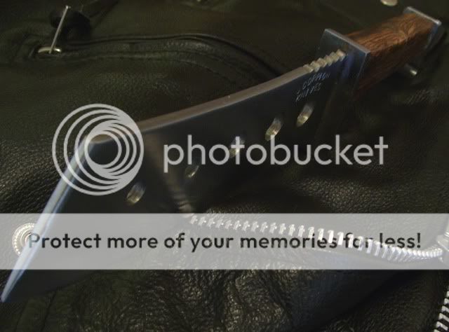

Heat Treatment:
Blade was cut out and Normalized @ 1500 degrees until non magnetic, three times, to remove stresses and align crystals. Heat Hardened to @ 1500 degrees, until blade became nonmagnetic, then quenched in 125 degree quality oil. Tempered the blade to a straw hardness @ 425 degrees for 1 hour, letting it air cool and repeating once more. Blade was file tested and is shown to be very hard.
Steel: 5160 Steel.
Finish: Fine satin finished.
Handle: Handle is made of Bocote with Cherry stain.

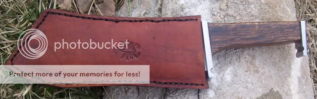

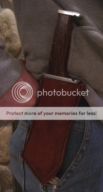

Sheath: Hand stitched leather sheath comes with knife.

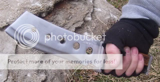

Measurements:
Tot Length: 11 ½”
Blade Length=7 1/8” Blade Width=2 1/8” Blade Thickness= 3/16"
Handle Length: 4 ½” Handle Width: 1 1/8"
Weight: 18 oz
Asking $165 (includes sheath) plus $12 shipping fee, if shipped in the US. You can send through Paypal to ScorpionBows@mchsi.com or mail M/O to our address (see web site for address).
Below are pictures of the finished knife.

You do some real off the wall designs bro, which may or may not be to everyones tastes, but that looks great. To me that's the best I have seen of yours so far and would be a great tool to have around camp !!!
