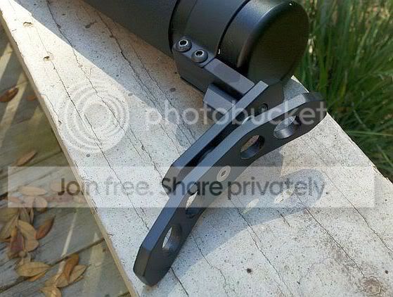

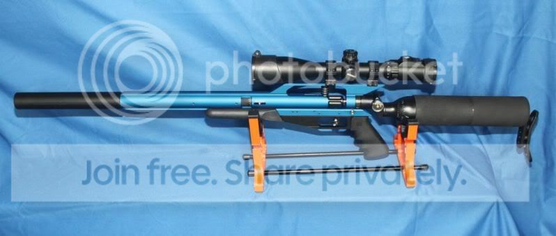

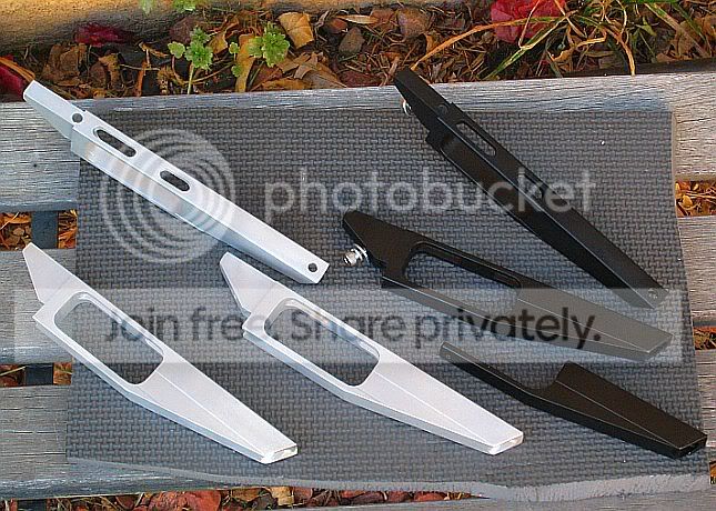

Here are some of the stuff I make on mine on a regular basis
And they are mostly for this type of high powered air rifle
The key of using the mini mill is tight tables and slow cuts with sharp cutters. People make some amazing things with these small machines. And a lot of knifemakers do use the mini mill for the kind of work we need done.
