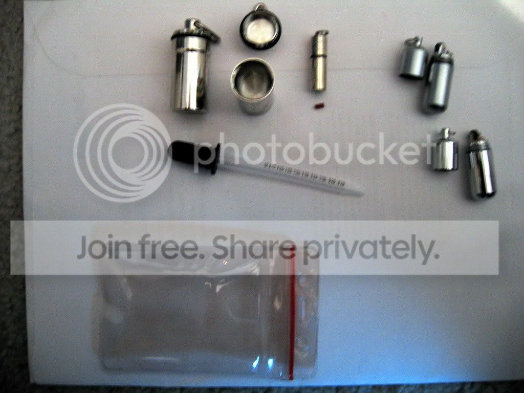

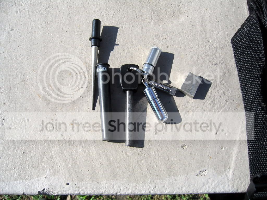

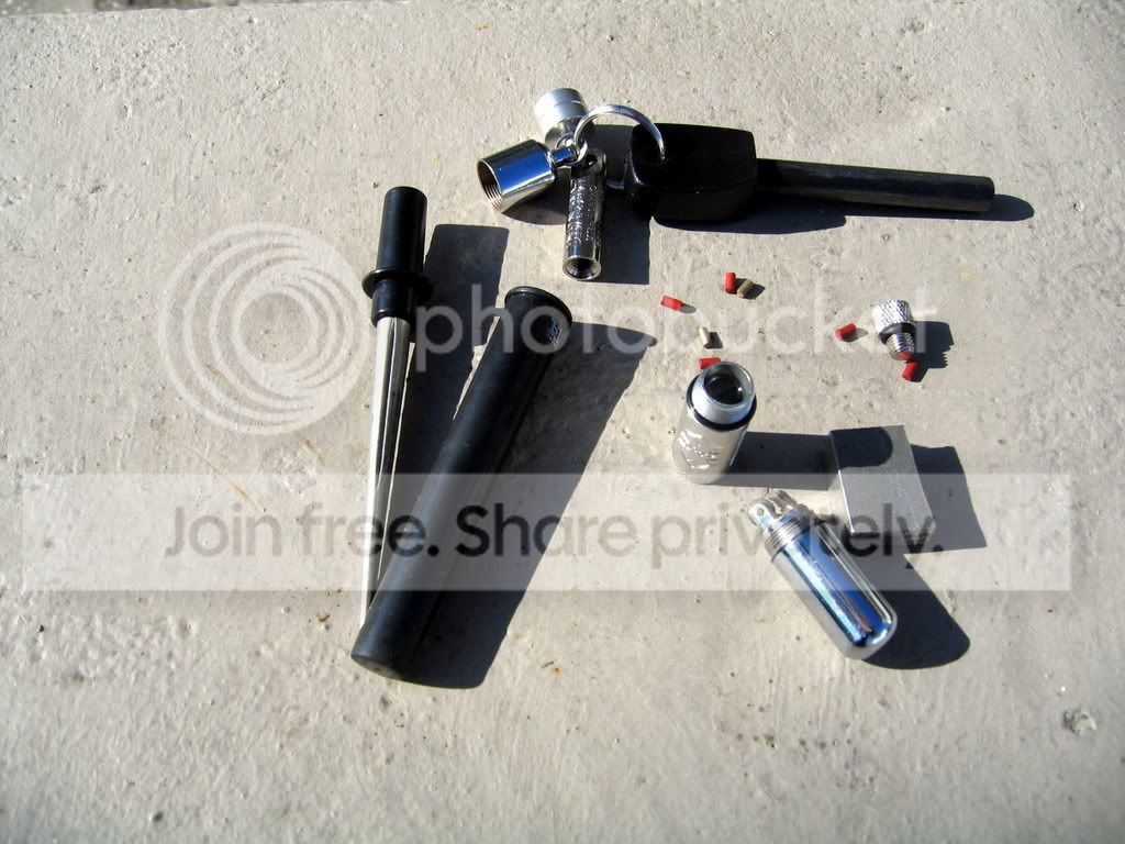

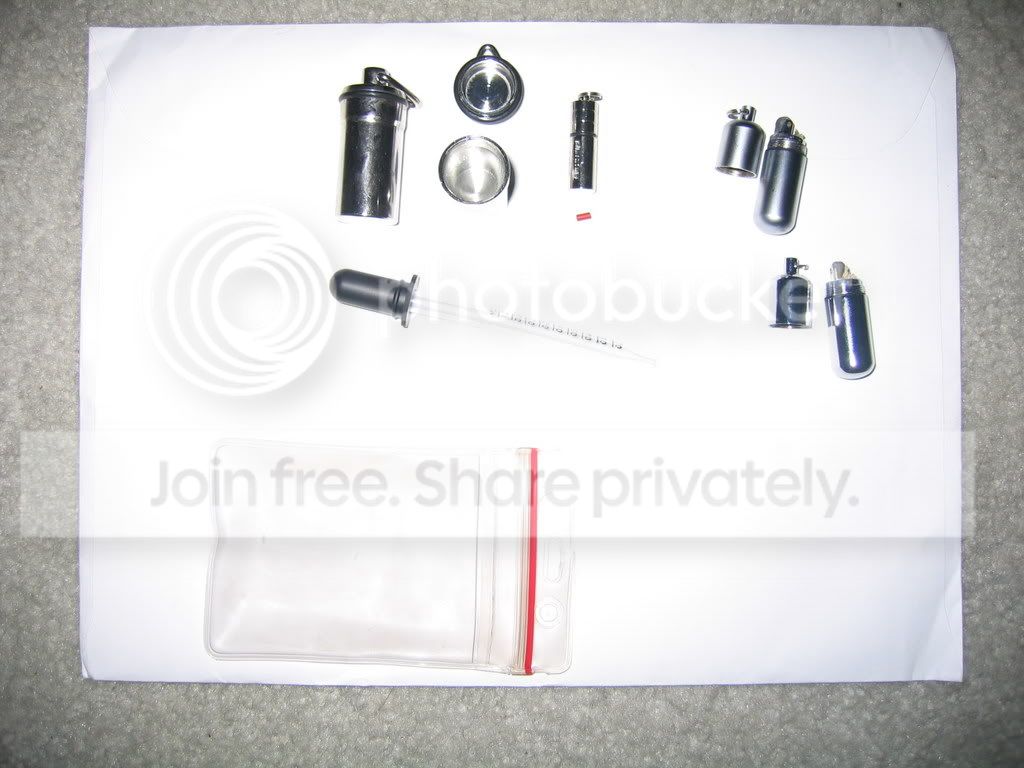

I have several of these lighters and have changed the wicks out with zippo wicks and also the flints to. Take a normal flint and if it goes in tight, take some sandpaper or a file from leatherman, swiss army knife or what have you and sand the sides down just a little and it fits in with no problem. All you need to totally rebuild this lighter is some hemostats. If you put in all zippo parts it made my flame really big, but burns more fuel.
Overall it's an awesome lighter that I highly recommend and it's been really durable and I had that extra one laying around that I experimented with zippo parts and have mod'ed 2 of them.

Gyro5000 - Thanks for the info on maintaining this lighter and the additional pictures. It looks like one of the two lighters you hace has a more of a brushed finish, as compared to the chromed finish on the one I have. BTW, where did you find those two metal capsules? They look useful.
