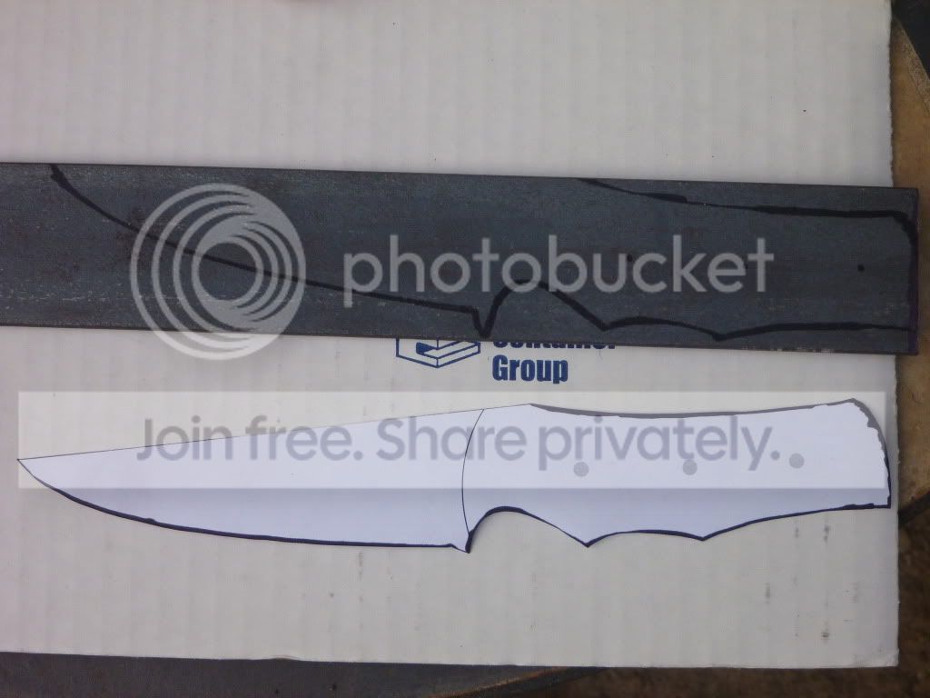

Alright. Just got everything. Got the pattern... tried to cut the steel, and failed. Will a normal hacksaw work? The blade's just skimming off of the metal. The steel is 1080 from Sheffields. Alright. Here's the pattern. Input? And I really need help cutting the steel.
Make a copy of the design in cardboard and hold it. does it feel good? if so, then keep it. if not, rework until it does. my only comment would be to get rid of the finger guard because it will be a pain to sand unless you have power tools. as far as cutting the steel goes, what tools do you have? are you the owner of an industrial machine shop, or are you a 13 year old student with a postage stamp for your back yard?
15. But close. I'm using a hacksaw on the steel. It's hotrolled... does that mean I need to anneal? And if I anneal... would it be enough to just anneal that certain area? I'm thinking of heating it until non-magnetic, and bury it in sand... would that work?
And yes, the design does feel pretty good. I'm just looking for advice from you guys so I don't end up making a bomb.
if it feels good, you really can't bomb. it doesn't matter how much anyone else hates it, if you like it, and you aren't planning on selling it, you are the only judge that matters.

I'm just going to try annealing it using sand and a fire tomorrow. I have 5 ft of this stuff, so it isn't that great a lost. Thanks for the help geek! :P

Update: Okay, not so sure I did it right, but right now, everything's buried under the sand. I dug a hole, lit a fire, heated the steel, and buried it all, with the fire. Figured it would keep the temperature more consistent. On the more negative side, I think I over heated it. The fire wasn't getting hot enough, so after 30 minutes, I found a piece of cardboard and just kept waving it. After another few minutes, I brought out the steel, and it was a pretty bright red. I think closer to orange. Overheating won't matter right now, will it? And how would I normalize?
going by color will get you in trouble until you are very experienced. it is a better idea to get a telescoping magnet from harbor freight and just check with that. it is the only way to do it accurately.
Oh woops. I did use a magnet. And it was non-magnetic. But I'm afraid i went over because the color looks too bright to my oh-so-very experienced eyes.
EDIT: I took it out, around 2 hours later, and it was just slightly warm. I'm straightening it right now using two clamps and a flat surface, because the steel got bent during the burying in the sand part. The problem is, I'm not sure if I did the annealing right. The file feels like it's skating, but then again, I can't really tell. The hacksaw still won't cut, but the hacksaw is just a normal wooden one. The steel is easily bent though, compared with the other pieces I've received.
Edit Edit: It cuts. Very very slowly and painfully. I tried to drill holes for a connect-the-dots, and this is where something odd happened. The steel would drill fine in certain places, and in others, was almost as though it was hardened. Also, these places were usually halfway into drilling, or right next to another hole. Is it that the heat from the drill is causing something weird? Or is it something else? I really don't see how this is going to be cut out. I'm going to head out to Home Depot for a better saw though. That's for sure.
