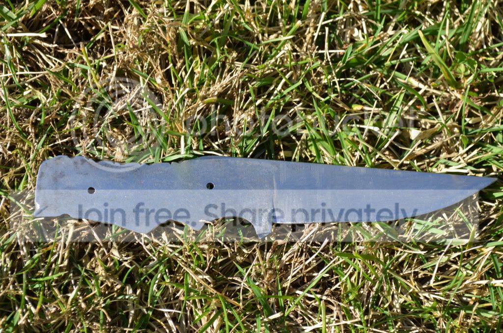

Thanks for all the suggestions. My goal is to try to make this knife as cheaply as possible. Not that I'm a cheapskate, but a forge is easily over $100, and I just don't have that money to spend. Maybe I'll upgrade my tools later on, but for now, I know my results won't be that great, but others have done it before, and I believe I should be able to. I haven't spent over $10 yet(on tools), and I'd like to keep it that way. Here's the picture so far, and the shadows make it look like there's cracks and such. I brought it to 220 grit, will I have to go further? Does it help with the heat treat? Because I'll just have to sand it again afterwards right?
Okay, if all's well, I am just going to go and see how it does. Trial by fire right? I plan on normalizing three times, once for abit above non magnetic, once right at non magnetic, and once under it, at around a dull red color. Then, bring to non magnetic, heat another minute, see if table salt melts on it, heat for 30 seconds more, and into canola oil at around 100 degrees f. Let it cool a bit, and straight to temper in a small oven at 415 degrees. Would that work?

A file will cut a bit. However, it is less than stellar. If you have benchstones, that would be my first suggestion. if not, then my suggested method would be a mousepad and sandpaper to put on a convex edge. Just search for that on google to see some suggestions.

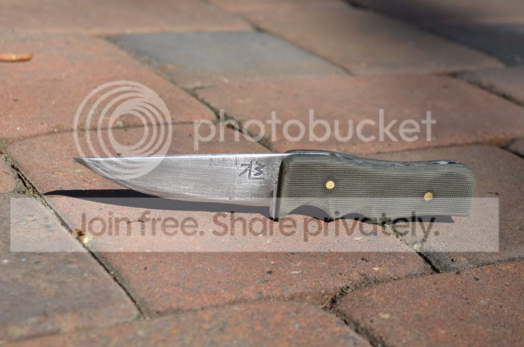

Almost. Handles are cut to shape, but they're very nice and blocky right now.

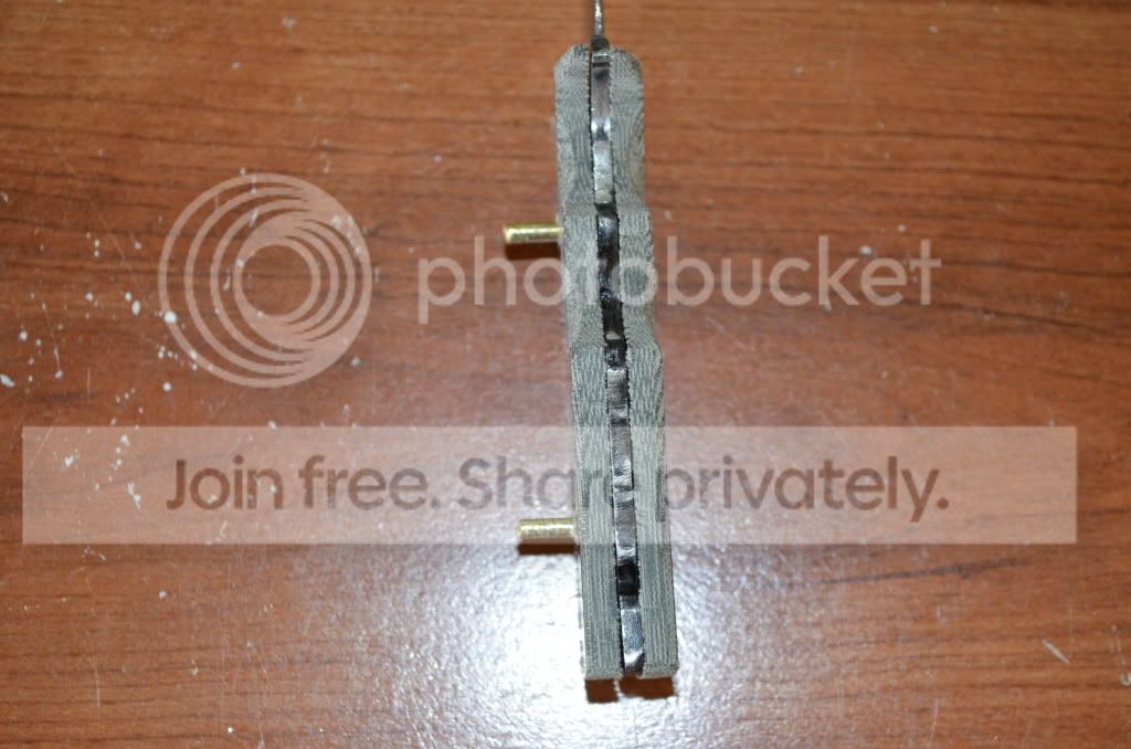

I'm thinking of peening these pins. So just leave 1/16th sticking out on both sides, and tap tap tap? I've read that you should drill down and widen the hole a bit, so the pins sink in, but I can't find how deep to drill. The pins are 1/8 across.
Hey guys, I just wanted to say thanks for helping me on this knife. I'm truly grateful, and apologize for any stress caused by my clumsy efforts to attempt a knife. Thanks a lot.
