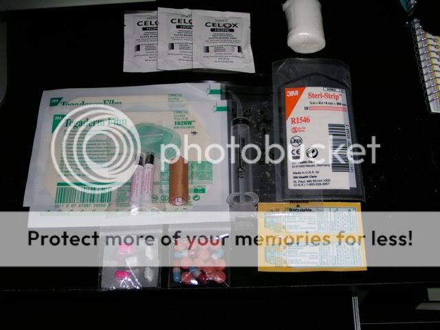

good tips throughout :) I'd second (or third) tweezers, SAK one will do the trick, the US issue one is even better
I keep a small med pouch w/ immodium, advil, tylenol and benadryl- how much determined by trip length
a good irrigator is important in the backcountry- a corner cut out of a ziplock does in a pinch, but a small 12 cc irrigator takes up very little room
small roll of gauze, a couple of tegaderms, steri-strips, triple antibiotic, a few celox and a blister kit
my small repair kit carries a few items that can double over into FAK items- duct tape, safety pins, needle, super glue
I could fit two of my kits in a Cacoon pretty easy
I just try to bring the things that aren't readily found in nature or rigged from existing kit.
