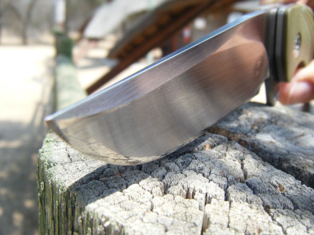

I'll try to sharpen something up and take pictures.

Mine is 30 years old. Because it's not "current" doesn't mean it doesn't work. After 30+ years of use there is no visible wear on the stone, and it works VERY well. Try that with waterstones!
Probably the reason they aren't widely used is bacause they were extremely expensive years ago, before it was common to spend big money on sharpening stones.
