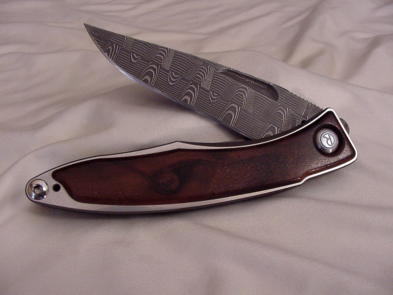

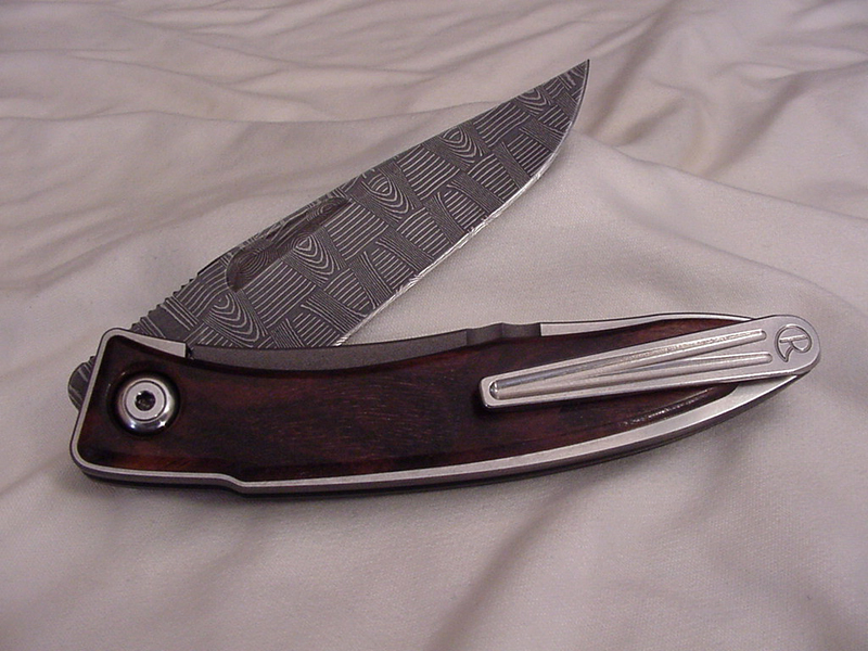

My basket weave Mnandi blade project. Just recently I had a basket weave blade installed on my walnut Mnandi. Unlike the basket weave blades on two of my other Mnandi's, the pattern on the walnut was a little too bright and "washed" out for my taste. I decided to etch/darken the blade. Through some trial and error, below is the end result, and process used. Instead of boring you with the processes that failed, I'll only post what I perceive as the successful result.
I used ferric chloride purchased from Radio Shack. Instead of cutting it with distilled water, I used it full strength, as I believe it's already "cut" in the bottle. This is an important part..... You must clean the blade very well with Acetone. Use gloves to make sure the blade is free of any oils, else-wise it won't etch evenly. I submerged the blade in the solution for a few minutes (3-4), flipping it a couple of times. I then rinsed it off with cool tap water, followed by Windex to make sure all of the etch was neutralized. They key for contrast was polishing the high parts. I can't even begin to tell you this was the most frustrating part. After several trial and errors with different grit papers and Scotch Brite, I discovered the most effective method. I used emery compound on a flannel cloth, and hand (index finger) buffed the high spots with the blade laying flat on a desk. Another benefit of doing this was all of the chalky feeling of the new etch was removed. The blade feels smooth, but at the same time you can feel the pattern as well. I could have continued polishing the high spots to a more bright finish, but I was more than satisfied with the early results.
Notice the polished portion (as found on the newer Damascus) of the pivot area and blade tang are gone. And I again enjoy the gritty feeling of opening and closing a Damscus blade.
The only down side is the need to strop out the edge to a bright finish again.
new_walnut_a by accutronman, on Flickr
new_walnut_b by accutronman, on Flickr
