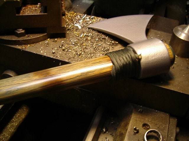

Hi all,
Just a few pics to check out. I would have put it in the 'Trailhawk' thread but umm... it's not one.:D
Here is a shot of the factory stock hawk:
After a bit of filing, sanding, boiling, grinding, and staining, I ended up with:

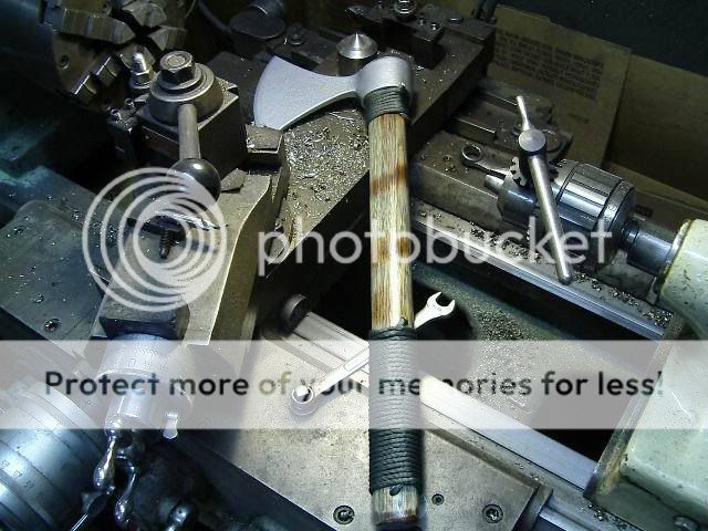

Not bad, but I figured it could be considerably better. After using 4 different power tools, 1 stain, 1 glue, 1 epoxy, and 5 clamps, I ended up with this laminated handle:
There it is. Now I should be working on a sheath of some type for it, but I can't decide what I want. New handle is 22" long, rather than the 19, and doesn't stick out the top 1 1/2". Just cut a 3 1/2" spruce a couple times, and everything seems good. Unfortunately, I keep hearing this faint voice asking me to get a Trailhawk to keep this one company.:eek:
ETA: Kind of funny, but looking at the pictures, you can see it took quite a while. Look at the shadows track in the first two, and it is dusk in the last one.:)

So far I cut through a 3.5" frozen spruce twice, and haven't had a problem. I haven't done much else yet. I was excited about the extra handle length, thinking that it would be nice for two hands as well.
For one hand it is quite good, holding it partway up. For two hands, it doesn't seem much better, as the penetration gets to be too deep, and you waste your energy pulling the hawk out. It might be better in harder woods. I hope to do some more playing around soon, not only to test the laminate handle, but also the epoxied head. I fit the head, then epoxied it. I am unsure how that will do, but should know soon enough.

Here is one I pimped out a while back.
Do all lathes look that much alike? I would swear i have worked on that exact one.
Would you mind posting a howto or links to making your own laminate tomahawk haft? Google wasn't much help.
That's a definite maybe. The short answer is, buy some nice maple or hickory 1x4, glue it up w/ woodglue and clamp it good to sit overnight. Then use a tablesaw and a belt sander to take away what doesn't belong. I only did it because I had a piece of wood I really wanted to use that was too thin to make a handle with. It might be nice to do some contrasting colors or something. Just try to keep the glue joints lined up like wood grain should be in an axe handle.
I may do another longer one. If I do, I might try to do a tutorial on it. I don't know how it will hold up, it has been fine so far, but I have only used it a bit. I am not really expecting any problems. I hope not anyway, as the handle took me close to 5 hours to build. I am hoping the next one goes considerably quicker.

Make sure you post what you end up with. The only suggestion would be to cut the top too large. On mine, the taper is heavier in the head than the taper on the handle, so even though the bottom of the head is tight, there is a slight gap on the top. I ended up epoxying it and driving the handle in w/ a heavy hammer. If you leave a bit more material on top, you wouldn't neccessarily have to epoxy it.
