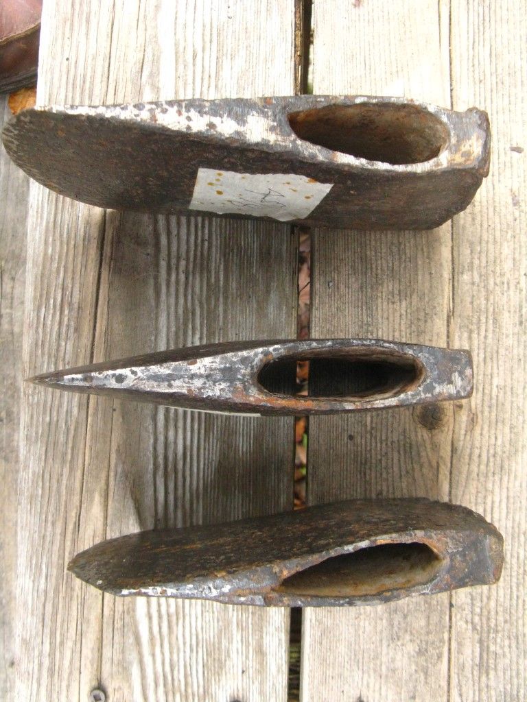

Another example in the middle of the photo below (also posted by 300Six) was stamped with a different maker's name but shows a similar high centerline:
These heads both resemble the profile drawing of an "American axe" that appeared in an old book, the first edition of which was published in 1863 (before translation from German to English):
