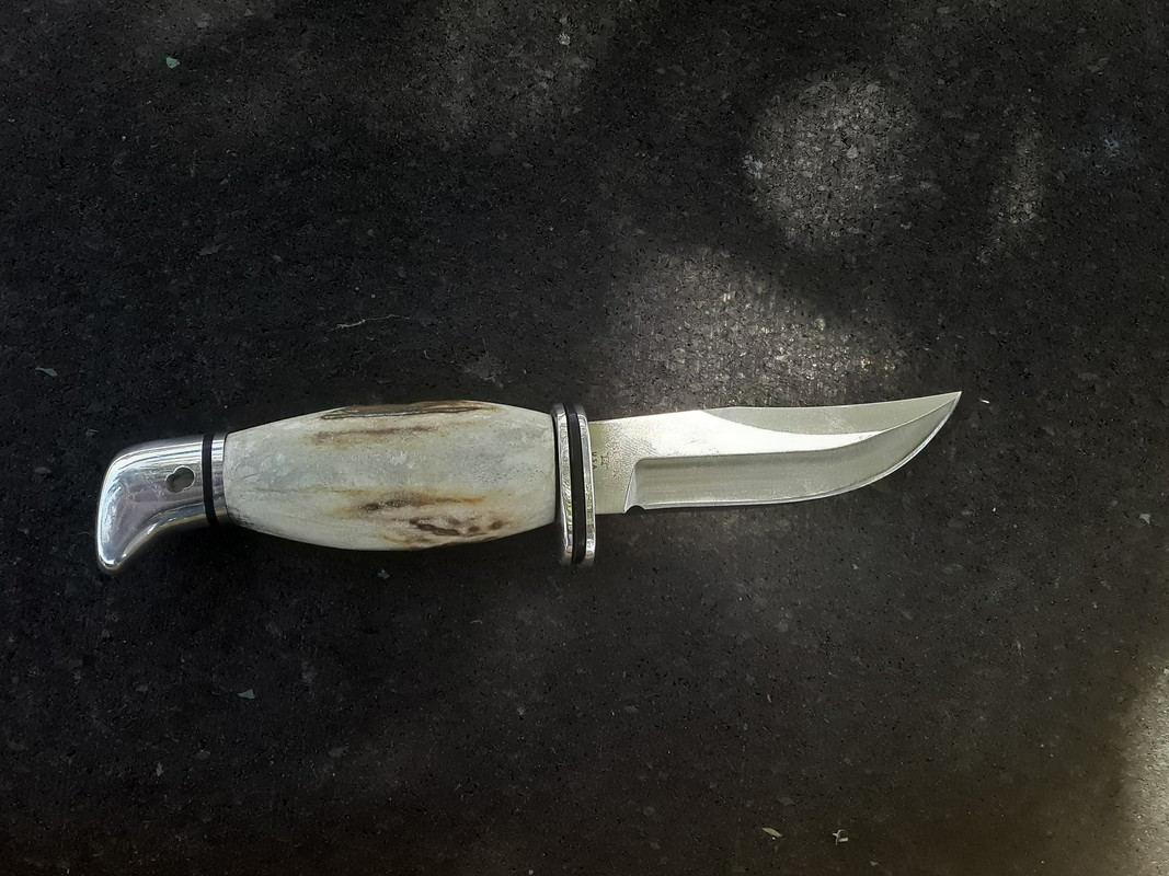

I'm thinking of something like this, but theres only so much material I can take off this piece of stag so I may have buy some mor and go with a smaller piece.
I just do not want a fat handle on this smaller blade, ideal a 102 woodsman handle would be perfect.

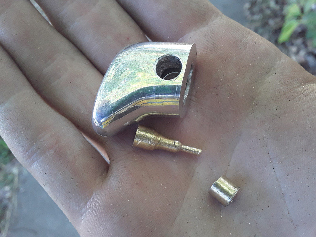

Theres also the issue with the pommel where I messed up drilling out the pin.
I could not actually see it and well you can see that what drilled was not centered on the pin.
Other side went fine of course because I just punched it out.

looking good there but like ya said fat again. yeah thinner piece ain't a bad idear. how ya gonna deal with the end cap pommel issue. what's your plans, curious?
is the tang stock same size on 212 as the 102? find a broken blade 102 cheap maybe on ebay and do a swap over parts and all?
I don't know what I'm gonna do with the pommel, probably pin it and pour in a little aluminum to fill in that gap.

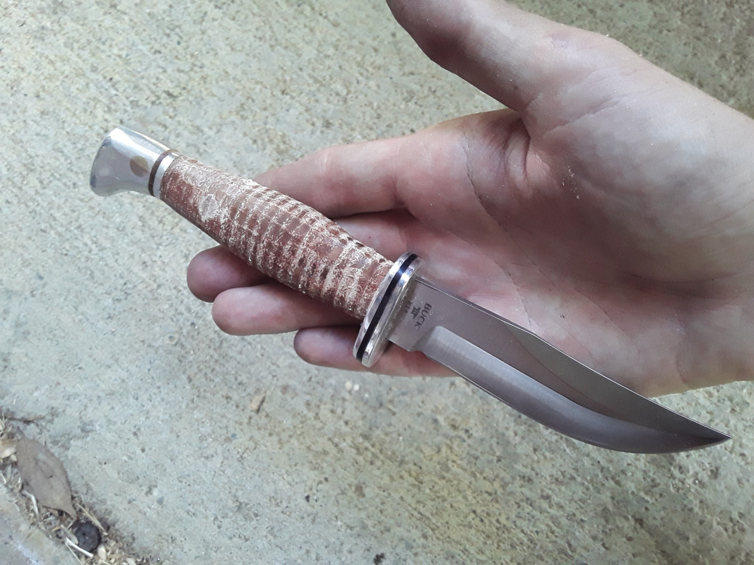

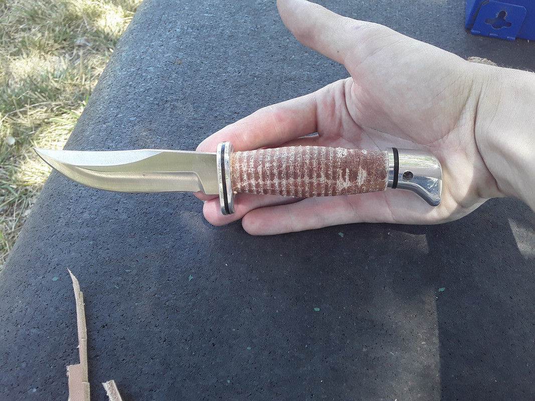

I've decided to go with stacked leather.
I might have to remake a few of the washers due to a few low spots but I really love the size and shape.

gotcha. looks real good with stacked leather...really digging it.
yeah that could work, the aluminum idear. maybe. not sure how it would hold up though. yep, make your own like ya said. that would be kinda cool and unique.
regardless its turning out real nice.
If I poured the aluminum in just to mould it but actually glue it in place this could work.
I could also possibly drill it out and put in an insert.
There are a number of ideas I can do, but I will definitely try making a stag pommel if I've got a big enough piece.
