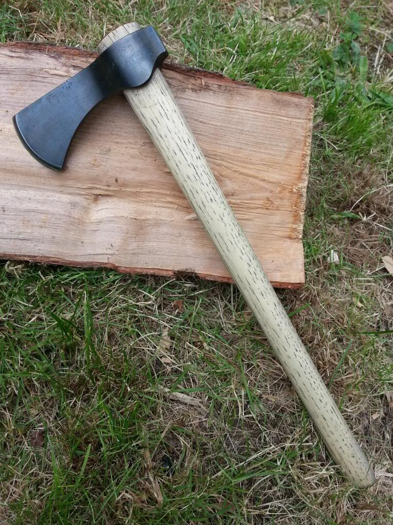

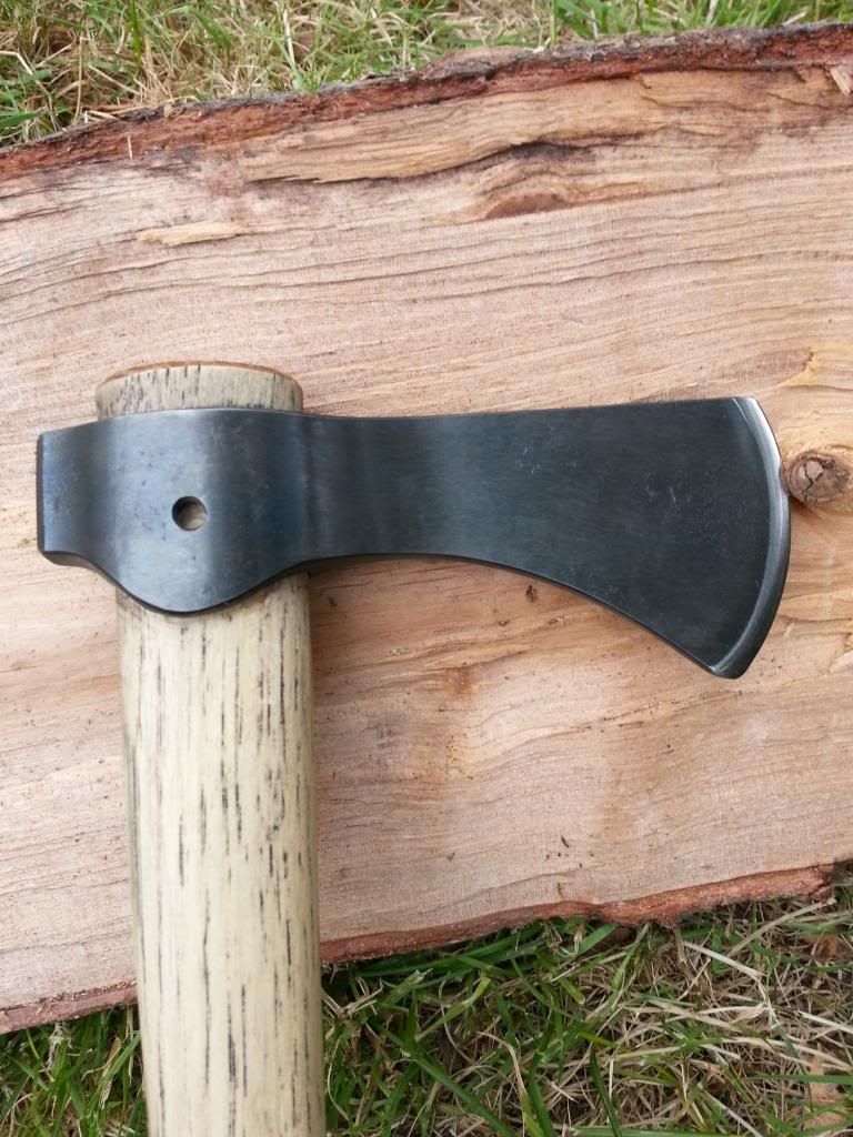

I used a Dermel, it matches the stock on my Mossy 500. The head was given a good vinegar bath then when staining the haft I put some on the head I doubt it will last long but it does look good. Thank for the compliments.

The grip "stipple" is just the one inch wheel on the KMG and get after it. Takes about....3 minutes. Wave on the spine is the same 1 inch wheel. Ferric chloride etch for the Noveske cross, dremel for the Compass Rose, cold blue for the finish and the flat platen with a fine grit belt to do the polished facets on both ends of the handle. Then burn it and stain it. All the same stuff everybody else is doing, really - it's VERY FUN! :-)
Oh, and the shovel I had sand-blasted, which got rid of the black paint AND gave it a nice texture. Kinda cheated there, didn't have to strip the paint off!

Great hawks everyone! I just got a CS Pipe Hawk and am going to do some mods on it. One thing I am going to do to fill the set screw hole is grind the point off the screw, Super-glue it in with enough of it sticking out to grind the hex out so it is flush to the head.

How do you intend to get the head off once the handle breaks?

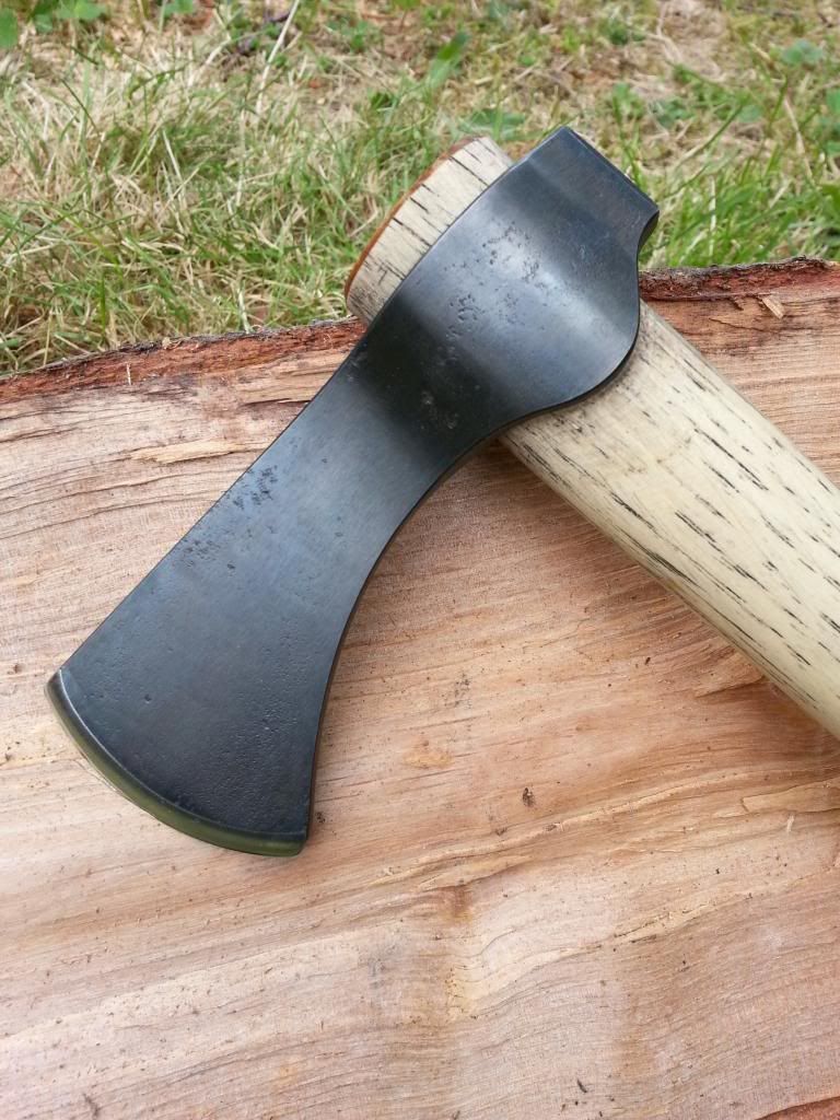

Wow, that head is beautiful. What tools did you use to get it to there? Also what tools/process did you use to get the nice mirror finish?
I used an angle grinder to cut the spike and remove the forging marks with a flap disc. I also used a handheld belt sander that I upturn and use like a punished! I use that for flattening the poll and a few finer bits on the edge as it came with lots of belts. I did a hit of hand finishing with some medium grit sand paper to remove some spiral scratchs left from the flap disc then had a go with some really cheap eBay buffing wheels!
If you want to start modding I would say he an angle grinder first! Best tool for a man on a budget as it can do everything! Just buy a fewdifferent dicsand you're set!
