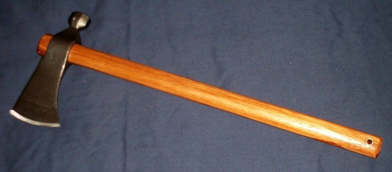

first cold steel tomahawk and first mod...I'm pretty happy with the way it came out.
Finished up the trail hawk for my neighbors son. Sure didn't take long to mod. Removed the set screw, stripped the head, ground the eye socket, sanded the handle, gave it some slight burn marks, a light coat of red mahogany stain, and a coat of danish oil. Only took a few hours. Crappy indoor photos. The lighting makes it look lighter than it really is:

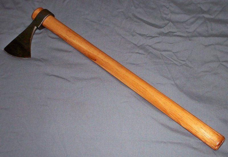

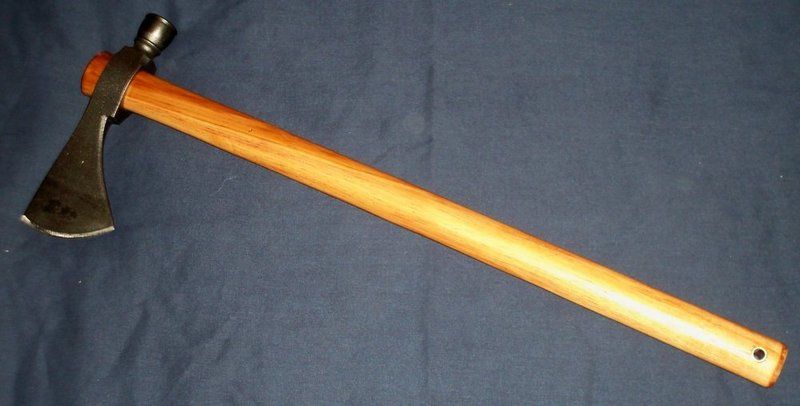

Okay folks, so I've officially joined the club. Here's my Frontier Hawk, and what I did to it.
My skills at applying stain evenly over the length of the handle are abysmal. Two coats and neither one of them turned out any good, regardless of how many times I passed over them.
That is an attribute of wood grain, it's God's copyright, no two are ever alike.
They look great from here! :D

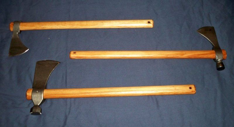

Alright everyone. It's time for pictures!

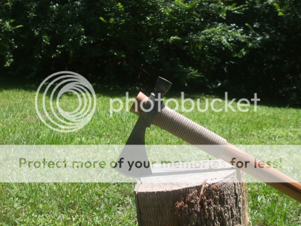

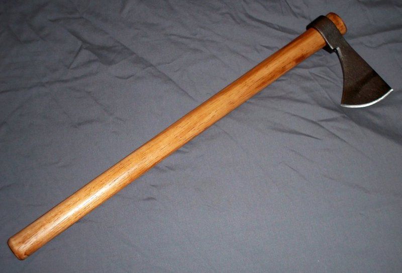

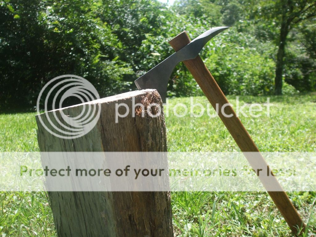

I started off my restaining the handle on the frontier hawk.
It took some damage when chopping down a tree, because I missed the concrete just under the dirt.
Next is my favorite so far, the pipe hawk.

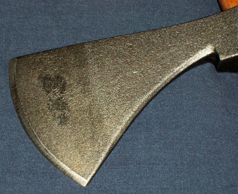

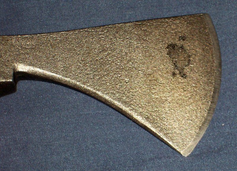

I don't know what this is, but this stain is on both sides of the hawk in the same place, and it withstood three applications of paint stripper.

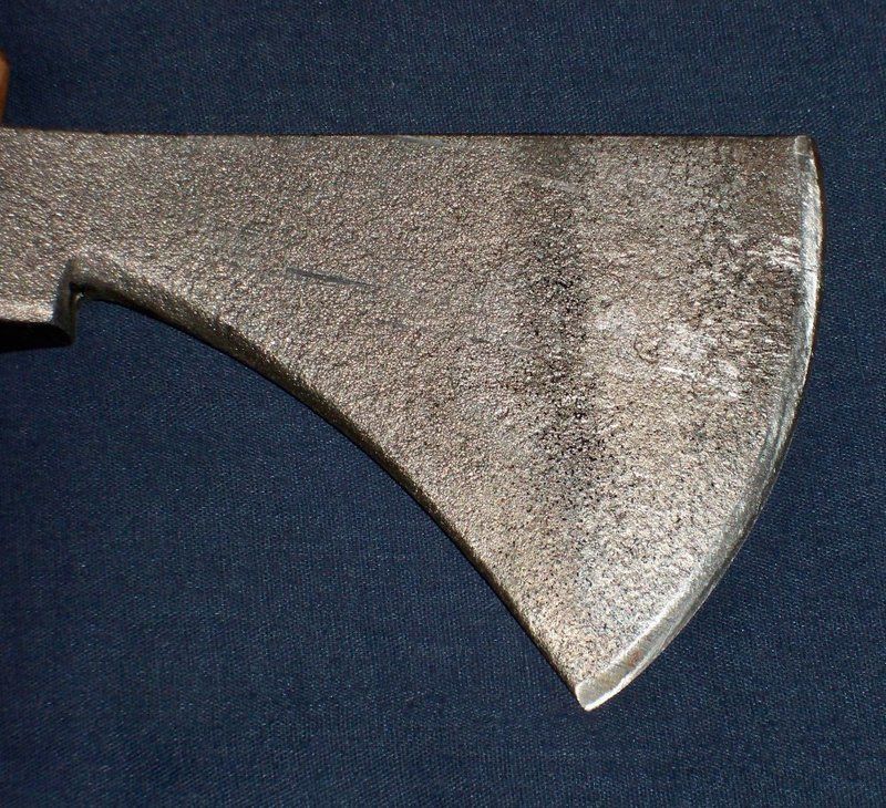

And now the rifleman hawk.
All three together.

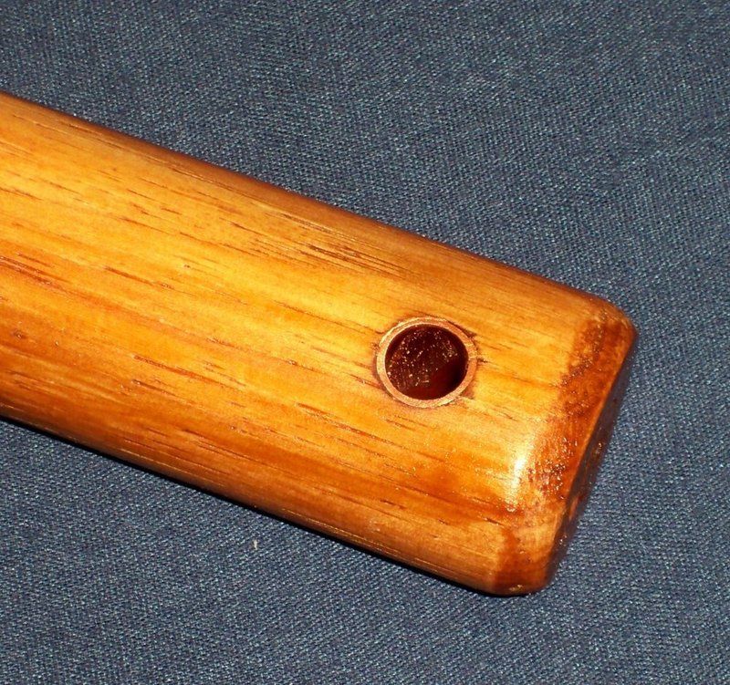

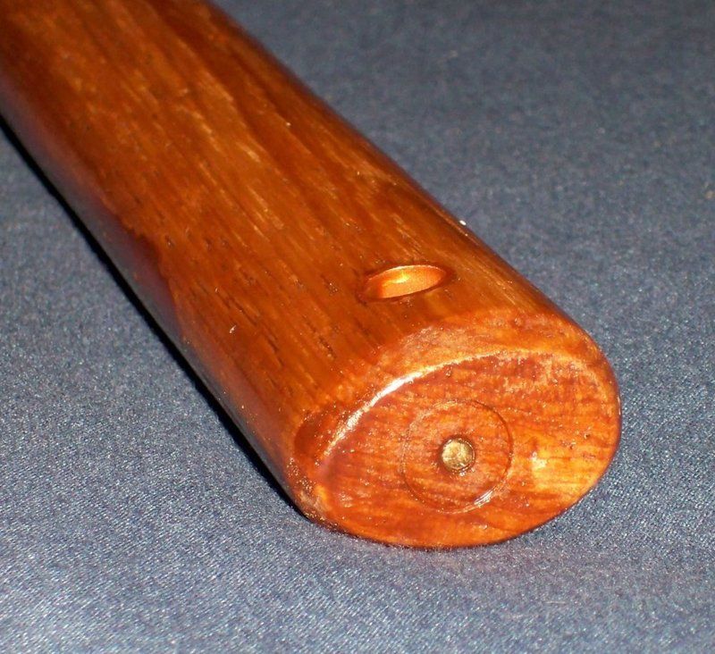

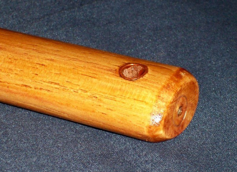

And some close ups of the handle work I've done.
I'm particularly proud of the inserts. I cut 3/8" OD copper pipe, polished it, sanded it, filed it, contoured it to the curves of the handle, reamed out the edges, and swaged the ends for a good solid fit.

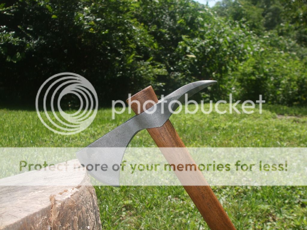

The Spike hawk. Stripped the head (It still has some darker spots....kinda like them too!) Vinegar patina. sanded the handle for fit and stained it in walnut and BLO.

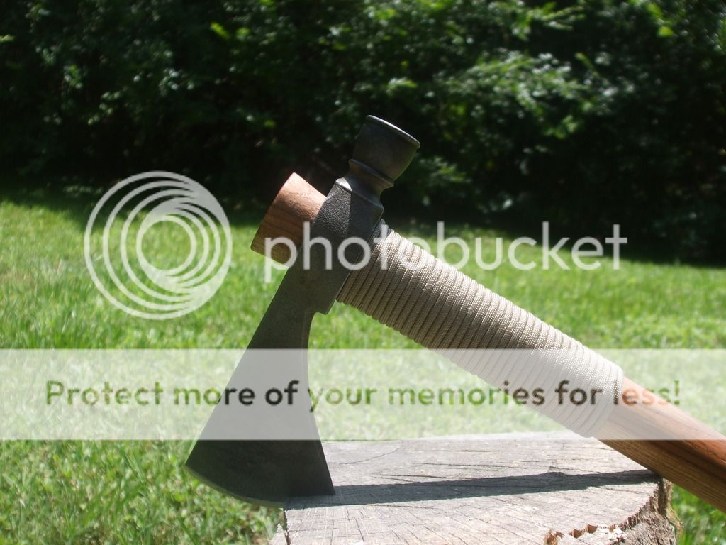

This one is the CS Pipe hawk. Just stripped the head and tried to patina with mustard and vinegar. Wish it had come out better. Sanded the handle and, since the hickory had a dark "stripe" that I liked I just used BLO on it. Also tried my hand at wrapping for the first time as well.

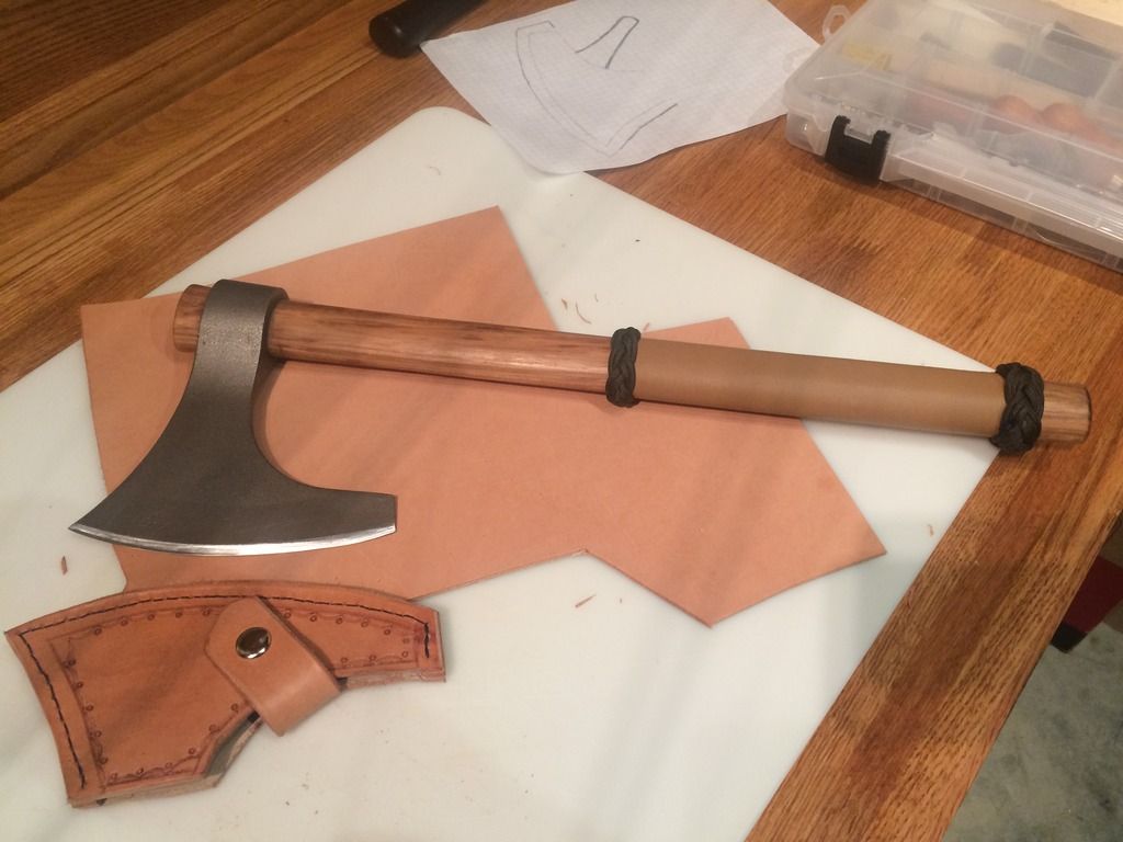

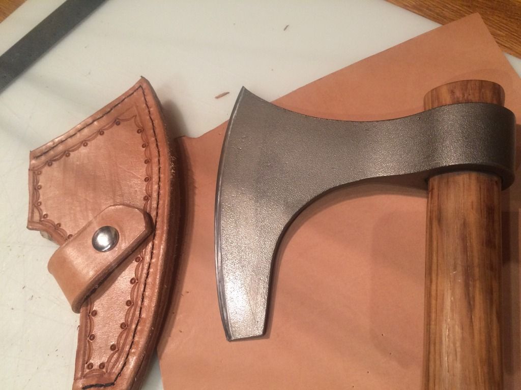

Cold Steel viking hand axe, which I mounted on a shorter hickory hawk handle finished with Tung oil. Deer skin grip with a couple turks heads knots
The blade came pretty dull but has gotten to a almost hair popping edge with a little elbow grease.
