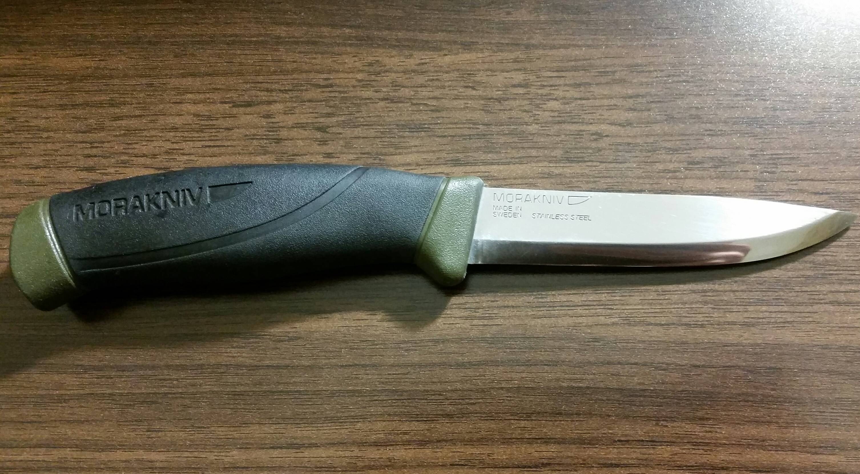

Just got one of these (Bahco 2444) for $ 9.07. It's just a rebranded stainless Companion and the best deal on a Mora made knife, ever !
