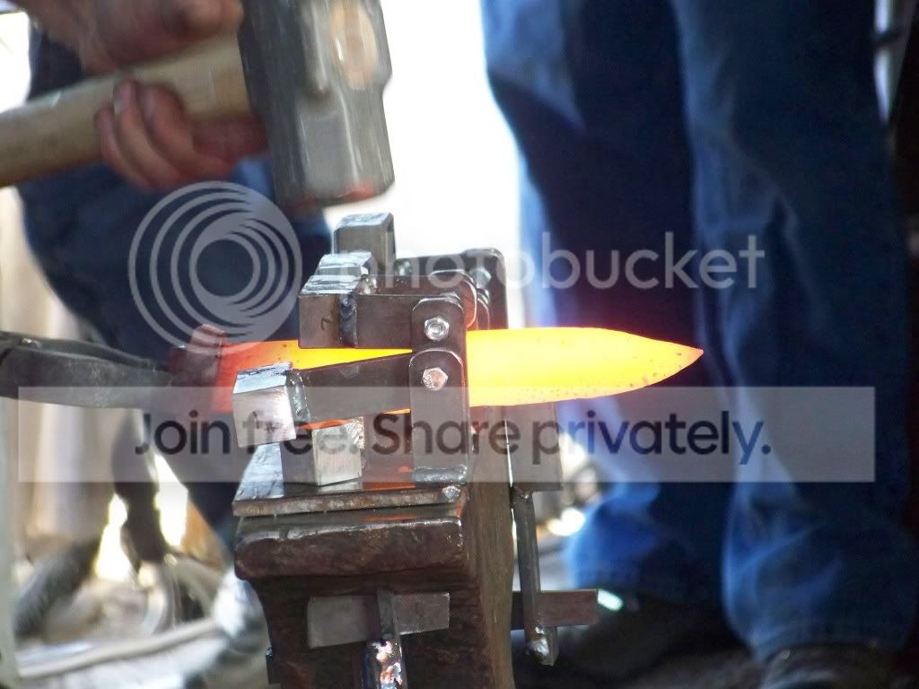

Tim Hancock made this for the demo he did at the Big Sky Hammer-in this summer. Its pretty slick.

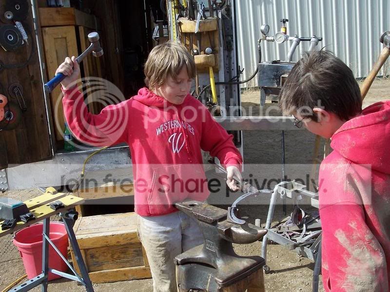

Here are a couple of the local kids using a 1/4" tongs on over-1/4" stock, if you will notice the gap, but there getting it done.

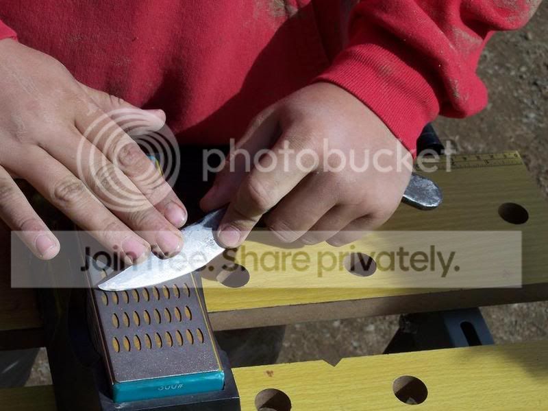

Here is a knife they made out of a used horseshoe (mild steel) works very easy,,,,,and will cut a twine off a hay-bale, priceless!

hope that picture was staged, cuz otherwise it is a shame that the boy has no eye protection on. He is a little young to make that kind of decision himself,,,
