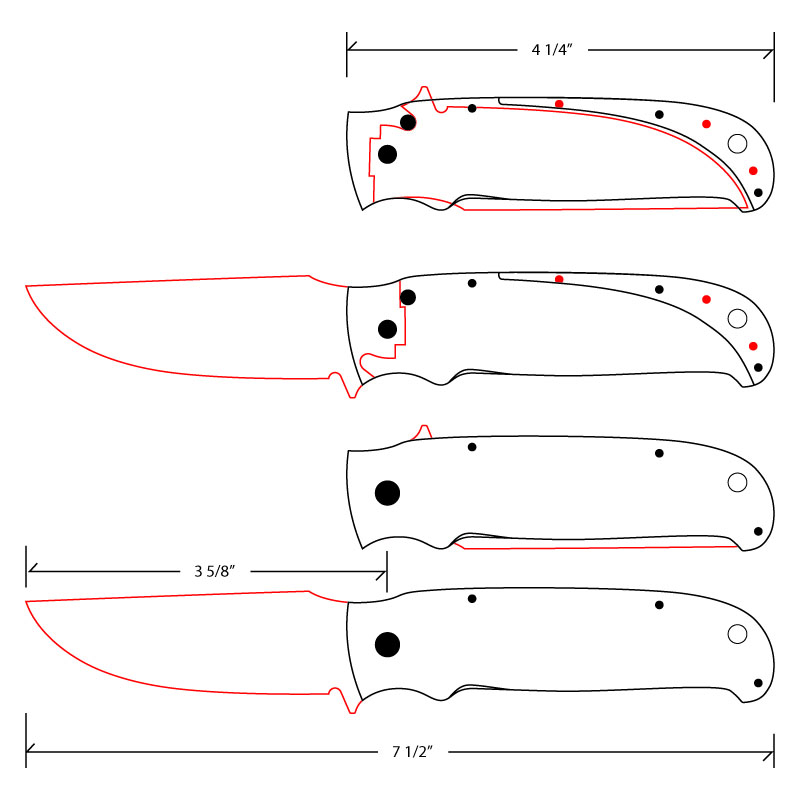

Well I finally had the time to update my drawing of the knife in question. Let me if I need to change anything.
I believe it will work, but I see where a better folder action can be made if you can move the flipper more forward when in the closed position. Yes that could mean a huge design change. So perhaps just stay where you are for the first.
Frank
Thanks for the input. This is my first attempt at a folder, obviously. To add to my difficulties I have a friend/neighbor that owns a custom automotive shop that wants a custom folder. He wanted 10 of them for the Christmas season. Would be great order but in October it was a little late to be building a new shop, designing a new knife and assembling 10 folders. One of his must haves is a flipper which has added a complication for my first design. He also wants it to be an assisted opening, I will tackle that at a later date.
So my hope is to develop my folding skinner and use that same action in his custom folder as well as in a more tactical folder which I would carry as my EDC.
I'm going to print this out and create wood pattern to handle and see how I like it. I'll post my findings.
Your process of preparation appears to be correct in that it is very methodical. This going ahead with the wood pattern is an great way to go on especially your first pattern. I believe you will find it to be oversized in width. You can slim it down some and still end up with a good design for a skinner.
Frank
