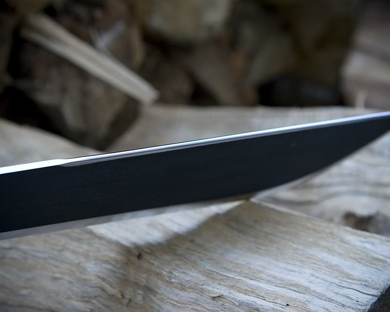

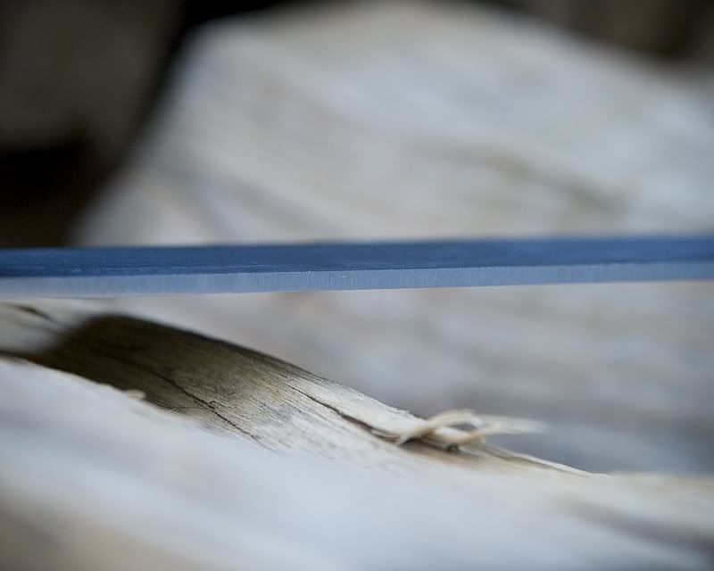

Same stuff as before. Square spine:
Rounded top edge near the end.
Convex everywhere.

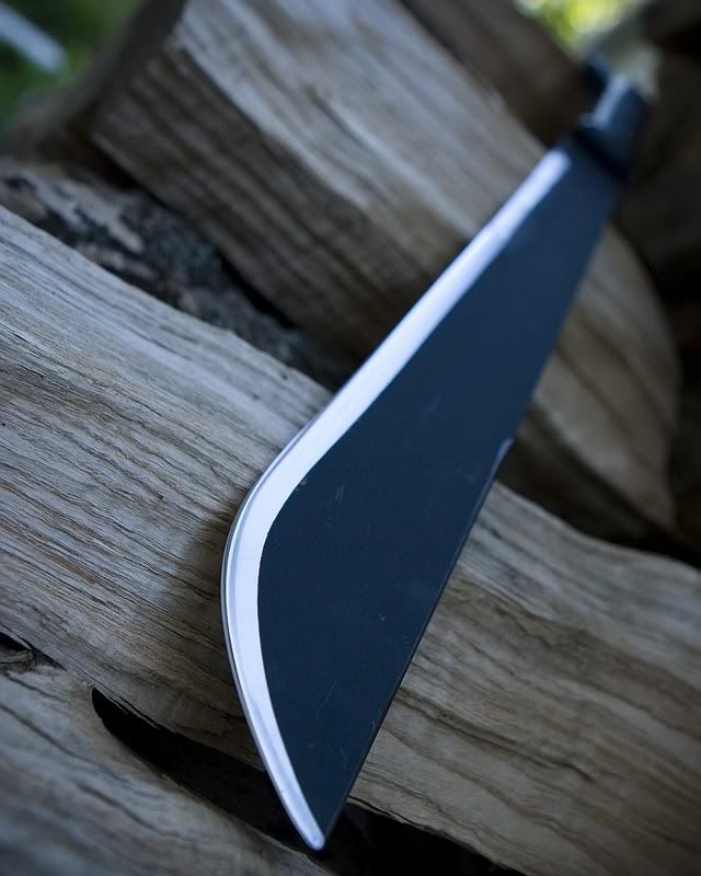

Finally, the scandi grind. I made it 5" long on this version.
I was playing with it in my little yard, but I would like to get the two versions out together for a good comparision.

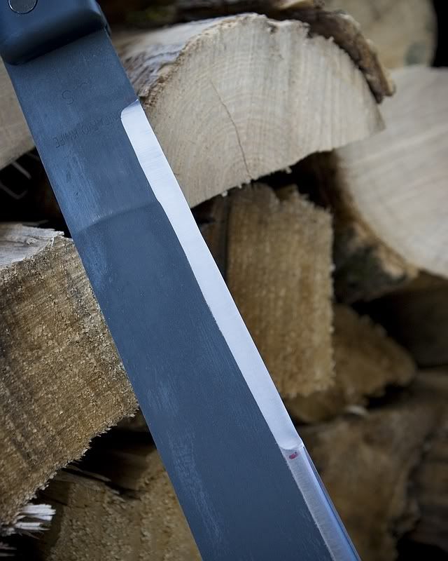

i asked this last time buti dont think i phraised the question properly. what causes the change in blade coating about 4 inches from the handle? it was the same pattern on the last one, so is it a result of somthing you did or is it just how ontario makes them?
Another really nice job. You don't have to stop posting the pictures, it is good to see what other folks are doing. Let us know how the 12" and 18" compare. I was thinking of getting the 18" machete.
It is a combination of both. The primary grind that Ontario puts on these is a full flat grind. But, you can see the line where that flat grind stops. When I come in and do a grind with a consistent angle (like the scandi) the part where there is no grind (by Ontario) causes the grind to go deeper in to the metal.
I am not sure if that made sense the way I explained it or not.
On this military version, the blade is plenty long enough that I could have pushed the scandi grind out futher, and kept it even. However, due to the length and balance of this thing, I thought it important to keep the "knife" section as close to the handle as possible. Everything is a trade off, I guess.
Either way, the grind is so sharp, and so narrow (the angle I sharpened at) that you don't really feel any difference when transitioning from one area to the other.
