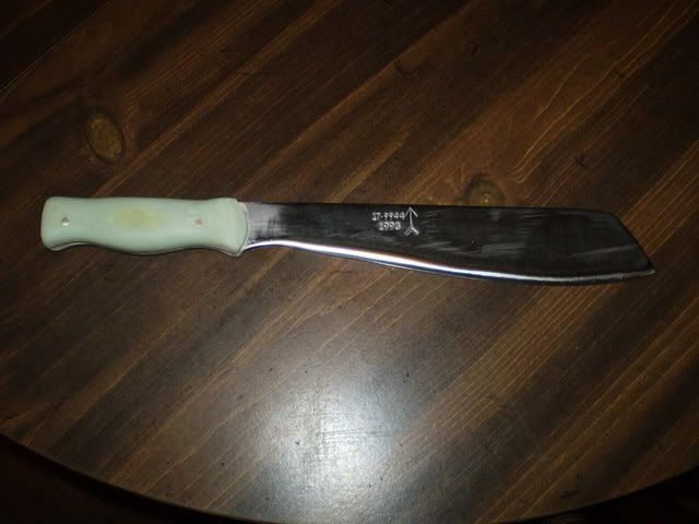

I've done a little playing with those Martindale Goloks.
Like Fiddleback I have done a couple of Goloks myself. Funny, we did the same mods. I like gaining the extra edge. Only have pics of the last one I did. Jade g-10 scales. BTW , it was a serious user before I got a hold of it.

Now that is cool guys. Those martindales look like the tang goes all the way through the handle (obviously on Andy's). It does not look like the new ones are that way. It looks like it stops 3/4 the way through. It could just be what it looks like in the picture though.
My Golok is new and is a full width tang that it extends a full 4 inches into the handle.
The tang does not extend the full length but i think it is long enough, it ends about an 1/8th of an inch before the lanyard hole.
So the last 1.25 inches is just wood.
So 4 inches of the 5 and 1/4 inch handle is full width tang.
The tang is also 6/32 ths thick in the handle!
Maybe Fiddleback and Bladefrienzy can measure their Golok tangs so we can compare the new models versus the old?
To my eyes theirs could possibly be the same length but it is hard to tell because they have reshaped the tangs and eliminated the last 1.25 inch overhang to the rear.
But of course i could be wrong on that.
Either way their rehandling jobs turned out nicely!
:thumbup:
On my Golok there is a good 1.25 inches between the end of the cutting edge and the beginning of the wood handle.
Lots of space there if you rehandle it to extend the grip further towards the edge.

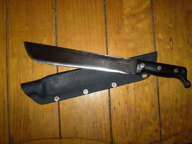

I like modified machetes. I have a Kabar cutless that I stripped, knocked the shoulder of their hollow grind down a bit, and put a utility convex edge on it. It chops like mad. It's about 12". I just started to mod an ontario mil 18". I cut about 2" off the end, convexed it and put a very slight recurve on the blade. I am going to do the handle next.
Fun to make things your own.
I've got 3 more in the basement that I haven't done anything with yet. No handle on any of them. May already have modded the thing. It wouldn't matter. I reground the shape of the handle and moved it up to where the edge starts. Plenty of room for gripping. Prettyeasy to do a stopped handle too. C'mon Brian, give it a shot!
Ditto for me too, just move the scales forward a bit. Then ground the edge up much closer to the scales. Thanks for the compliments. You could sand a pice of whatever you used for the scales to fill the gap or just move em up like we did.
