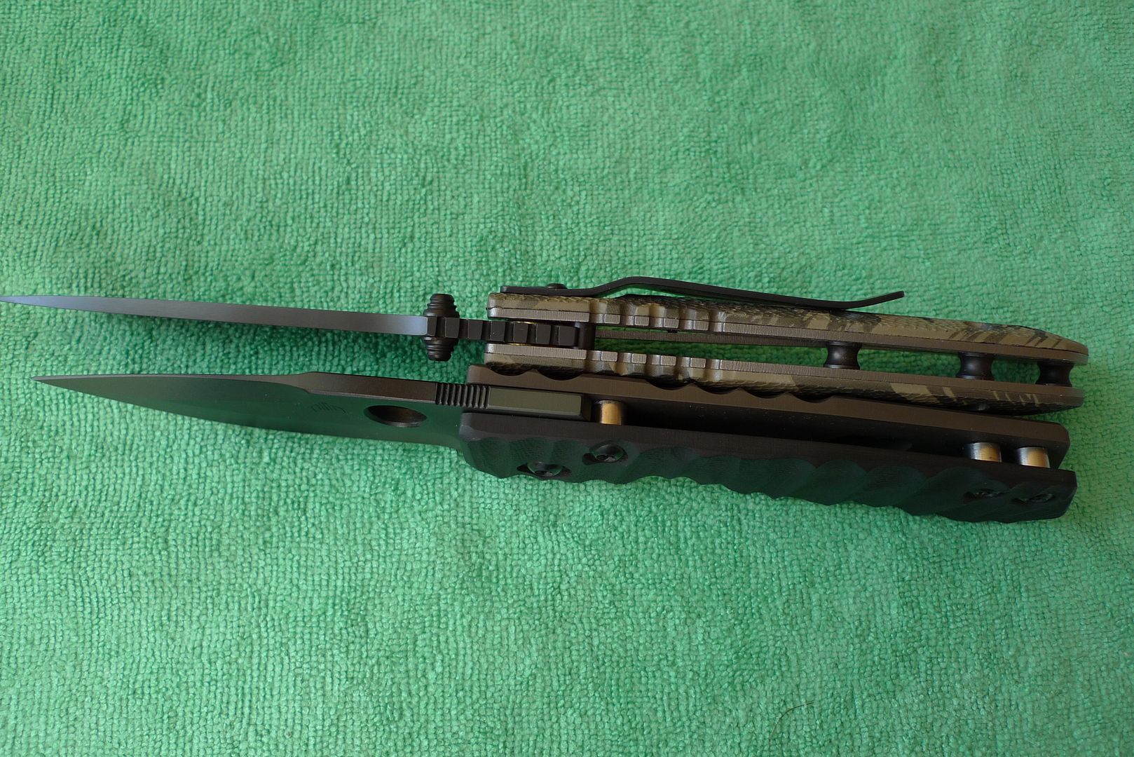

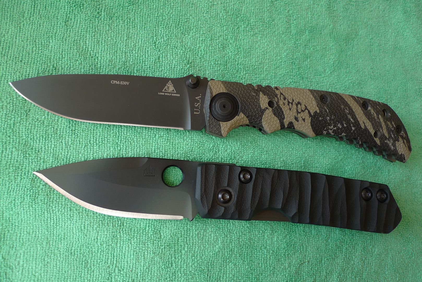

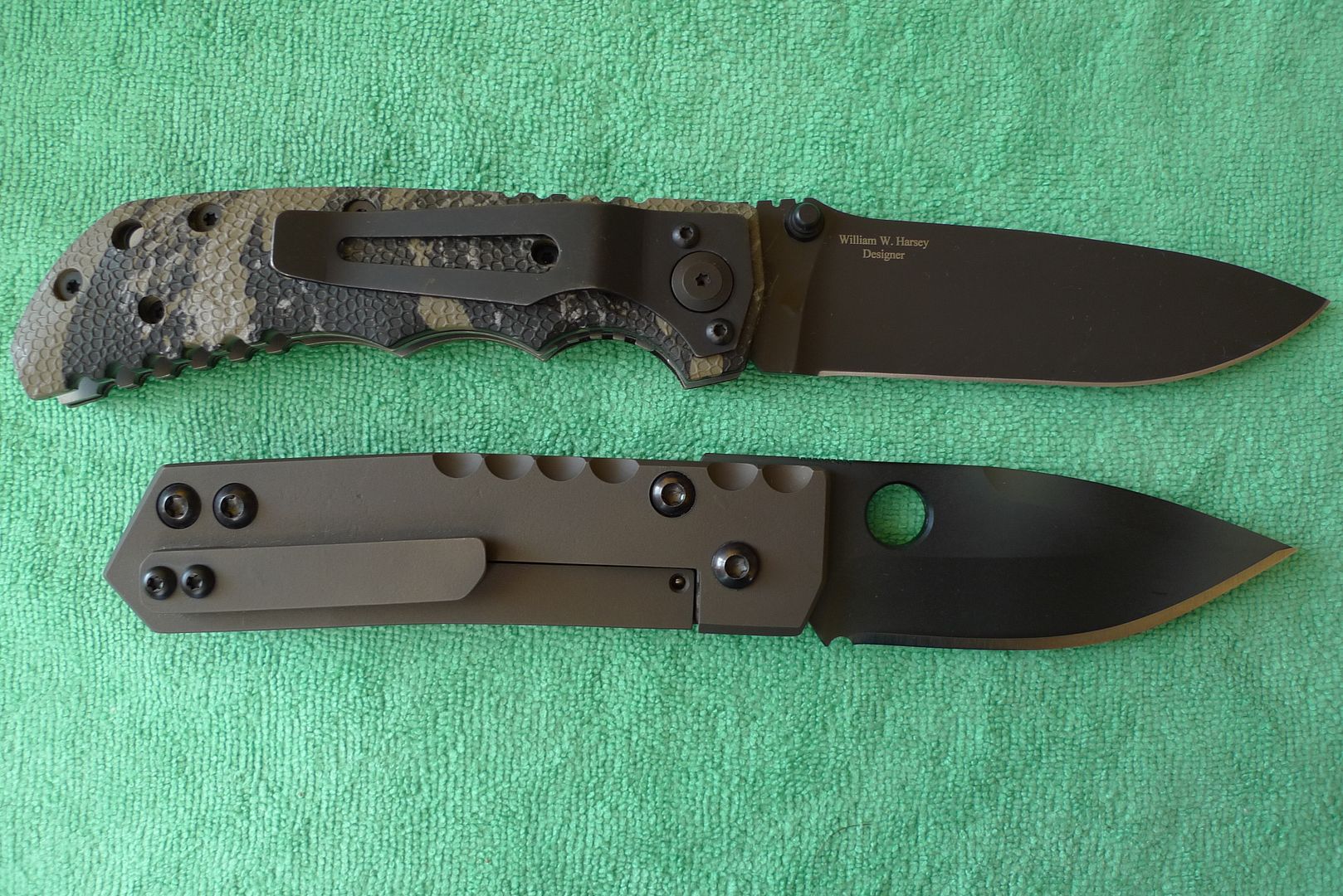

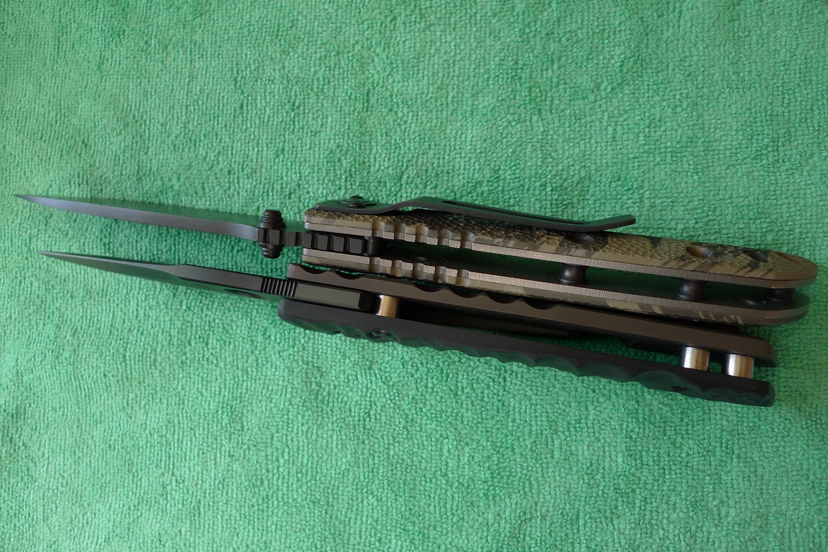

Funny I asked myself the same question and this is what I came up with. Top one is Harsey T3, 10.5"OAL with a 5" blade and the bottom one is a Crusader Forge FIFP Metro Spear Point 9.75"OAL with a 4" blade. These folders are treading on fixed blade territory.
