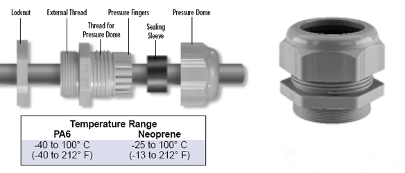

You will need 3x cable glands for a 1/2" NPT hole - also available at Home depot
wire to the vfd 14 gauge stranded 3 wires, wire between vfd and motor 14 or 16 gauge stranded 4 wires.
