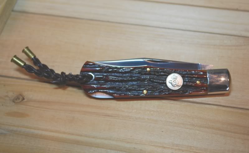

The one on the left will be hard to find... only 23 of those made with Burnt Stag. The two on the right are the bone models. The second most to the right is Red Wine Jig Bone and there are about 73 of those out there in total. Only 5 of the Burnt Grizzly Cut Bone on the right were made.
Wouldn't be complete without the Queen/Winchesters in a Single blade and Trapper
Almost forgot these...but no assistance from me , just pictures.................
