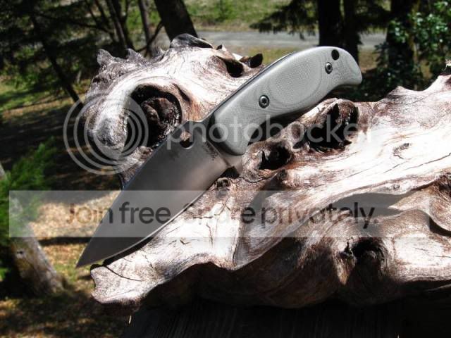

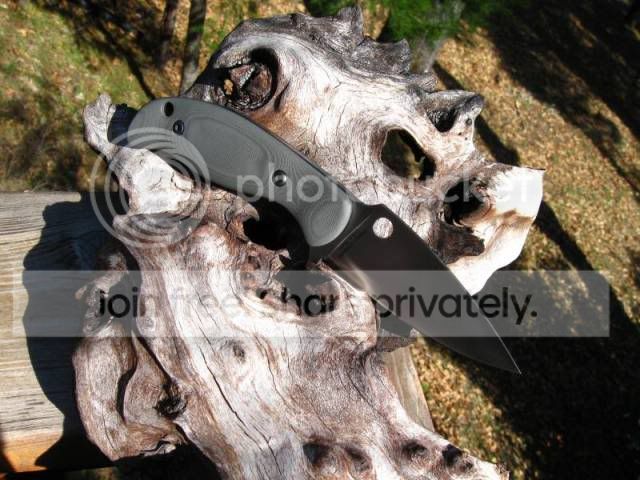

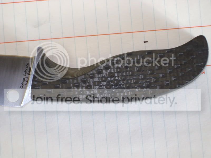

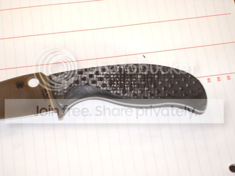

Here is an M4 Mule with matte ~.190" CF and .060" black liners. Nice beefy handle.
Hunter Orange coarse peel ply, coin slot bolts and GITD highlights
This is actually a 52100 mule, but thought I'd post it in here anyway, since I just finished it. Material is Rams Horn, black G10 liners.

Other than the coin slot screws (#12-24, by the way), I use #6-32 button head Torx drive screws. I start with either 1/4" or 3/8" long, then cut them to length. They screw into 3/16" OD SS threaded spacers that are between 3/16" and .300" long, depending on scale thickness. If you want more detail, feel free to email me.

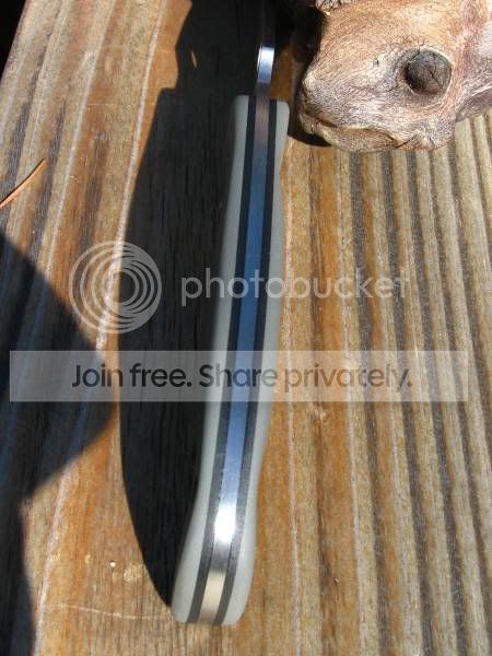

Mikes pics of the Mule he just finished up for me. Slate gray G10 with black liners. Fantastic!
