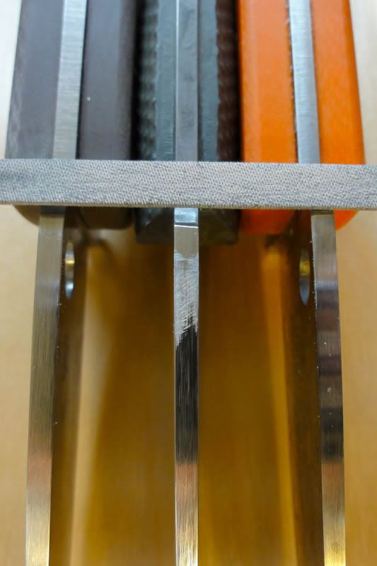

Naive question here - isn't it possible to quickly check if a blade is sharpened by using a sharp/new file? From what I remember reading, the file is harder than non-hardened steel, so if the steel is not hardened, the file will easily "eat" or bite into the steel. If however the blade is hardened, the file will simply skip over - a file can't cut/bite too much (or at all) on hardened steel. Maybe checking on the back of the mule would be a quick test to see if the blade is hardened?
Will
As in my post above, I had noticed the MT12 Cruwear Mule seemed a little soft. I did the "file test" comparing it to the Aogami Superblue and M390 mules and there was a marked difference:
M390 Left; Cruwear Middle; Aogami Superblue Right.

xavierdoc - I got two MT12 blades, and I have only tested the first one so far, but pretty much you got the same results that I got. I tried a sharp file on 3-4 places in the MT12, and it was easy for the file to eat metal away. I then put some halpern titanium handles, and proceeded to sharpen the edge with a mouse pad and sandpaper to start giving the blade the convex grind that I like, and to my surprise I found it was very, very easy to sharpen, even though the sandpaper sheet was not new. I would have expected sharpening the Cruwear to be a lot more difficult/time consuming, based on my recent experience with my MT9 and my PM2 with CTS-20CP, which take a great edge, but take some time to sharpen.
