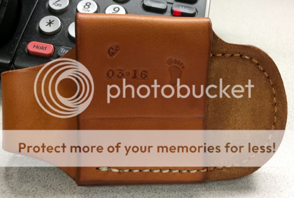

A recent sheath I made for my Swiss Army Tool, hefty multi-tool at 9 oz so it's not a light thing to tote around, the sheath is made for horizontal carry on the right side.
I used a Tandy Leather concho as the top of the snap, had to grind down a small screw in order for it to fit onto the snap base on the sheath, inside is a layer of leather to prevent scratching the side of the Swiss Army Tool, very snug fit but since the tool does not have any contours, a flap closure was in order.
SA_Tool.jpg~original
The back side, the second layer below the top section forms the belt loop, runs the full length of the sheath, providing added regidity to the sheath.
SAT_back.jpg~original
Entrance, here you can see how the top section is glued down to the middle section and those two are then glued to the back piece that becomes the belt loop, makes a bit to hand sew through, but it's one tuff sheath :)
SAT_end.jpg~original
SAK_tool_sheath.jpg~original
Takes a while to form down around that end of the sheath! Wickett & Craig leather, good stuff :)

Some have asked what the foot print is all about, well it's something I started years ago, meant as a reminder for you that when you go to put the sheath on your belt to always start out on your right foot in all you set out to do that day, corny I know, but that's me. One fellow emailed me asking about that foot print, I told him that I was sorry, the sheath had fallen to the floor while I was working on it and I accidently stepped on it as I went to pick it up ;)
And the other markings on the back, G2 is me, GG Gary Graley, nic name a boss had given me years ago that stuck, G-squared.
The date, month and year, another short tale about that, years ago, wow 16 years ago! I made a Sebenza sheath for a fellow, he wanted to call me when his knife and sheath arrived as he opened the box up. I said sure if you want to, so he called when the package arrived, loved the sheath and a friend of his was with him and I could hear him in the background commenting that WOW $5 for the sheath? and the guy told him "no idiot, that's the DATE, 5-00, May 2000 and why would he stamp the price on the back of the sheath?" that just killed me lol
