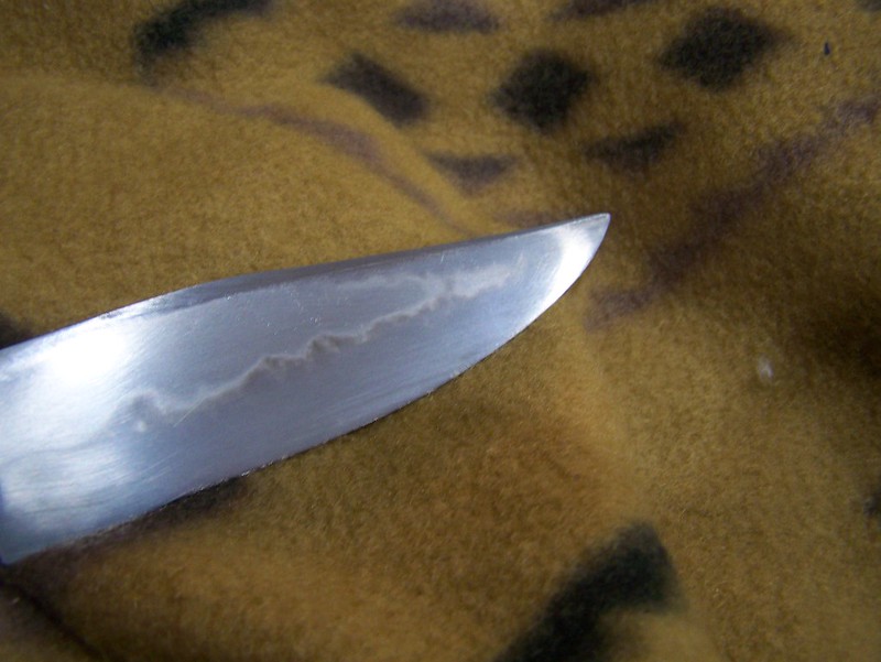

This probably isnt the best example of a good hardening line but is right out of the FeCl diluted with distilled water. 3:1... only a light scrub with 0000 steel wool was done. On my edc blades I go for a fully hardened blade as opposed to a differential hardening. Much polishing left to do. BTW, it is important to measure and mix precise quantities of this stuff. You want it to be repeatable, and know what effects adjustments made on the final product.

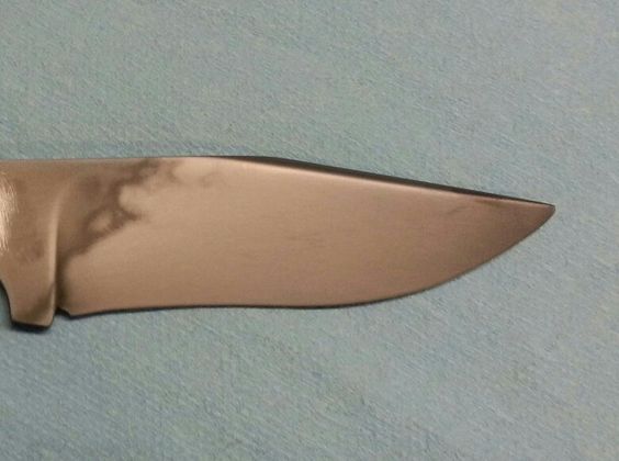

I don't do a lot of hamons so I cant give you a step by step, but I have been shown several times by a couple of others. One of the repeating themes was a little bit of etch followed by a lot of polishing. Then a little bit more etch followed by even more polishing. This seems to bring out the most detail as it allows the hamon to develop while carefully watched by the maker. A quick and aggressive etch was exactly what was being avoided. It was described to me like this.... Take two sugar cubes. Drop one in a clear glass of cold water. Drop the second into a clear glass of hot water. Then watch how they dissolve. The sugar cube in cold water dissolves slowly and evenly. The hot water eats away quickly and chunks begin to come off, not very even at all. Hot water is your strong acid, cold water your diluted acid.
The end product was a stunning line with ghostly wisps, dark and light contrast, etc.

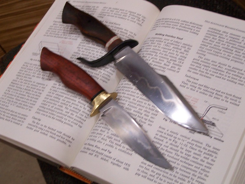

This was accidental in 15N20 at 400g with a light vinegar etch to get a bit of contrast:
The larger knife is 1095, and the activity didn't show in my lousy pics, but both of these knives showed a lot of potential by the tim ethey got to 400g. If its there it will show early in the sanding.
