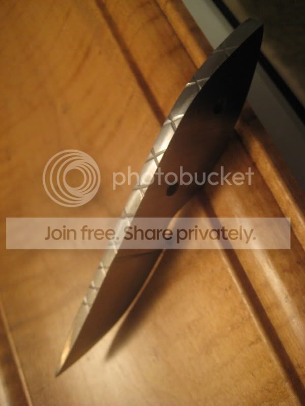

Thanks for all the ideas everyone. I'll be making a couple small purchases this week. As far as the grinder goes, last year at a blacksmith's meet a good friend of mine bought a whole box of diff. sized wheels (had to be 20 to 30 of them) to build one for himself and he says come over and take it, take what I need and bring the rest back. I'm getting excited now. That, and my father just brought me back the knife pictured above all polished up so I can start on the handle. I'm going to say that we all probably get a taste of what a crack addict feels like when we get into this stuff. Am I wrong? Mark.
