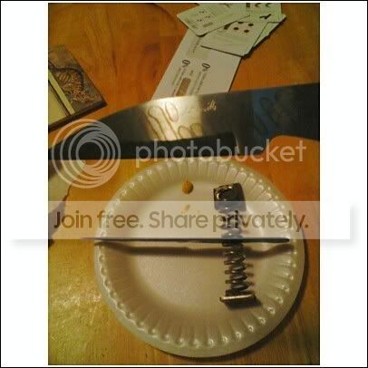

guys, i am at that point on my first blade where i am ready to put a patina on it. what are the steps for the mustard patina? just spread on some frenches? Bruce Bump helped me with the heat treat, it's a 5160 copy of a benchmade resistor. i'll see what i can do for pics.

anyway, here's what i'm starting with...
and this is what happens when you upset your hand model...

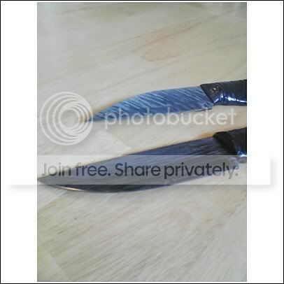

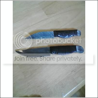

I have been playing with this recently as well.Get one of those yellow picnic style mustard bottles from walmart,the kind with a small squeeze spout.I also "cut" the mustard with a little more vinegar.Gibsonfan is right about the viscocity thing dont use too much vinegar.Here is some pics the first one is after the fist application tha last two are after about 7 or 8
J. Marsillo, that looks a LOT better than the painted on stripes you sometimes see. Nice work!

I'm not sure on the durability but I'm gonna put the wharncliffe to the test as soon as I finish sharpening.
GibsonFan if you use some kind of resist like electrical tape? or nail polish you just might be able to get some cool patterns try alternating between mustard and cold blue,even with the squeeze bottle I got some real small lines of mustard out.
