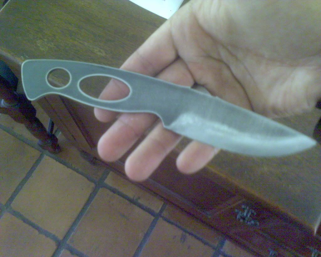

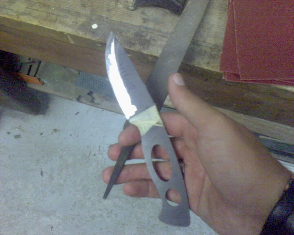

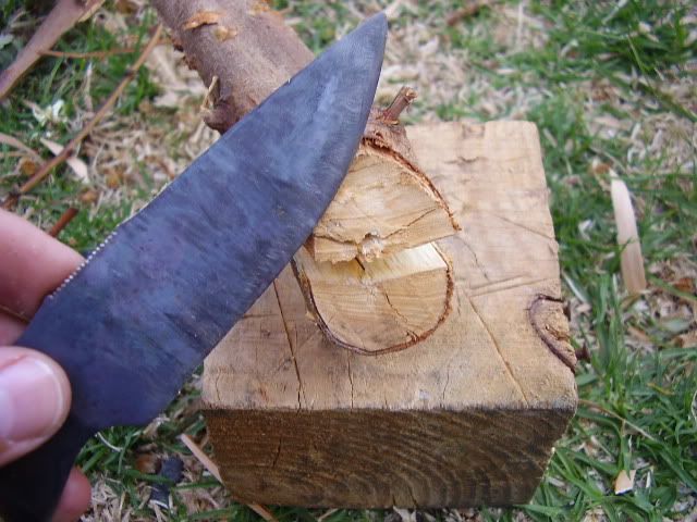

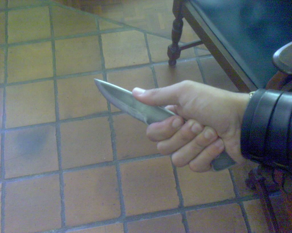

Well. Here is my attempt. I picked up some 12c27 a while back, been fiddling with it for some time. I dont have the right tools so I used a steel file on a black cut out. I later used a drill press with a round polishing attachment (a very old and mucky one) that I glued on some cardboard and on that some 80 grit paper. I then just went ahead and made some attempts at a scandi grind. Here are some pics.
In short having no means of proper heat treat the steel was to soft. It kept on folding.
Well....

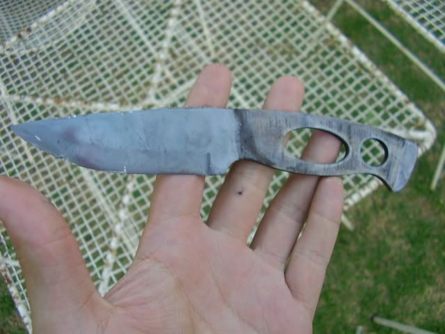

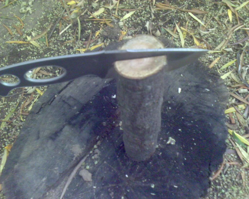

Still no proper means of heat treat I decided to give it a shot. 3 HT processes. 1 was heat treat (dont know to what degrees) quench in oil. Second HT (dont know degrees) quench in oil. The last HT and cool down. Well. Here is that result.
My work is bad I know but it has been fun! Here are some thoughts.

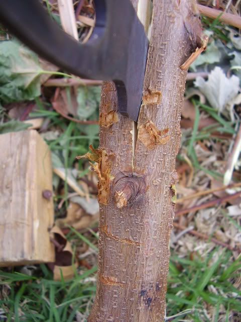

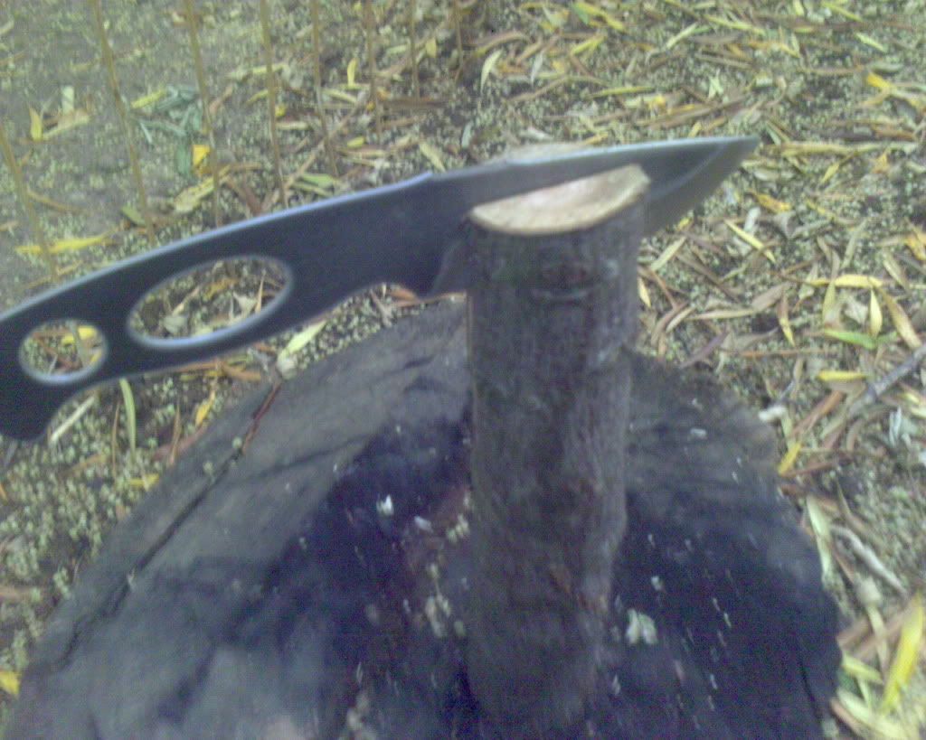

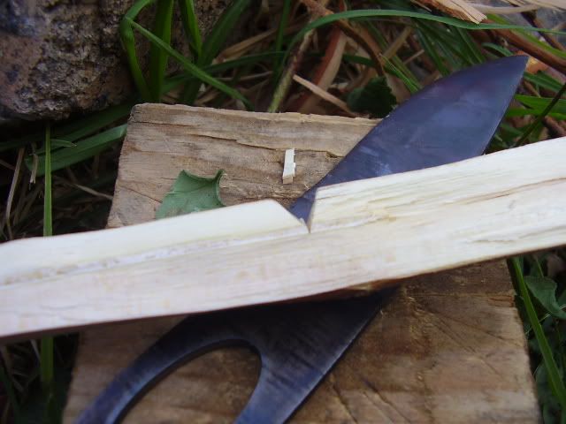

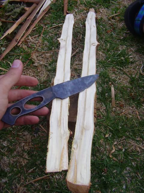

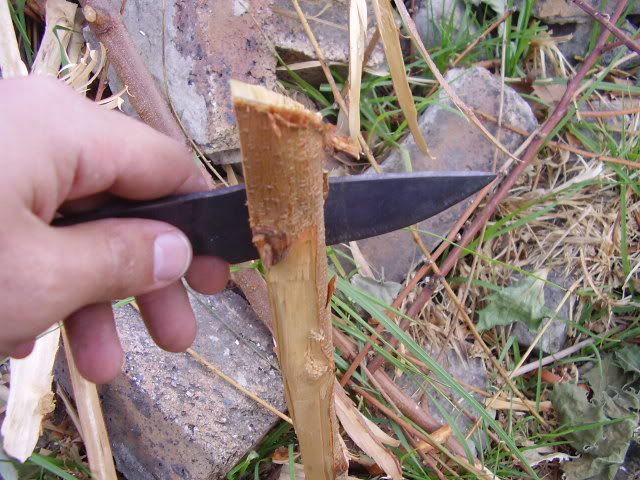

The edge is not as soft. Previously as I hit knots in the wood like shown above the blade started folding BADLY!!!!! Now it is not an issue. The knife will not hold an edge as well as 1095 or pretty much anything with higher carbon, but it is ok for playing around with and that is why I made it. All and all it cost me about $20 to get it to the point it is now. I dont know what I will do with the handle yet but that is not an issue now.
I really like this size of this knife. I can use it as a backup knife to a decent fixed blade where I dont want to screw up the edge or something while practicing fire starting or batoning. I think this will be ideal to fit in my small ammo bag I use to carry my fire starting kit, flashlight and what else in. The edge is still not where I want it and whitling is still a problem for me using this knife. Of course something like an ESEE RC3 will outperform this by far.

Sweet design. May be worth cranking out a few and sending in a batch to be professionally heat treated. 12C27 isn't a bad steel for smaller slicers like that.
I really like the overall look, especially the blade shape. The size looks ideal for most outdoor needs (in my experience). I'm not gonna get into technical details regarding the HT, I'll leave that to professionals. Not as easy, especially without proper equipment.With that in mind, I think you did a good job. Two thumbs up for the try and for shearing with us.

WOW! Thanks for the link! That is really informative and helpful! Seems one can use oil, but I did not reach the correct temp for that! Reading that I think the knife is somewhere described as:
Too low cooling rate after austenitising gives carbide precipitations in the grain boundaries. Result: Brittleness and reduced corrosion resistance.
The handle seems to get surface rust easily and I do not think the hardness is all that great (compared to what it can be), would be interesting to test it one day when I get to someone with such a Rockwell machine.

Here is a video of the knife in use on redwood as well as the machete I recently got. The wedge that the knife creates helped a lot to split the wood.
Generally I do not like batoning, but the more I do it....the more I am starting to enjoy it.
