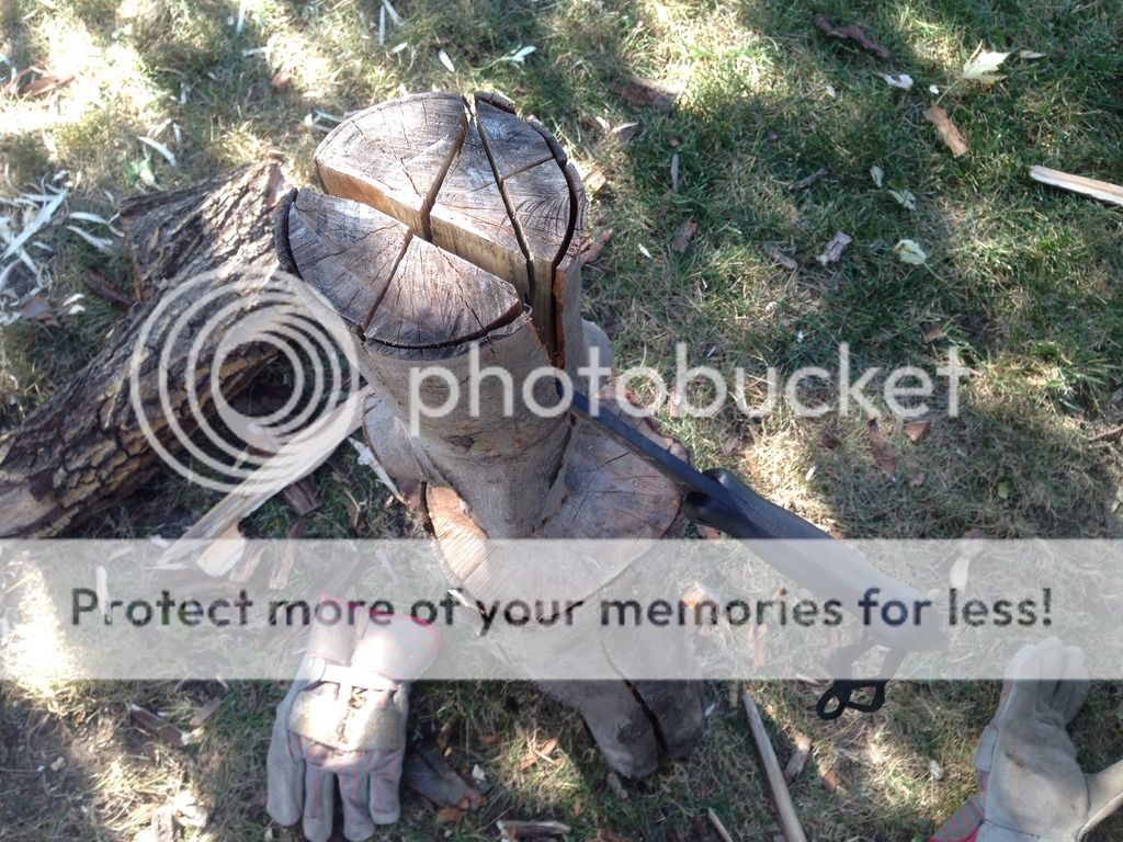

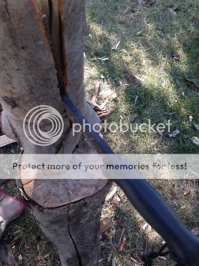

Hey guys,
while I was taking my camping/survival knives out for some playtime (in the backyard, thank God, not depending on it for real!) and I decided that my bk2 was still way too pretty.
And while using the 2 to 3 inches near the point in a seasoned log to split it, as it could not fully span its width, I used a 2 1/2 inch diameter baton on the 2 inches of the spine near the hilt, being extremely careful NOT to hit the scales. Here are the gut twisting results.
Now, call me a newbie, dummy, ignorant, or whatever, but I don't think it should've broke there. I don't think it should have broken at all given its reputation.
I'm waiting for uncle Ethan to weigh in on it.
I've already sent an email to Ka-bar's customer service, I'm really hoping they don't tell me that I was "abusing" the blade, again going back to its "Buick skinning" reputation. No kidding, as I am batoning kindling with my Bk2, I'm thinking, "Even if my RTAK II or Bk9 bends or twists, I can always count on my Bk2 to function like the sharpened pry-bar that it is".
If the BK2 is not supposed to be used for woodworking, delimbing, and light batoning, then it's an extremely expensive and chunky salami slicer.
What do you guys think?
Will Ka-Bar/BK&T take care of this, or is this an expensive lesson for me? 😓

Edit: just saw your last pics. Well, I wouldn't baton any knife through a piece of wood where 3-4 branches come together and create one massive knot. Definitely not when it's seasoned. I applaud you for trying though, that's another reminder for me why not to do that in a similar situation :D
Well, I wouldn't have attempted anything that I thought was abuse (and as for batoning being abuse, i've seen Ethan Becker use his BK4 for kindling on YouTube).
In the years that I've had it, today was literally the second time I was using it for making kindling.
Also, it wasn't as if the blade snapped off inside the log with me holding the handle, it's simply cracked underneath the scales.
Nowhere near where any of the downward pressure was being applied. Like I said in my OP, if they refuse to help/consider making it right, then I'll know that the bk2 is little more than an overpriced, overbuilt, and overhyped whittling knife...

Ugh....sorry bro. I've always been told NEVER baton on the handle side period. Always on the tip side of the log...

Uuuuugh! No one EVER told me that!! I figured because I steered clear of, and never directly contacted the hilt/scale area that it would be fine, the wood would give, and my knife would look all the cooler for the scuffing.

I really haven't researched this, but IIRC the BK2 tang was solid at one time and then in order to lighten the knife, Ka-Bar began milling it. The problem the OP encountered as well as the ones I referenced above didn't start happening until after Ka-Bar started milling the tang. I'm not sure if that's just a coincidence. But the first time a BK-2 fractured, I wondered whether milling the tang introduced a weak spot in it. I'm no expert, so that's mere speculation on my part. But one thing is certain. Those fractures aren't speculation. They happened. And they all happened at the same place.

I just watched one this morning long before seeing this post and I noticed he kept it to the outside perimeter of the log, never thru the middle, and even made a note of never going thru knots and he would use some other instrument if that was the case.
I'm really not trying to be against you and I hope they hook you up. It's just that I hope you understand if you don't get your way. Some of your comments lead towards a notion that if you get it replaced, its still an awesome Blade, if they don't then its a hunk of crap. It's the same piece of steel either way .
I'm not sure if it would have busted if it wasn't skeletonized and this could lend favorable to that argument. But, maybe it would...I believe that part is on the edge o the heat treat, though I'm no expert and could be wrong.
