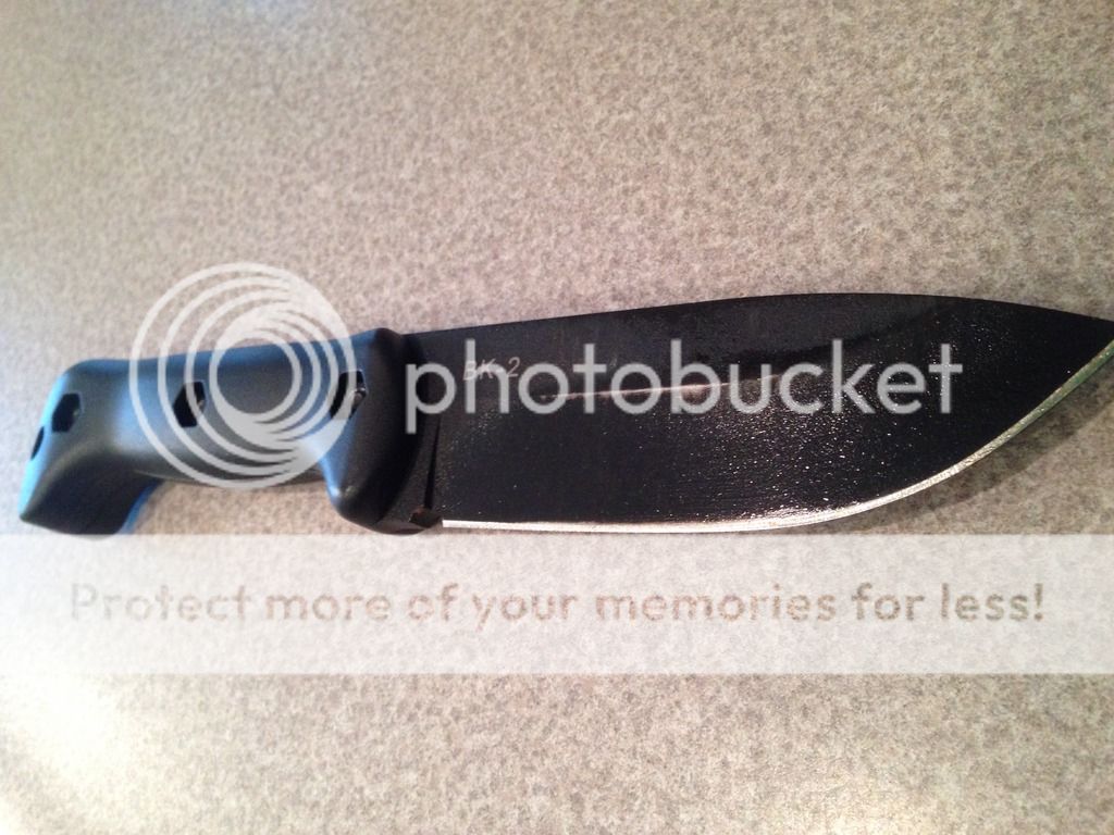

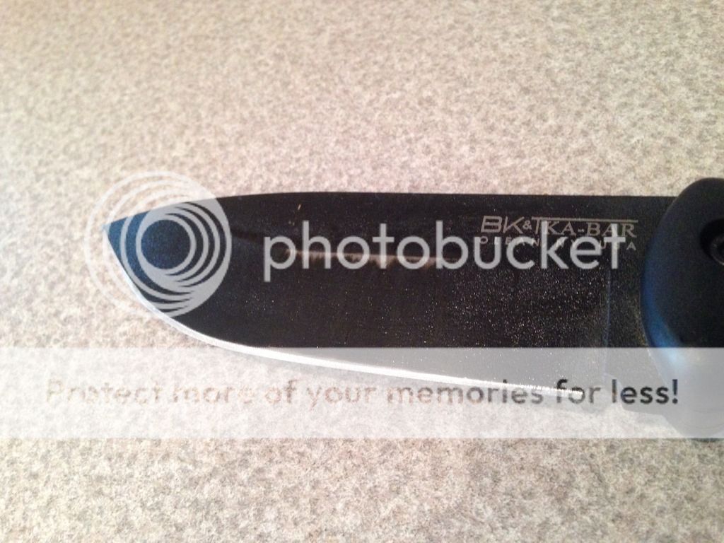

My bk2 broke under the scales!! WTH!
the flaw was likely the heat treat for the transition zone.
No, the flaw is that long things with many holes and/or steps in them have demonstrated they are more likely to break than short things with fewer holes and/or steps in them... Long things have a greater amplitude of vibration, and that is dangerous with batoning since the steel is trapped between two vibration-damping objects, and so is not free to vibrate... I'll concede a fully non-skeletonized solid tang probably would have held, but then that 5" knife would be 20 ounces...

I understand that you don't particularly like the BK2. And if I'm completely honest, I'm not a huge fan of it either. Now that I've become familiar more with what my preferences are, and have picked up more skills/familiarity with knives, I find it severely overbuilt (at least for my uses). The BK9 that I tend to carry weighs almost the same, and has more usefulness (for me), and is very similar in size/weight to the Randall that you use (IIRC).
However, to simply state that it is a design flaw, and discount the inherent randomness of flaws in materials/HT is a bit strange. If this was a design flaw, then EVERY BK2 used like this would break the same way. Clearly this is not the case, as myself, and numerous others have used ours far beyond what broke that BK2. Then of course, there is Ethans response, which points out that it is rare, but has happened. And it is nice to see that when things like this do happen, that the warranty (and owner) make things right.
Hey JT.....
...... Should not have happened....... It did happen, sorry about the problem and sorry that it took me so long to respond...... Should not have gone to bed without checking in......
Thank you for getting in touch with KaBar by email and thank you for the clear photos ....... Not much doubt that there was a transition zone fracture....... T'is rare but it has happened before....... It has been Ka-Bar practice to leave the tangs soft so that the tang will bend before blade failure........ Almost always works out.......

We will fix it.....

My first Becker was a BK2 that I purchased three months ago. I used it one time to remove some 2 inch branches, and was satisfied - except for the finish. When I removed the finish, I discovered a hair-line crack exactly where the breaks are showing up - the crack is only on the top portion of the blade. I wonder how many other cracks are covered up by the thick black finish ?? Although it's still like new, I guess I'll eat it rather than fight the customer service / return ordeal. If I don't subject the knife to any abuse, it still should last longer than my old 70 yr old body will. Not too satisfied for sure.

I'm certainly not blaming anyone - especially Ethan ! I'm just disappointed that something that thick could crack/break with so little effort. After I did the finish removal, I did notice that the very rough finish on the entire perimeter of the blade - like saw cuts that were barely deburred. Just a simple step of polishing the .25 thick surfaces would go a long way to preventing crack propagation. I'll give customer service a call next week.
looks like you are one of the lucky winners chicken dinner of the rare bad heat treat
if so, they'll make it right. hard to ask for more.
My apologies to Becker. I put the "crack" under a 20x lens, and it blended in with the surrounding tool marks, but without the magnification it looks like a crack. I began polishing the suspect area to a smooth surface, and there is no evidence of a crack. What I was seeing was a deeper than normal grind mark that still retained some of the black finish. So, I'll continue polishing the entire thing, and then go crawl off into a hole. Thanks for the advice - I'm embarrassed.
