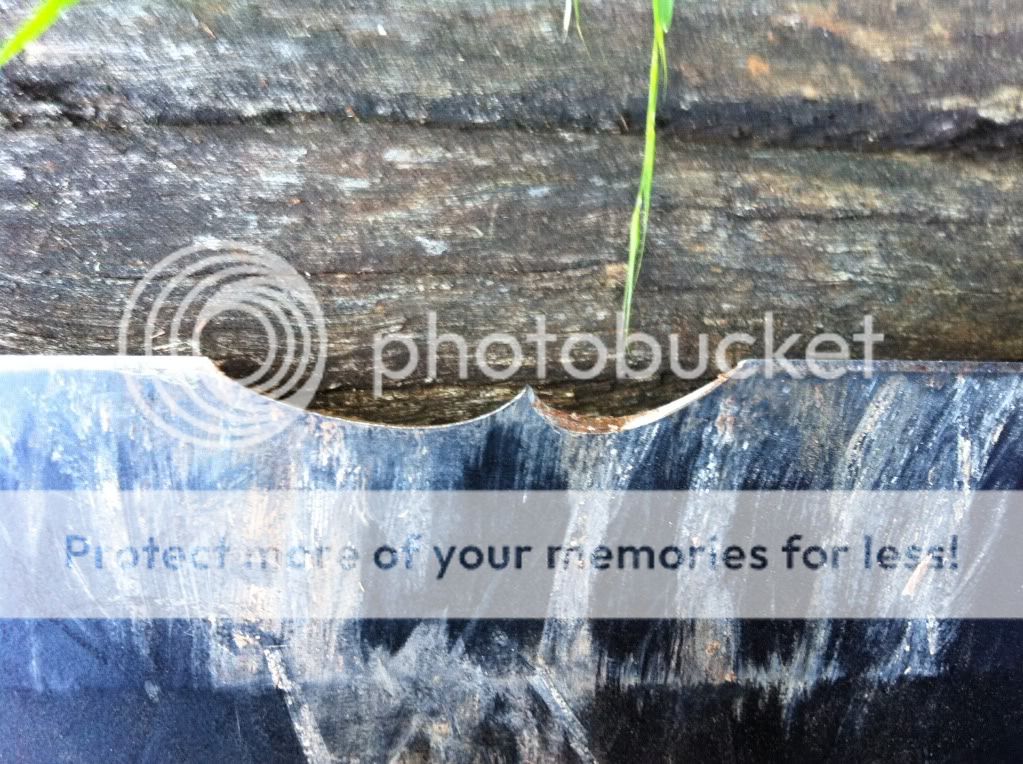

My BK9 Chipped Out...with pics
I think you've got a good grip on what happened mook. Glad you're here and thanks for the post. You just got a taste of why everybody loves these knives.
Well you are right, I probably didn't NEED to split the logs to get the fire started again. It's more that I just wanted to. I guess I just enjoy just the feel of my Beckers in my hand and take every opportunity to use them, and yes sometimes even MAKE opportunities to use them...just 'cause I like it. There probably are more specialized tools better suited to each particular outdoor task, but I like the idea of one tough tool that you know like the back of your hand, combined with good skills which can allow you to be sufficient at most if not all outdoors tasks. Guess I'm just lacking in the skills department. I do take your point and intend to be more selective of tasks in the future.

Mooks100,
Your post has not fallen on deaf ears. The break has most likely occurred because of a knot. It seems that knots are a place where some very hard mineral deposits tend to migrate. Some of these deposits have hardnesses in the ceramic hardness range. We have had posts in the past concerning them. A hard lesson learned. Having said all of this doesn't make your blade repair itself.

Mooks100,
Sorry for the second post but I wanted to get the replacement action moving and revisit for a better explaination on the fracture.
The Guyon is correct. You were attempting to baton around the curved section of the knot. Being wedged between a very hard (Harder than the steel) knot and a vice grip of slightly softer wood, the blade edge was trying to curve around the knot while the batoning motion was trying to drive the blade downward into the knot. Part of the blade went around the knot and the rest of the blade when straight. Note the angled frature face on the blade.
In Metalurgical terms: A lateral Stress fracture of a transcrystalline nature. In laymen's terms: It done broke!
Right now you are sadder but wiser. We will work to get rid of the saddness.

Those are some nasty chips that appear to have been caused my some hard chopping AND twisting. While this damage might surprise some, I am not shocked in the slightest. The BK 9 is a fine piece of cutlery and should work as a serviceable tool for many years. It is NOT an axe. Avail yourself of a Gilpin, Keech or better still a Trojan Blue...all available in your neck of the woods if you'll do your homework.
